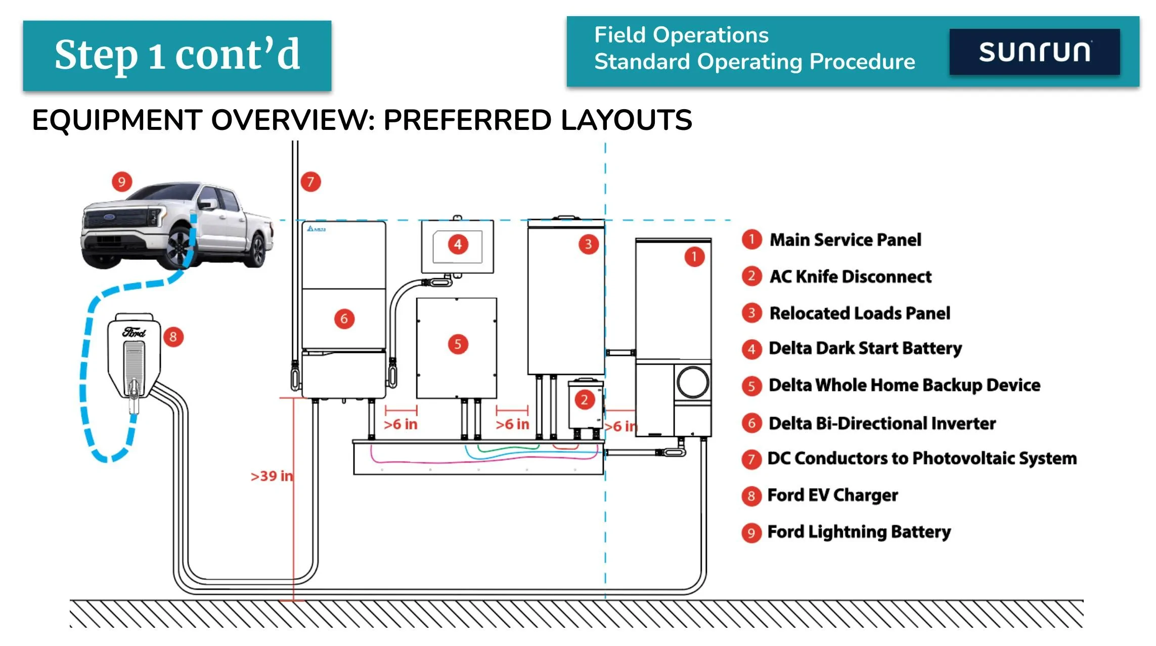

Finally got a detailed response from AEE:
  • When the grid is down, can it charge the truck from PV, and also send PV power (inverted) to the house?
    • It cannot charge the vehicle during an outage. The PV will go towards the backup loads, but the EV breaker is located in the Main Service Panel (MSP).
  • If it charges from PV, is it DC to DC with no inversion?
    • The PV is sent through the inverter back through the backup loads panel. Any excess will then go back to the MSP, which can then send it back to the charger.
  • How many strings and how much PV can it connect (assuming 3 and 10kW)?
    • The Inverter comes in 4 PV sizes (4, 6, 8, and 10K). It is a string inverter, so each string has to have modules facing the same direction.
  • Should I assume the Microgrid Integration Device connects to the mains running to a subpanel, and disconnects from the grid when it is down?
    • Yes
  • Does it comply with ISO 15118? VERIFYING--I will follow up with confirmation.
  • Where does the Ford Charge Station Pro connect in this solution (subpanel, BDI, MID)?
    • See the image below:
    • Ford F-150 Lightning Charge Station Pro and Home Integration System self-install his

I wonder if the truck has to stay constantly plugged in for the transfer switch to stay switched over to “off grid mode” and if not then can they PV system feed the “critical loads panel” when the truck is disconnected?
If the solar array could continue to supply the critical loads panel without the truck being plugged up, then one could install a 50 amp breaker in the critical loads panel and connect it to a NEMA 14-50 plug to be utilized for charging the truck during the day….
A battery is needed to form a constant voltage source for variable-voltage solar to sync to if a constant grid voltage is not present.

There are two batteries on the HIS system - a "dark start" battery which is required to power all the components of the system so they can safely and successfully transfer your home's load over to the truck's battery, and then there's the truck's battery that provides power to your home.
Grid-tie solar inverters must conform to UL 1741 safety specifications. This means shutting down when grid power disappears. PV systems without a battery do not cycle on or off - they remain off as long as the grid is off. Without a battery present, there's no buffer to handle the transient differences between production supply and demand and the voltage will fluctuate wildly. With a battery storage system (whether the Lightning or off-grid style charge controllers/battery/inverter), the battery can make up the difference if the demand is higher than the PV supply, and the charger (or excess load) can make up the difference if production exceeds demand.
The one exception I deal with frequently is the "emergency power" output on SMA inverters that is supplied only from solar PV only - it shuts down if the inverter can't supply enough power due to cloud cover or night.
With regard to your final question - if there's enough power, you *could* use the mobile connector to charge the truck with excess PV power, but it won't adjust to the loading. The truck will attempt to draw 30A through it constantly, and that's not what you want.
