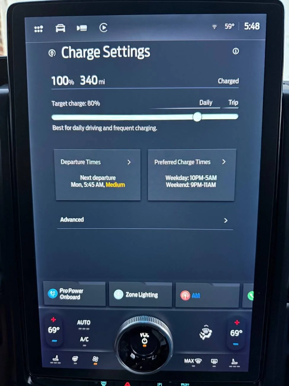

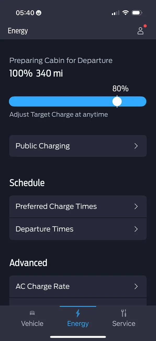

2025 F150 FLASH LIGHTNING 131kwh ER
I have set my target charge at 80%
i plugged-in last night to charge and woke up to 100% charge.
only thing i did different was to manually start the charging instead of the scheduled 10pm charge.
what’s going on?
Ford F-150 Lightning Charging process has a mind of its own IMG_5954
Ford F-150 Lightning Charging process has a mind of its own IMG_5955

probably because you 'manually' started a charge, which bypasses any 'setting' you have... is 100% 'not' good?

I guess one would have to ask 'why' you ask the question of "...not ideal to charge at..." ... Ford has never made any such requirement, or prohibition, nor does any battery not love to be 'fully' charged...
as to the question of charging 'timing', when you 'manually' start or stop a charge session, you are manually starting and stopping it - there is then, therefore, no step-in from any settings to stop or change that.
If, though, you want to start a charge BEFORE your normal set time, you can STOP that charge again before the set time, allow the set time to take over, and, yes, it will then stop at the setting's SOC setting.
Ford created this since they didn't want owners to have to go into settings and change or delete a 'normal' everyday setting simple to have a one-time charging session that is different from 'normal'.
If you start a charge manually, you'll have to stop it manually.
That's why you got 100%

I get what you are saying OP. Intuitively, the charge limit seems global, therefore if you start charging manually it would sill obey the 80% limit (or whatever you set).
As has been mentioned, it is simply a manual start and stop of charging. Most use it to do a one off 100% charge in anticipation of a longer trip.

Yeah, if you hit the "Start" button in the app, that means "charge to 100%". The UI is... not great.
