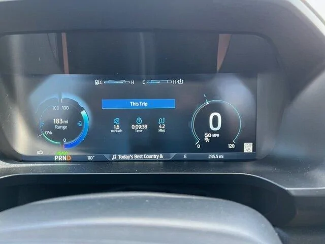

I can't seem to find another thread discussing charging in hot weather. I'm in the Phoenix area in AZ, we have been experiencing temps in excess of 110 for a couple of weeks and now they are in excess of 115 almost daily breaking records left and right. Today, the low temp in Phoenix was 97 degrees as an example.
My aftermarket EVSE(?) provides an internal temp when in use. The other night it peeked @ 55C (131F). Ambient in the garage was 46C (115F). I'm assuming the temp limits for most EVSEs of 122 is the ambient or environment temp not the temp of the unit since the unit completed the charge without issue.
My battery temp immediately after charging showed halfway between the center tick and the right side tick, so I'm assuming it was a bit warm. I will try and post a picture I took of my dash when gmail decides to deliver the one I sent myself. Update, picture attached.
Here's my question. Is it damaging to the truck battery to charge to say 70% with the kinds of temps I mentioned earlier in the post?
I'm new at this Lightning thing, only had the truck a couple of weeks, so any suggestions would be appreciated.

No harm to the trucks battery, it will regulate the core temp on its own.
Does your HOA (if you live in one) allow you to leave the garage door open overnight?

As long as the temp doesn't go over that ~75% line, there is no issue. The truck will run the cooling system to keep the battery cool when plugged in.
This is why, even if you aren't charging, you should leave the truck plugged in as Ford recommends.

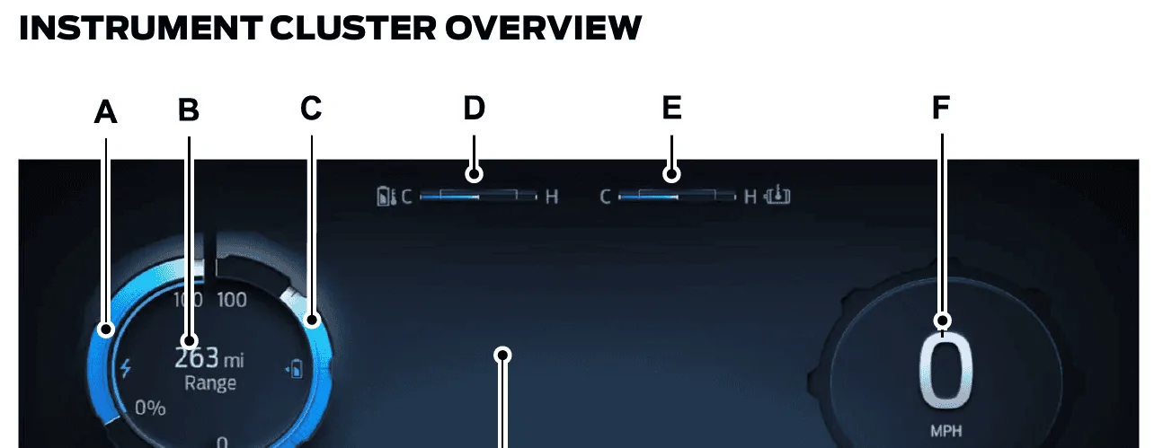

TIA for someone explaining how to read the battery temperature gauges. Ford doesn't give any explanation in the manual. Here's the illustration of the top part of the dash panel from the manual:
Ford F-150 Lightning Can The Lightning Cool Its Own Battery in Hot Weather When Not Plugged In? 1689811988393
I've been interpreting the bluish bar as a "capillary" scale, similar to a reddish-colored alcohol thermometer with the right end of the bar indicating relative temperature. I've interpreted the white brackets on each gauge as the acceptable temperature range - so the illustration shows the vehicle's battery and engine temperatures at "50%," right in the middle. But then, what does the white dot or bar just to the left of the H in each gauge mean? Just some graphic fillip? Or is the space between the right side bracket of the acceptable range and the dot or smaller bar to the left of each H intended to indicate the extreme, unacceptable "out-of-bounds" (shut down or cool the truck immediately!) very high-end temperature range? Again, no explanation from Ford on how to read the gauge, even in conjunction with the idiot lights on the dash that are supposed to come on when the temperatures are too high or too low.
Edit_Update (this paragraph): Just noticed there is also a dot or small bar on the left end of each scale near the C mark, too. Presumably, the space between this small bar and the left bracket on each scale is the "too cold" temperature reading area. Again, no explanation from Ford... and you have to squint like Hell while driving to read the scales. And the right, upper end of the blue capillary temperature-reading bar is white, too, so the white bar on the left end of the blue capillary display "disappears" in a bar that just appears to terminate in white on both ends.
I haven't let the truck sit out for a long time in any extreme weather yet, so I've never noticed the gauges in my truck noticeably depart from the ~50% range. Today I let the truck sit out for ~1 hour in the noonday sun while shopping at Costco. When starting up the truck, the gauges might have been closer to "75%," but kudos to Ford for designing a gauge that's small and hard to read, especially while driving the truck. Not a very "glanceable" set of gauges unless you have 20/10 vision and presbyopia correction to the max, for old geezers like me.

I’m up in Peoria and actually just got the truck back from the dealer for my 30k mile service and noted that exact same behavior on my truck. They ran full diagnostics and told me what others have said. That the truck is fine. The bars on the left and right of the gauge are the “acceptable range” of the battery temp and that it’s just stupid hot out here.
