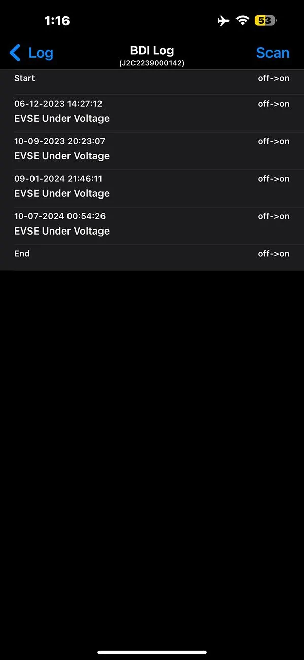

I checked to see if there was a Delta inverter system log. The best I could come up with is, when logged into my inverter via the M Professional app, go to Menu, Analysis, Log, EVSE Log, then hit the SCAN button (top right). Here's what I get:
Ford F-150 Lightning Class Action Lawsuit - Home Integration System IMG_1073
The first date, 6/12/2023, was the date the system was installed and rendered active by Sunrun. The 10/7/2023 date is the approximate date window that the 1.1.21 firmware self-installed based on my following post: https://www.f150lightningforum.com/...backup-power-without-sunrun.12564/post-342129. I bet 9/1/2024 was the date the inverter updated itself to firmware 1.1.33. And the date and time on 10/7/2024 is when I manually updated to 1.1.34. Would be nice to have info from Ford on what each update was supposed to do for the system...

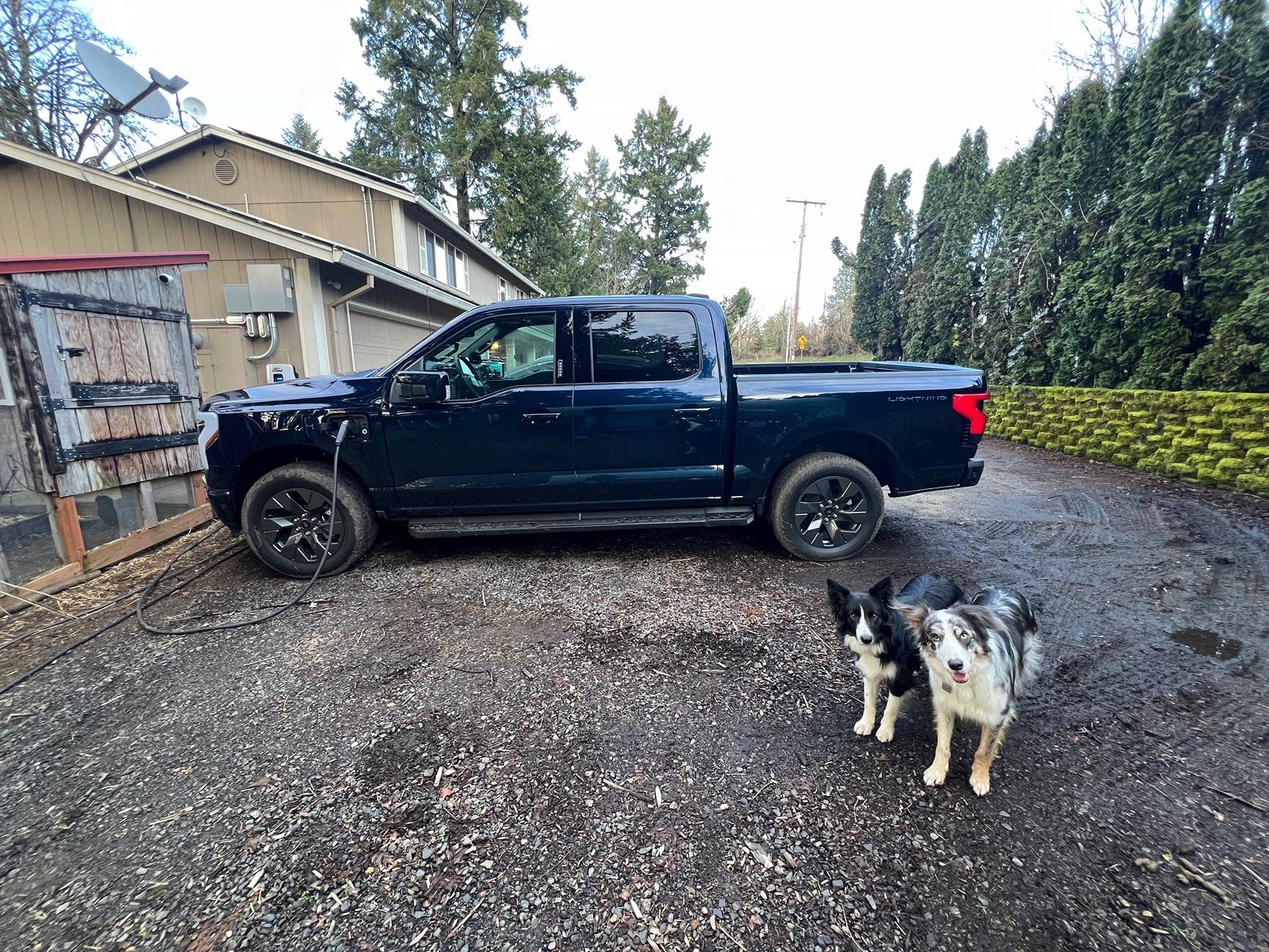

Yesterday, I did ANOTHER test of our HIS. Prior to this most recent round of updates, I had to park my Truck off to one side on some gravel next to our driveway, skewed at 45 degrees to our Chicken coop so that the HIS would actually talk to the truck.
Ford F-150 Lightning Class Action Lawsuit - Home Integration System IMG_5689
However, yesterday, I was able to plug the truck in while it was parked ON our driveway, and it worked 100%! This hopefully means the communications have been fixed betwixt charge station pro and truck.
(My wife fixing the chicken coop has nothing to do with this lol)
Ford F-150 Lightning Class Action Lawsuit - Home Integration System IMG_6768
We ran it for about an hour with no problems.
As with the last test we did, we noticed no dramatic changes in voltage while the test was running, with draw as loss as 1.6 kW and as high as 8 kW. The Delta team seem to have tweaked the tolerances for power supply, which should mean no more flickering lights when the pump house turns on one of our well pumps.
I also turned on the truck while it was powering the home and checked that it could still provide pro power. It could on all sockets (although I didn't put a high load test on)

Here's a hint that progress is crawling along, perhaps in an effort by Ford to finally get the HIS unit out of class action territory. Prompted by @Aminorjourney's post, I took a look at my long-ignored inverter via the M Professional app and just found another inverter firmware update. I had been at 1.1.21 since October 2023 and was surprised tonight to find I'd been updated to 1.1.33 since August 2024, with 1.1.34 available when I just checked tonight:

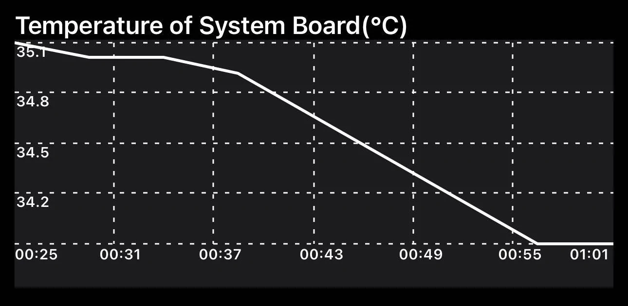

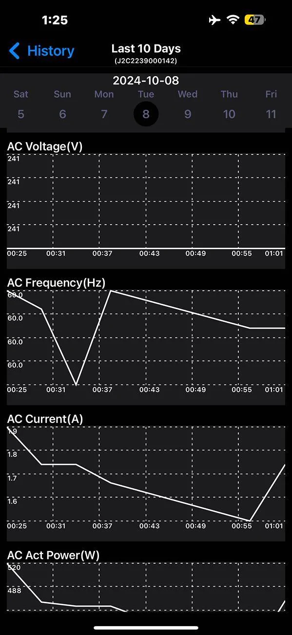

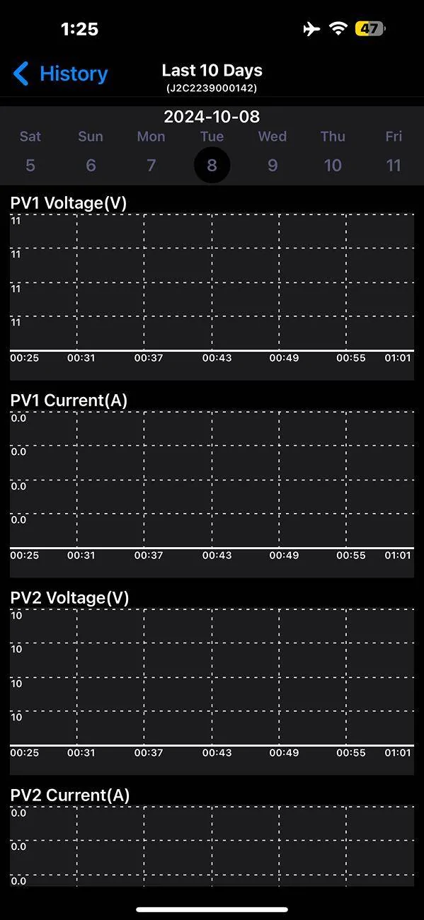

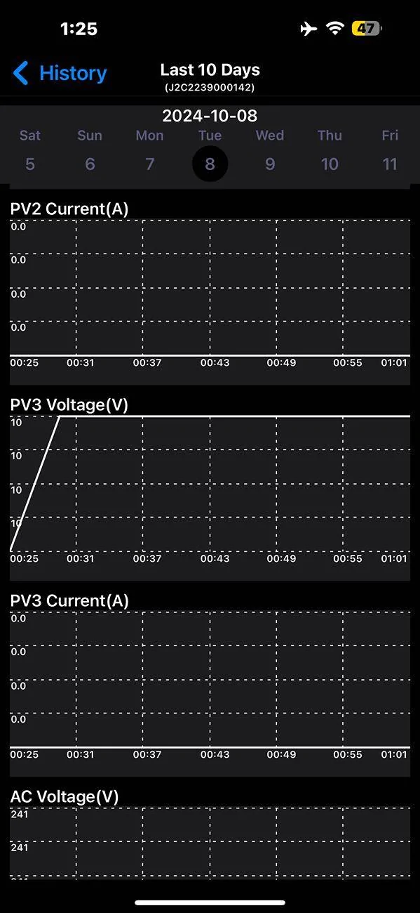

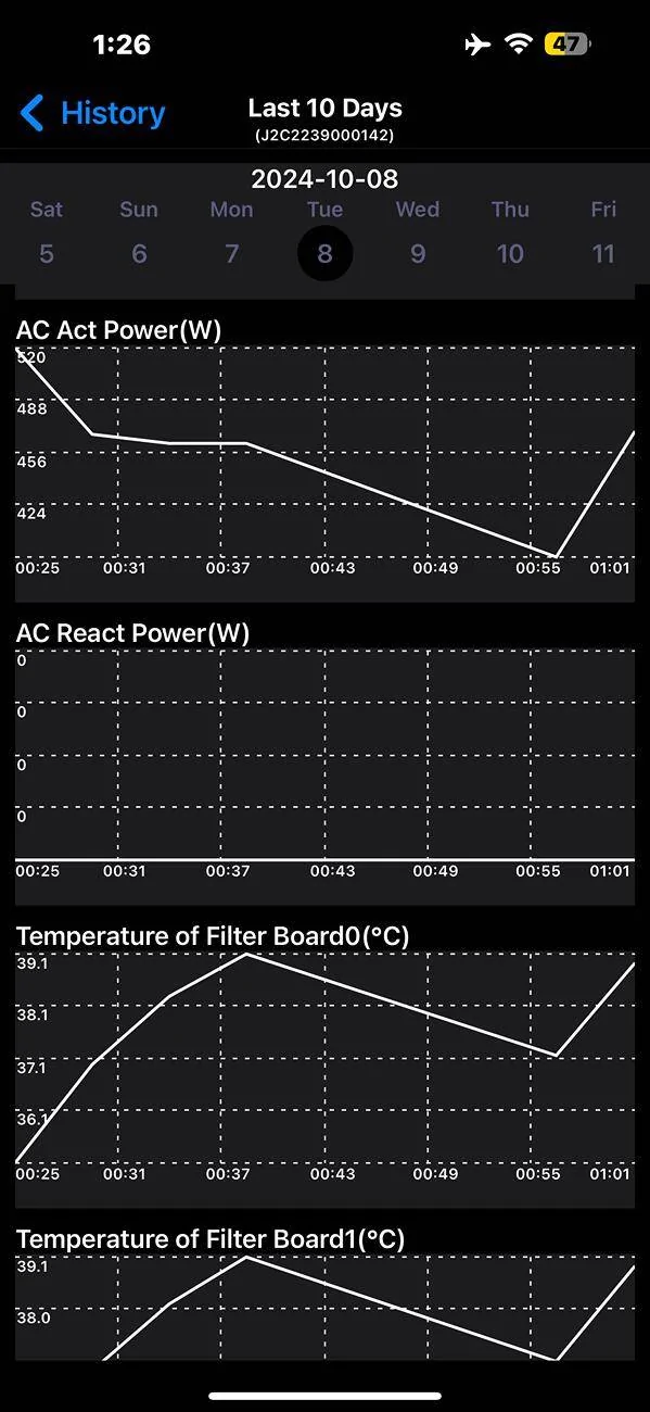

In my second previous post above, I mentioned that the M Professional app, available in the App Store and on Google Play, can log Delta BDI inverter performance. Here is what the app shows in the System History charts (Menu, Analysis, History, System History Charts) for the two backup transfer tests described in the previous posts done between 12:12 AM and 1:10 AM CDT on 10/8/24.
I'm showing all System History Charts. I have no photovoltaic systems attached (and it was nighttime, too!).
Ford F-150 Lightning Class Action Lawsuit - Home Integration System IMG_1084
Ford F-150 Lightning Class Action Lawsuit - Home Integration System IMG_1085
Ford F-150 Lightning Class Action Lawsuit - Home Integration System IMG_1086
Ford F-150 Lightning Class Action Lawsuit - Home Integration System IMG_1087
Ford F-150 Lightning Class Action Lawsuit - Home Integration System IMG_1088
Ford F-150 Lightning Class Action Lawsuit - Home Integration System IMG_1089_CRPD
So, there are a number of anomalous things about these charts, and I haven't been able to find a detailed guide or manual for the M Professional app on the Internet.
First, although the span of the BPT tests was from 12:12 AM to 1:10 AM and the app was run at 1:25 AM, the System History Charts do not capture the whole timespan the Delta Inverter was powered by the Dark Start battery (or the truck). The apparent span of the graphs is only 36 minutes, whereas grid power was out (with a brief intermission) of 13 minutes over 58 minutes.
There is a time delay in data processing, as shown in the System History Charts. There was nothing in the graphs immediately after the first test outage. Ten or fifteen minutes after the outage, the next time I checked, the graphs were populated with data. So perhaps the graphs only being populated at 00:25 has something to do with that delay. I am perhaps wrongly assuming that the ordinate shows MINUTES and not seconds.
The graphs make sense if we go to the end of the charts. Heat sink temperatures are rising as the test proceeds. It may seem paradoxical that the overall system temperature (last chart) was falling at the same time, but the truck was in an open garage at 83F, and the outside temperature was 73F. Twenty-two minutes later (during the 1st transfer test), the garage temperature had fallen to 80F.
Assuming the units on the ordinate are minutes and not seconds (supported by the observation that the length of the chart ordinate(x-axis) was extended between 12:37 AM and 1:25 AM; if it were seconds, there would be no reason to extend the ordinate as one goes minutes more into the test runs), the time interval for logging data appears to be ONLY ONCE EVERY FIVE MINUTES. The data points appear connected by straight lines, giving the saw-toothed graph appearance I noted in a previous post above.
Going further back towards the start of the charts, the AC Voltage and the AC Frequency graphs make little sense. There is no change in the abscissa values (Y-axis) with time. A pollyanna interpretation of those charts would be that there is so little deviation from the value displayed on the Y-axis that a difference cannot be discerned, e.g., the frequency is always 60.00 +/- 0.01 V, and the system can't detect a deviation to 60.1 or 59.9 V ....haha.
I didn't search very hard, but I couldn't find any options in Settings to change the values displayed on the X- or Y-axes of the System History Charts.
The M Professional app is incredibly powerful. It would just be nice to know how to use it properly.

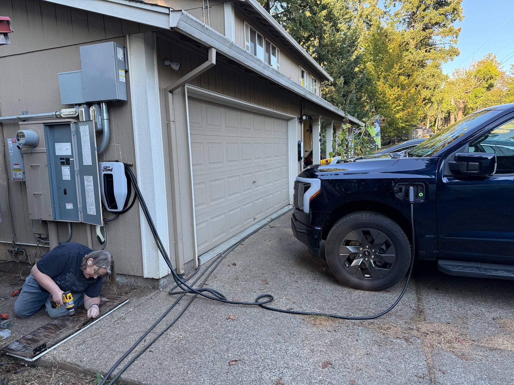

So I went ahead and tested my system today for the first time in a couple of weeks. The first time I was in my driveway with the frunk up, and it would not come on.
I then disconnected everything closed the frunk and pulled up closer to the garage (still completely outside). This time it worked perfectly. It appears that the frunk is a viable bluetooth blocking device.
