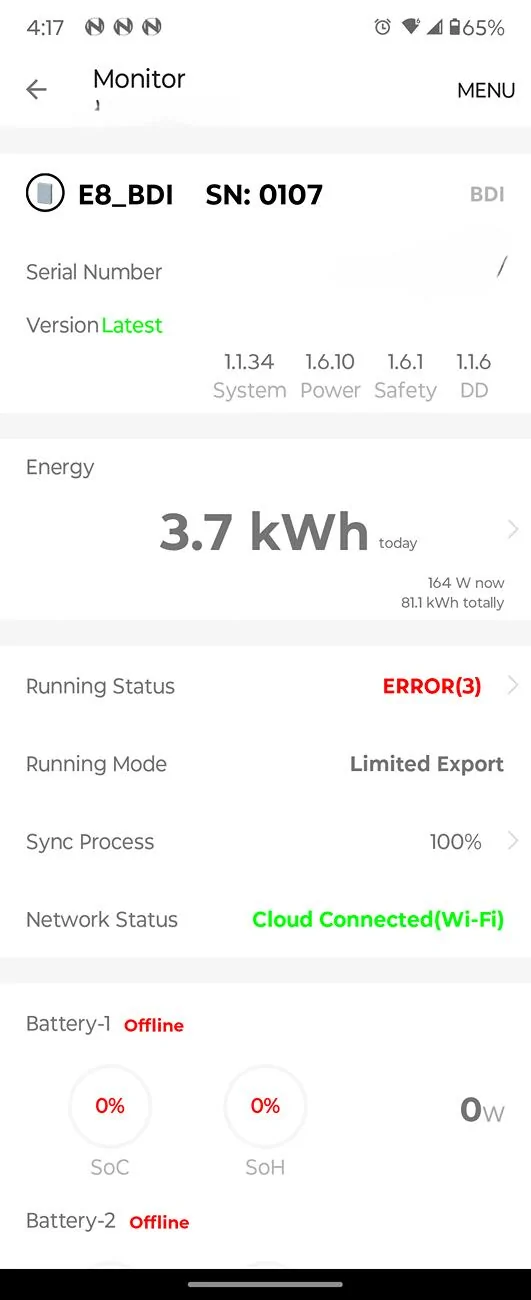

I am also having issue with mine. I can not get it to work. The best thing it does, is it sends power to the inverter and wont send power to the main panel (house). I just got ECG-24.2.5.6.2.2 updated this week. Do you know if ECG-24.2.5.6.2.2 will update the Bluetooth firmware?
Ford F-150 Lightning Class Action Lawsuit - Home Integration System Screenshot_20240912-151708_M Professional (1)
Ford F-150 Lightning Class Action Lawsuit - Home Integration System Screenshot_20240912-175905_M Professional (1)
I believe there is no issue with the Delta portion of the system. It looks like it is working properly.
Is it at the latest firmware?
The transfer does take about a minute or so to initiate.
Has the system ever worked?
What is the status light of the charge station pro? I assume it is solid green.
What is the status light of the charge port status ring on the truck? Is it white or green?
What does the intelligent backup app show (a screenshot would be useful)?
How close is the charge station to the truck?
I am not sure exactly what update fixed mine as I got 2 of them between it not working and being successful. I do know that 6.14 was one of those 2 I received. I think ECG-24.2.5.6.2 could have been the other one, but not certain.

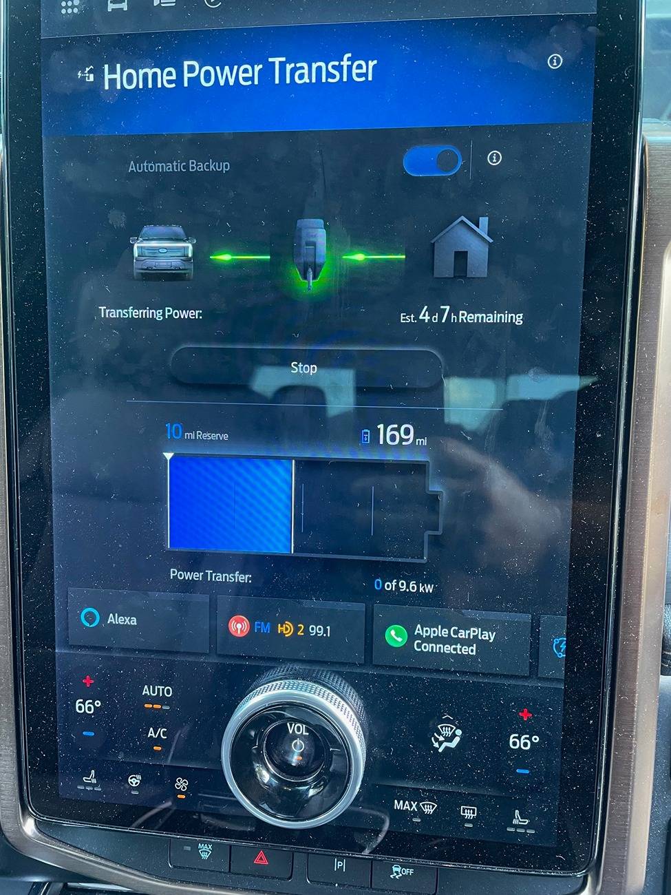

Has the system ever worked correctly sending power to the loads?
If the truck and charge station pro are both blinking green, then the truck should be sending power. The intelligent power app is in the truck on the main screen. I will attach a screenshot below. It will verify the power transfer.
If the truck sends power but the inverter isn't sending further to your backup panelboard, I would think you either have a communication error on RS-485 lines, or your transfer switch WHB200 isn't being seen by the inverter. You aren't turning off a breaker or disconnect between the inverter and WHB are you?
Again it makes a difference if this has ever worked or not.

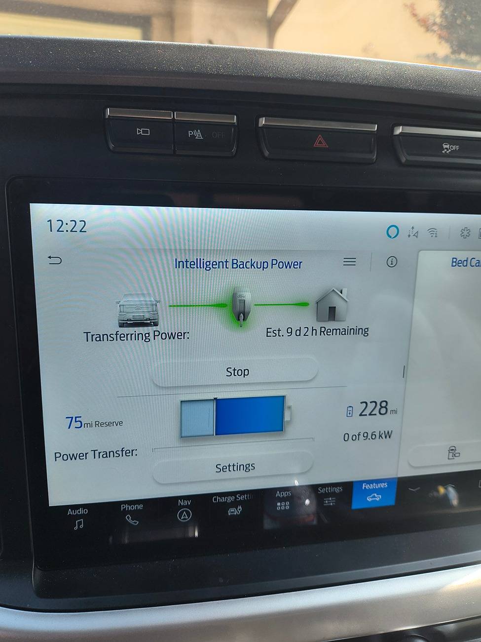

It has never worked, I just turn off the main breaker to test it no other switches.
Well the great news is that the truck to charge station is working, and that is typically where most people have issues.
The bad news is that it is most likely a wiring issue...who installed the system and what is your level of comfort trying to diagnose electrical yourself?
The setup should be main panel -> Whole home backup (WHB200) -> secondary panel board -> inverter. I have a suspicion something in that sequence is incorrect. For instance do you think a 5kW load on your critical load panel is correct? That seems like a lot to me.
A lot of this is going to require taking off covers and tracing wires. Something you should not do if you are not familiar with it.
