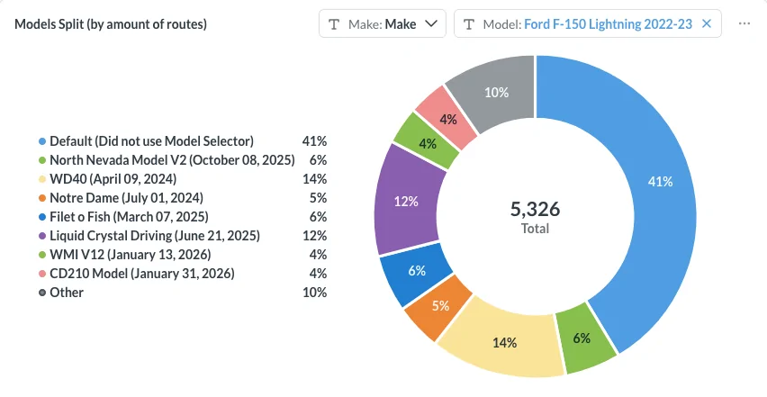

@UncleTony I saw you recommended FoF Liquid Crystal on Discord.
Any chance there's explanations about Liquid Crystal vs WD40 vs Notre Dame?
I haven't done any highway testing yet, but was thinking about what I should be looking for - I was also interested in all the new world model stuff.
I preferred FoF liquid crystal when I had my lightning. I know a lot of people prefer WD40 and Notre dame as well. It really just depends on what you like and the way the truck performs with the model.
