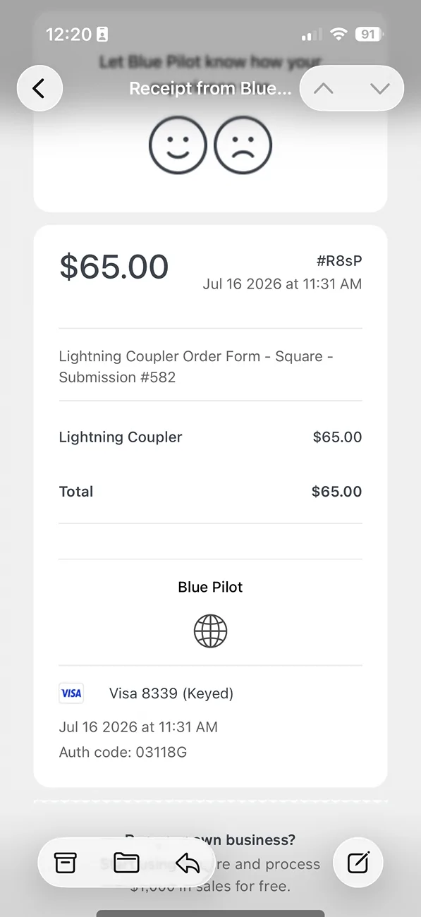

Howdy, first post here. I purchased my comma ai 4x and blue pilot usb c last week. The comma ai came in yesterday, but I have no updates from blue pilot and no way to get ahold of anyone. If I have to wait, that’s fine, I just would like to know that what I bought is real and I’ll eventually get it lol
Ford F-150 Lightning Comma AI self driver assistant IMG_2528

My dock took about 3 days longer than the Comma to arrive. I would imagine the coupler to be about the same

It will also work fine without the coupler, you'll just get a bunch of errors/warnings on truck startup. They'll go away in a couple of seconds.

you’ll get a pirateship email when it goes out. Usually ships within 48 hours, so check your junk mail for the tracking link.
