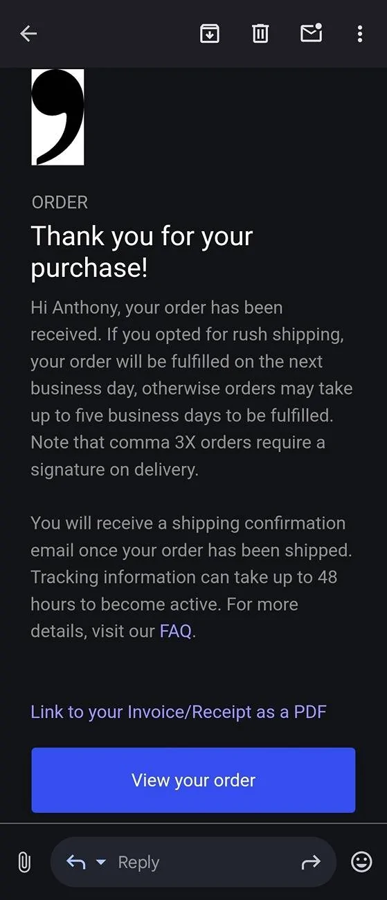

A forum member from Canada is drop shipping me a full unit from comma so I can modify it and send it on to him. I'll try the ferrite core with my long usb-c cable once i get it. Should be any day now.
I opted for the rush delivery, so we should be getting them around the same time.
I got the long cable from comma as well, so I just need to order a 90 degree usb c adapter from Amazon and the ferrite.
