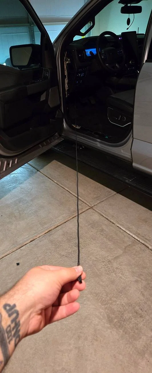

I'll see if I can get it installed after I figure out how to get this extremely short power cable ran to the obd port.
I cut it down and solder sealed it back together.
I was going to ask if it could be shortened. Wasn't sure what all it's sending through the cables. I'll cut it down once I have time to play with the unit.
