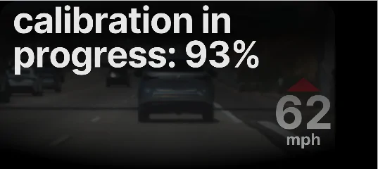

Also they are gung ho on the C4 to the point you cannot buy a 3x anymore. Are there any plans to port the car ahead speed data to their tiny screen c4. I know it may be a bit cluttered, but it would be nice to have.
We actaully added, but not following the vehicle on the UI, it's a static number in the bottom right.
