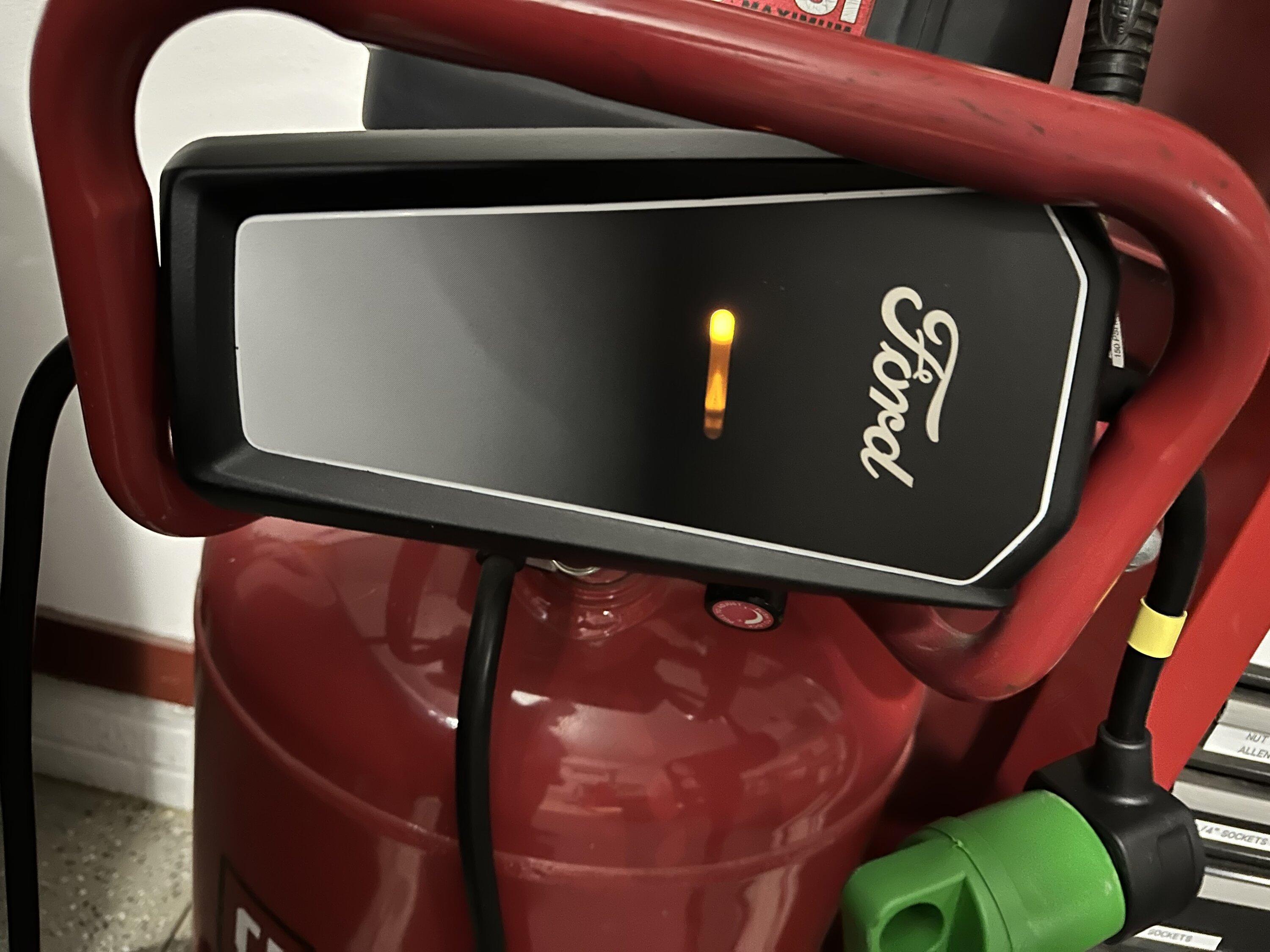

Is anyone else having issues with the mobile power cord constantly erroring out? I will charge for a few minutes and then the amber light comes on and the truck stops charging. Unplugging the cord from the wall and plugging back in typically fixes it but sometimes fault out again. I"ve used this same outlet for 7.5 years with our Tesla and no issues. Page 203 if the manual says amber indicates the unit is rebooting but it will sit there like that all night. Page 205 says than an 'on' amber light says its a fault that requires troubleshooting and to ensure everything is properly connected (which it is). I've had more issue as the weather has gotten colder so I don't think it's too warm. I tried calling Ford with the information in the manual and they told me to take it to my dealer. My dealer said that an OTA update on 11/17 should have fixed it but that is not true.
Any ideas?
I've been waiting 8 months to get my service upgraded to use the pro charging unit but there is still no word from the electric company so I'm stuck using this cord until that time.

Try using the 120v adapter to see if the error goes away, then retest with the 14-50 plug.

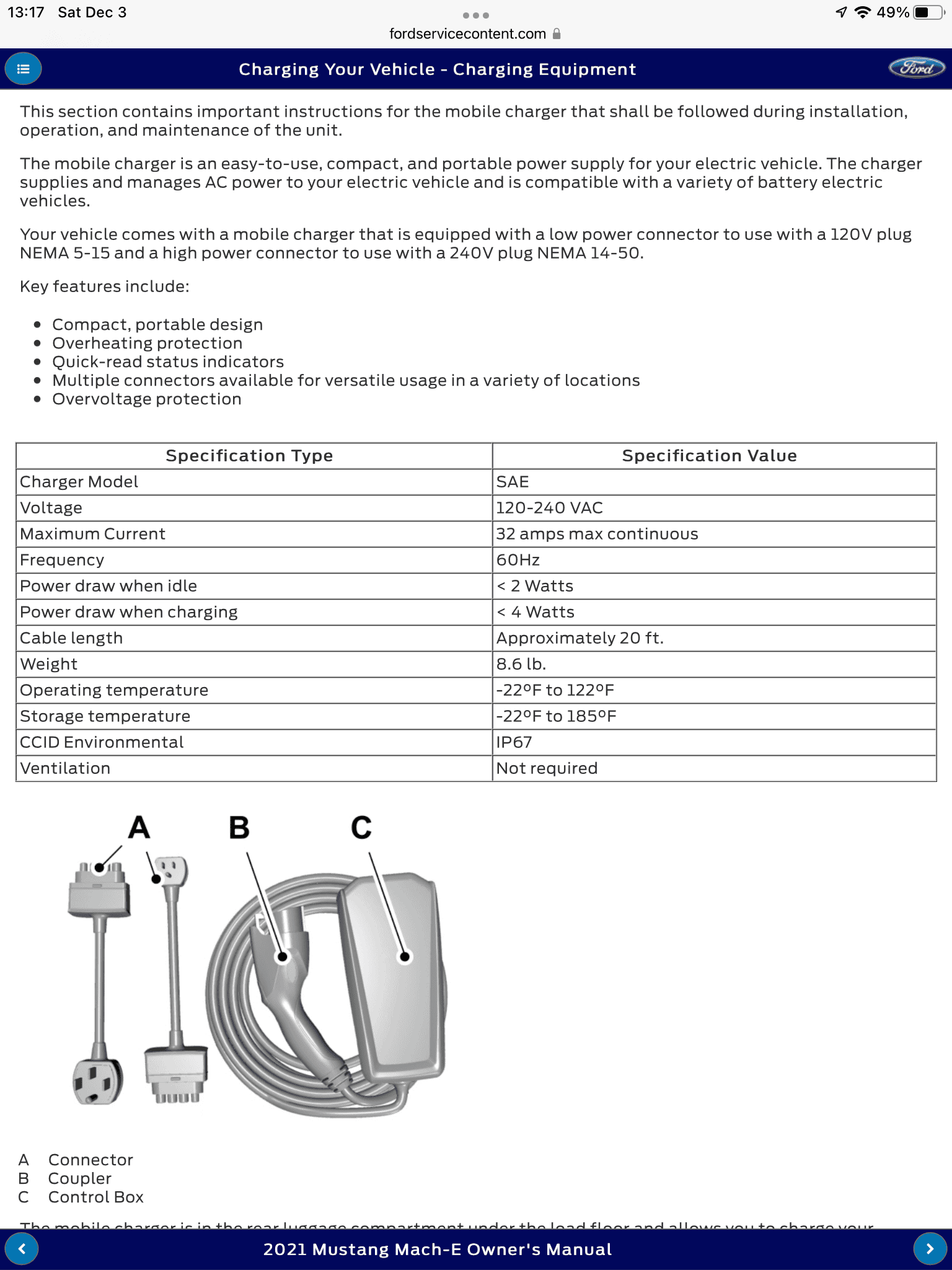

FMC specs from the ā€˜21 Mach-E OM….it wil be interesting if it’s operation doest work within the stated specs…..?

What level of amperage were you using to charge your Tesla? What type of plug (& wall receptacle) is attached to the green 14-50's cable?

We charge our Tesla at 40 amps (50 amp circuit breaker). We have a NEMA 14-50 outlet. The green end is a 50Amp extension cord with NEAM 14-50 connectors I bought to go from the outlet to the side of the garage the truck is on so I could use the mobile connector to charge until my electric service gets upgraded and the pro charger gets connected.

I can confirm that my mobile charger does not like cold weather. I have tested it on both 120v and 240v circuits at 17F to 35F and it faults out. When it is kept in a warm environment it works as expected.

despite my efforts to experiment and troubleshoot I’m coming to the same conclusion. The charger is just iffy and gets more faults the colder it gets.
