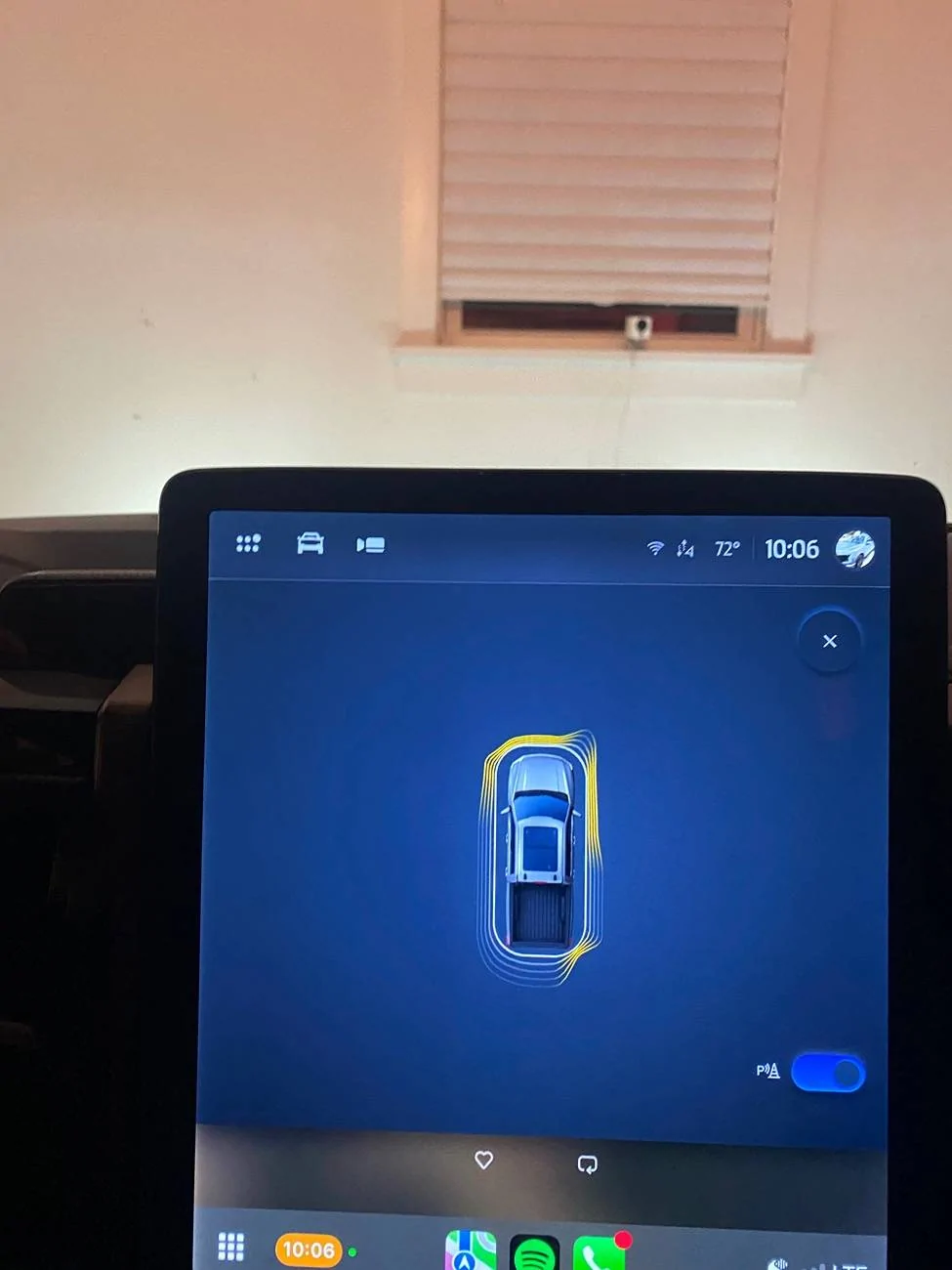

Is this the screen you get when approaching something? It’s what I get after this CSP
Yessir. That's what mine looks like - no front camera activation.

Seeing as you have a '22, you run the potential to encounter the smaller 360 camera view if the tech does not run the 360 camera configurator after the update.
And the front camera not activating issue.
I don't have the small 360deg camera issue on my 22, but do have the no front camera on approach issue.
Just adding to the pile: mine looks like that also.
It doesn't bother me that much since I almost always manually switch to the 360 view when parking in public or pulling into the garage, but still, it's something that had different behavior previously and appears to have been unintentionally changed by the IPMA update.
