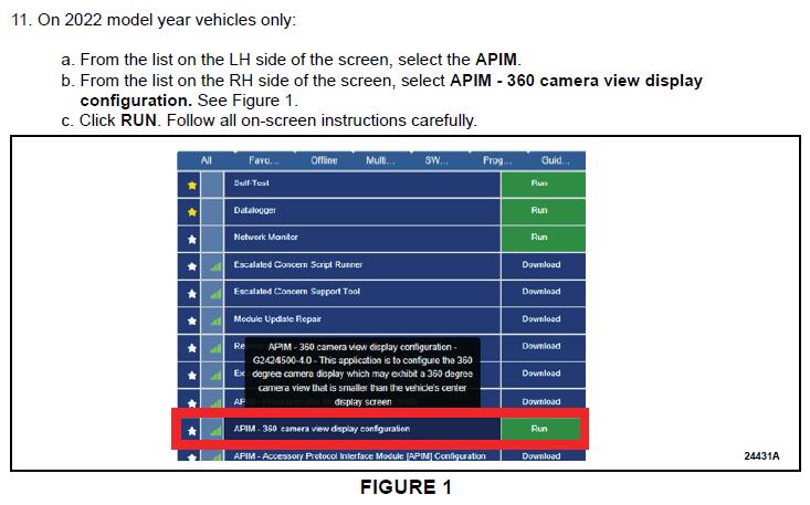

Yours is normal. The only issue is on 22's where the dealer didn't follow directions so they're left with the black box around the image until it's either fixed in FDRS or FORScan.
So I just picked up a 22 today and mine is definitely the small one. What do I tell the dealer when I go back? I still have warranty here to work with.
Have the tech look at step 11 on 24B56.
Ford F-150 Lightning CSP 24B56 - Inoperative Front Parking Sensor(s) - IPMA Software Update for Certain 2022-24 F-150 Lightning Trucks 24B56_360_Camera_View_Fix
Yep, just dropped mine off yesterday to have the 360 postage stamp fixed.
