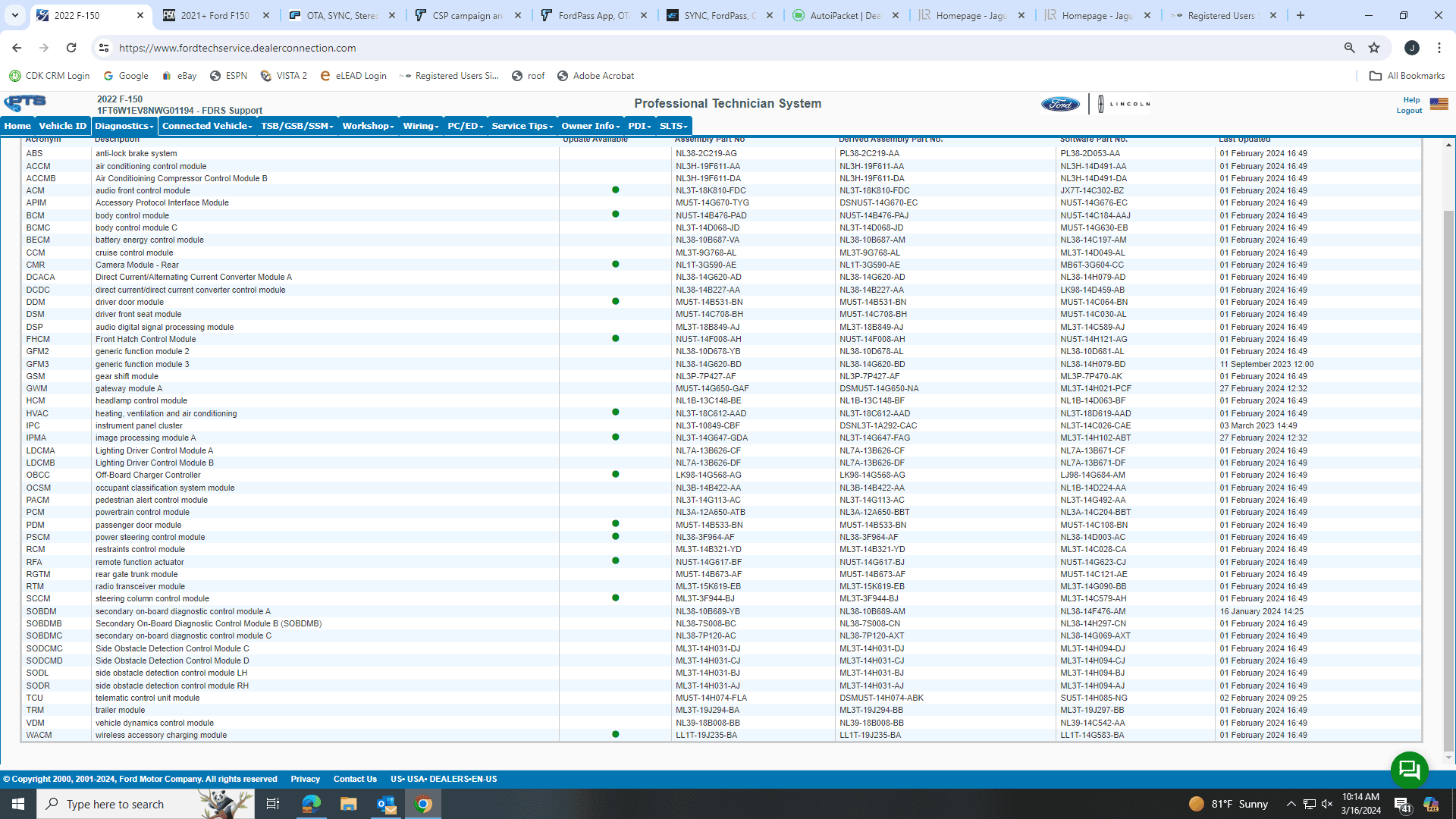

If you dont mind, could I get some help with mine as well. 1FT6W1EV8NWG01194
Just got it and making sure I didn't miss anything.
rugedraw
Javier
Dec 14, 2021
1,897
2,321
Miami
Auto Sales
Modules with pending updates are below. Last OTA you got was 6.2.0 a few weeks ago, so you are getting updates.
thank you. Good to know the updates are still going. Is there anyway to force the rest individually or are those dealer only updates? Trying to be as self sufficient as possible
