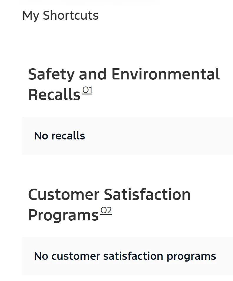

Perhaps it's too soon for any notice of CSP 26B09 to show for affected owners, but I just got my monthly vehicle health report and visited my Ford account page. It shows no outstanding recalls or CSPs for my vehicle:
Ford F-150 Lightning Customer Satisfaction Program (CSP) 26B09 - GWM, APIM, TCU Update - Intelligent Backup Function 1783571726694-83
