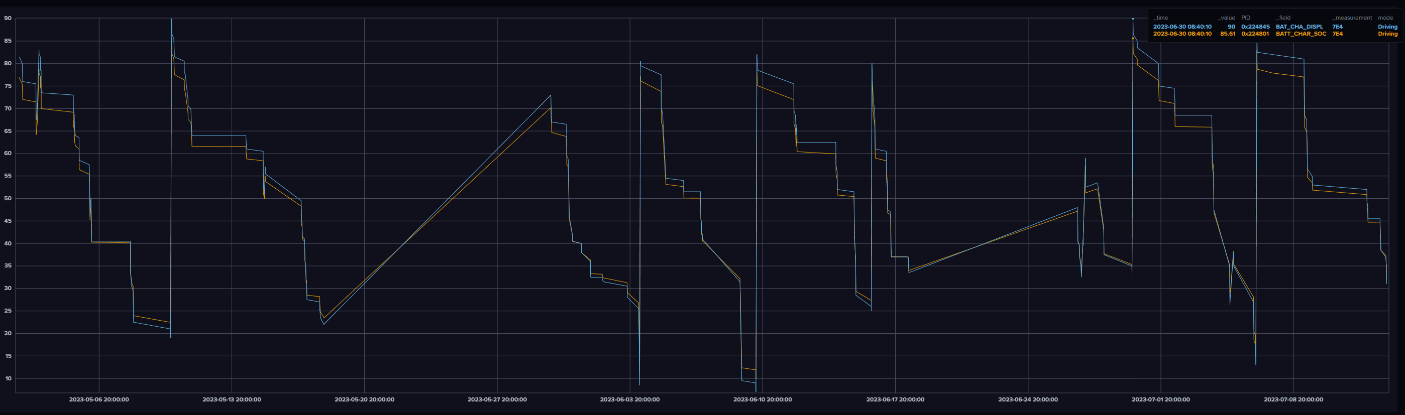

Btw, most cars with the 80-90% daily charge scheme have very little buffer up top. A couple percent at most, not 5.
I believe several folks here have shown with OBDII data that 100% displayed is 95% actual. I know @mr.Magoo tracks it and perhaps can chime in with more concrete data.
So, I haven't charged my truck to 100% since May (should probably do that), which is when I wiped / restructured my database, but you can check out the graph for some comparisons over time.
Worth noting with displayed vs. actual, is that it reads higher than actual above 40% SoC but lower, below it, so it's not a percentage or linear scaling, I can only assume it's a part of built in buffers, both for charging and running out of "juice".

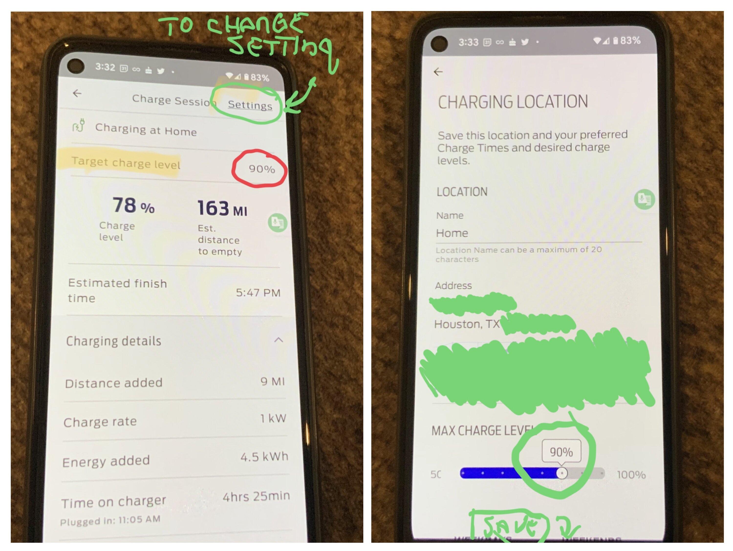

I screen captured this for reference. On the app on my phone I can set charging level for a location, this happens to be a 120 outlet at home.

This never worked for me. I had to change it on the truck
