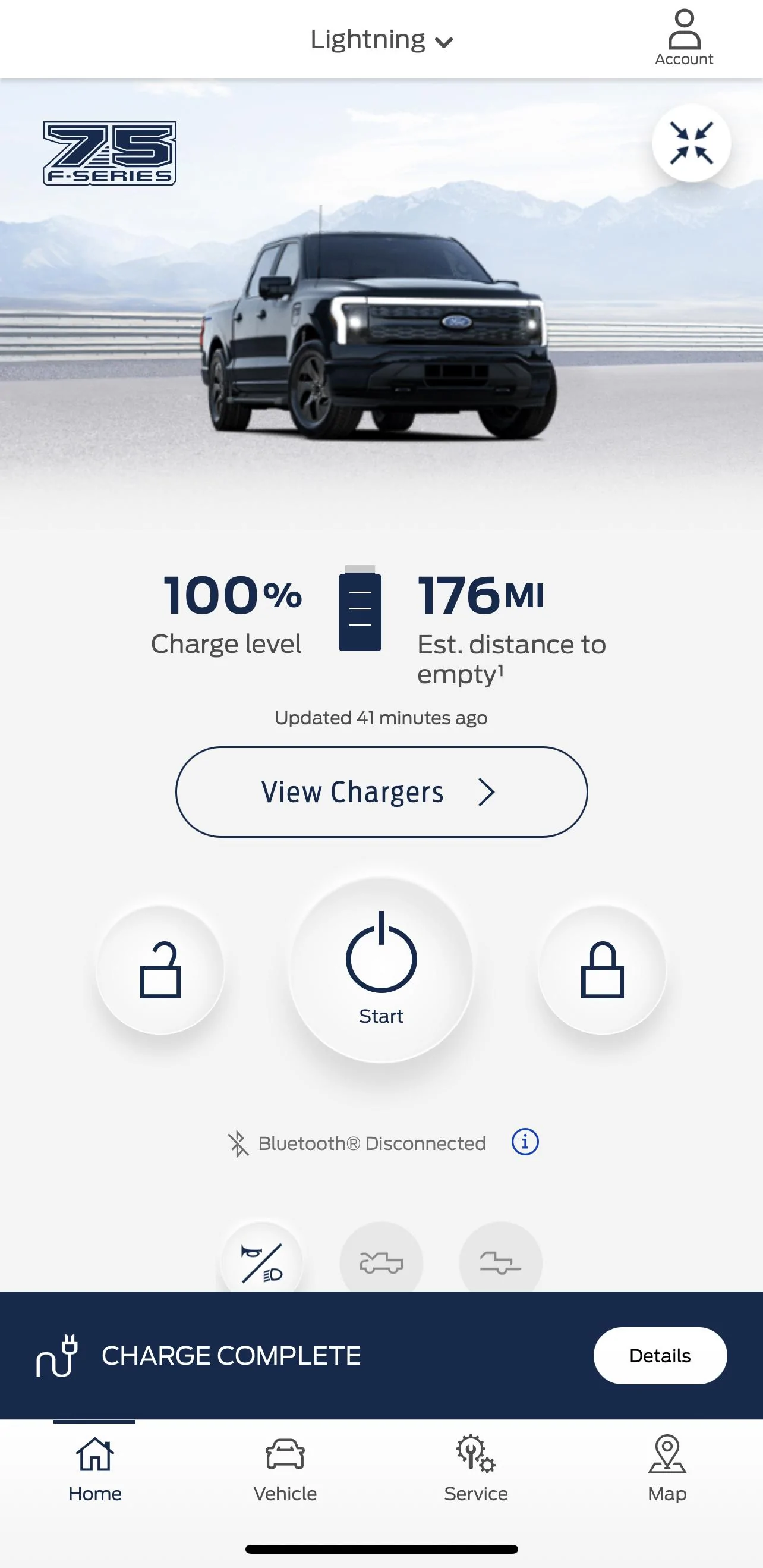

App shows charged to 100%- but when I start the truck again it updates and it actually is only at 80%
I think part of the SW problem is that the app doesn't communicate with the truck reliably. This part of the app always reflected the same as the truck. My problem was with the app's charge % setting screens. That was no where near correct. App would be set for 80% but the truck still charged to 100%. Location etc was correct.
I believe I fixed mine and will try to load pics showing steps that seemed to work for me. It's charged correctly twice and I think everything is right working now.
