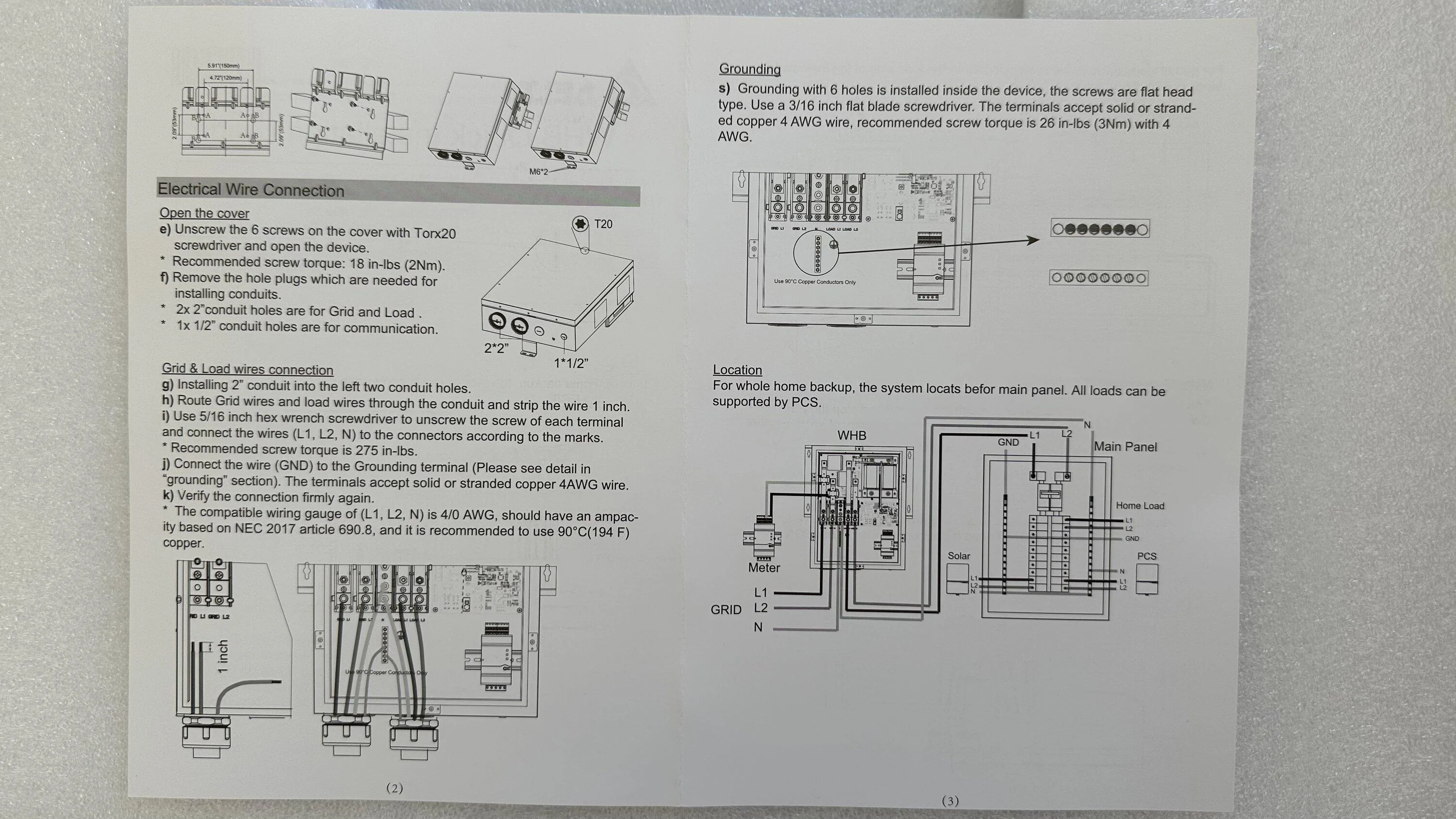

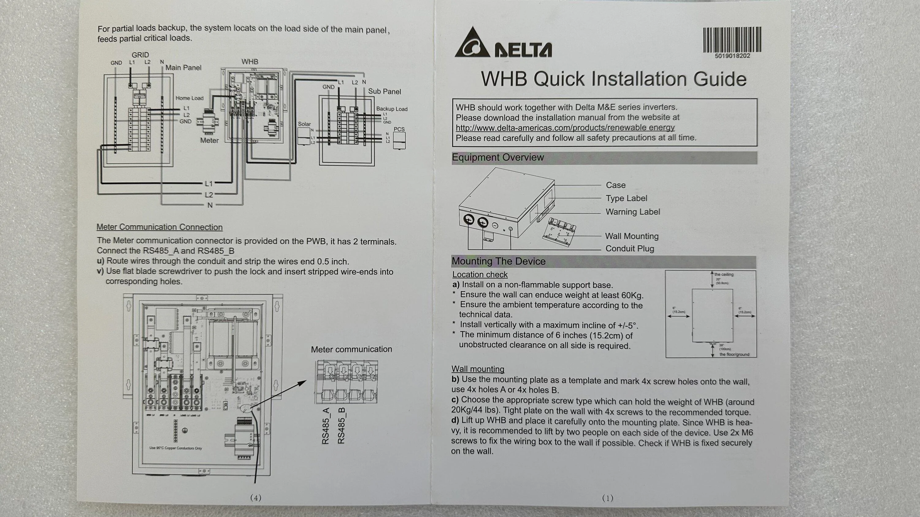

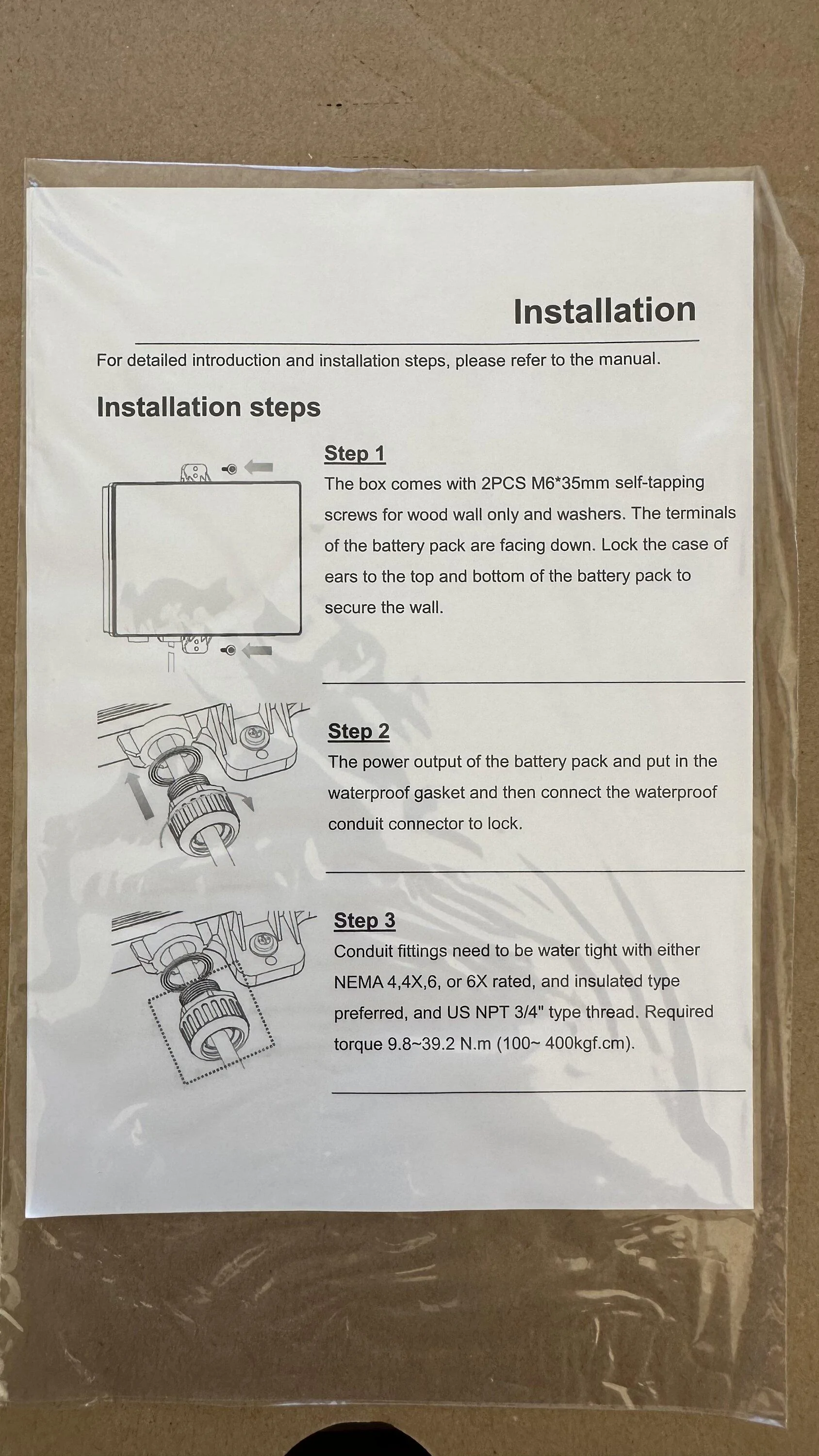

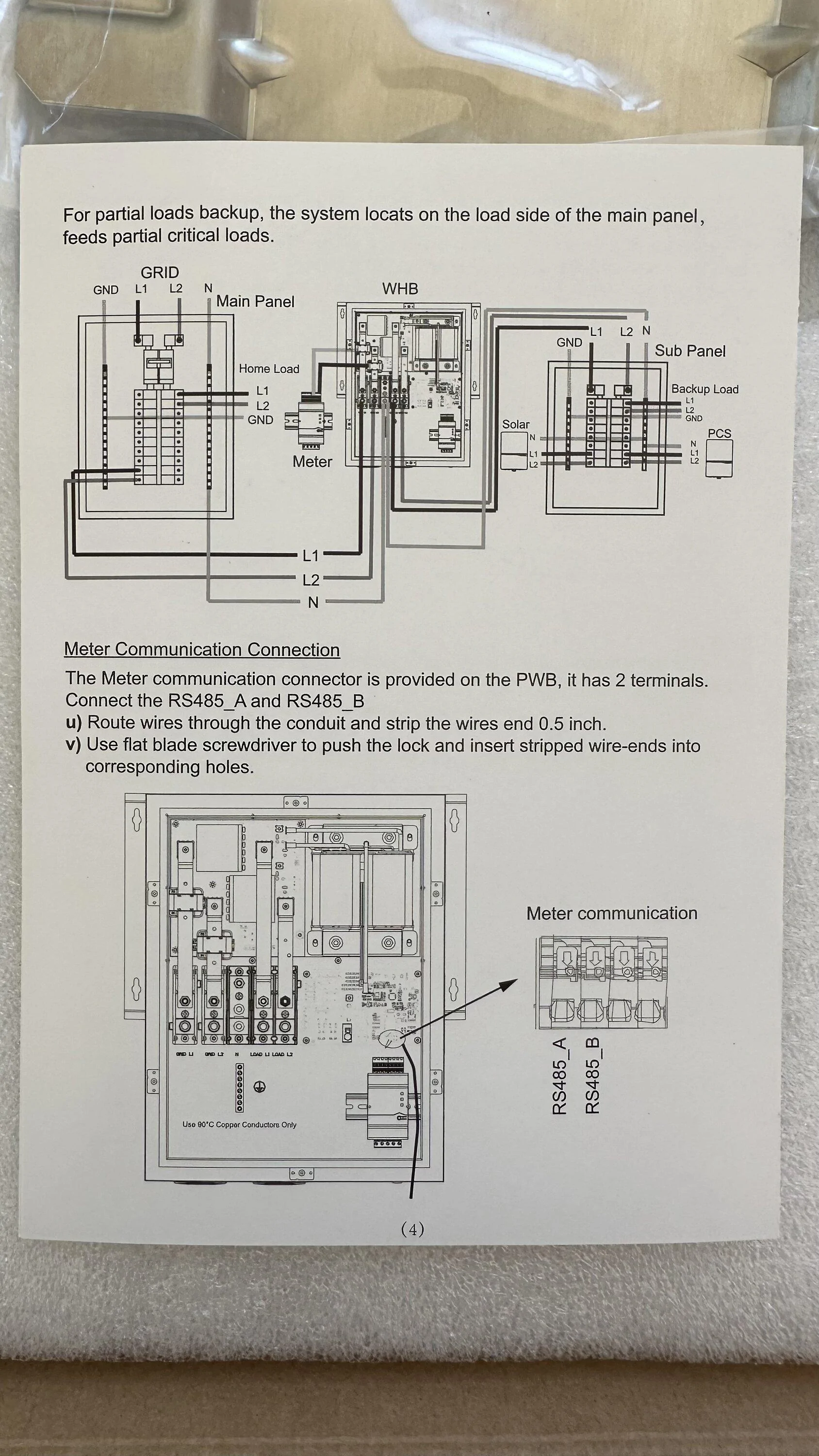

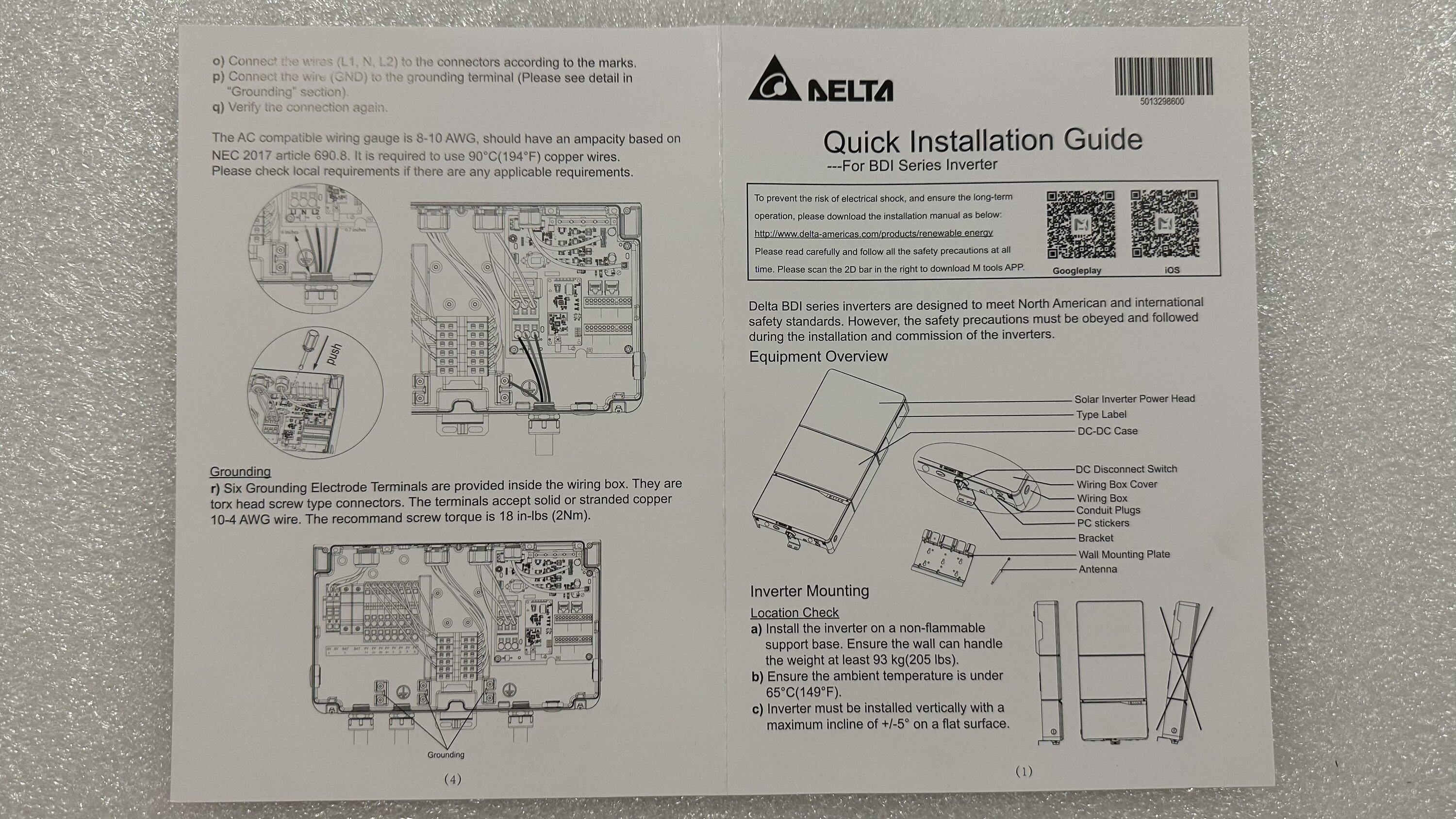

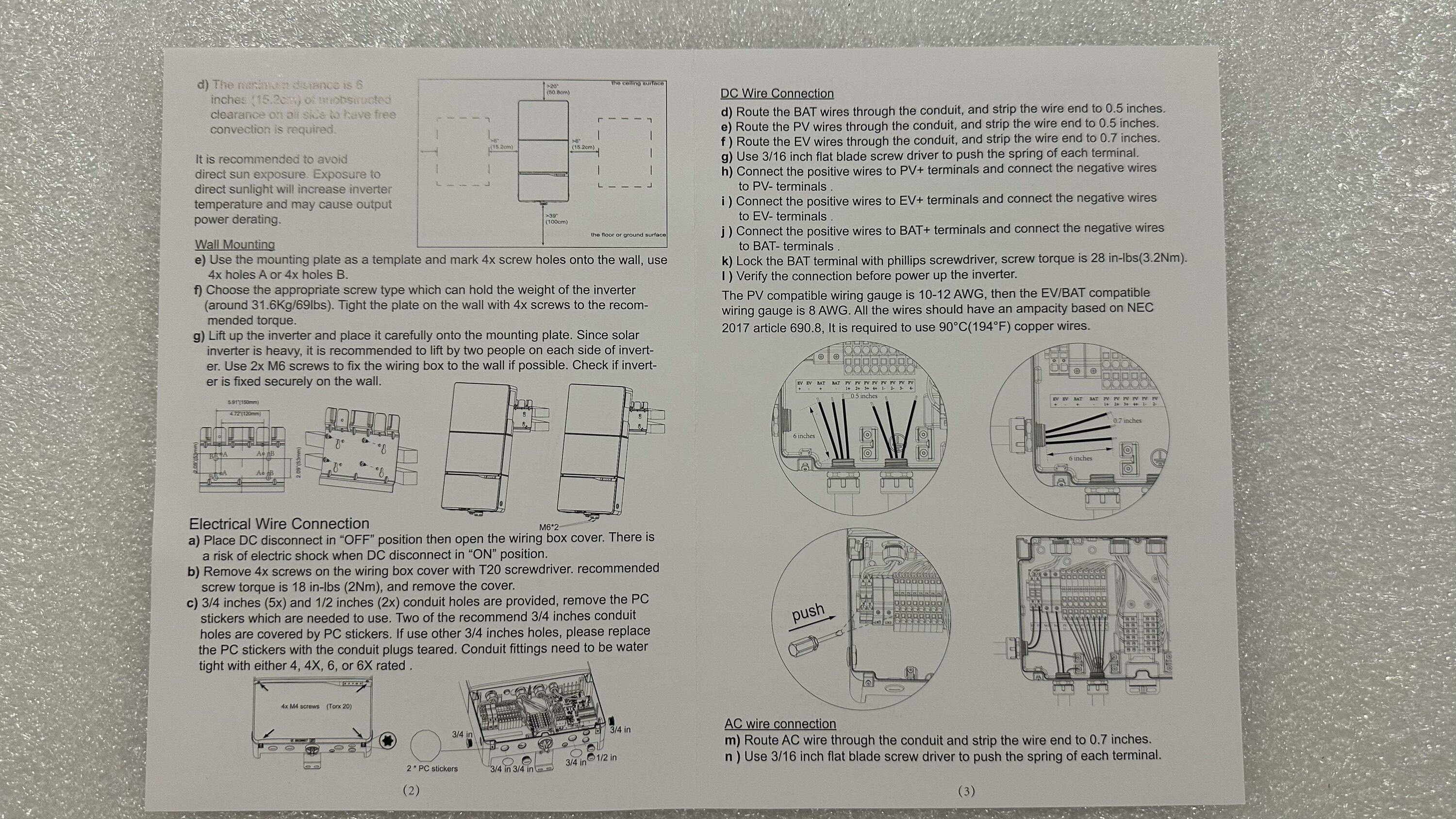

You don’t get a detailed step by step instruction for the whole system. You just get an install document for each component.
