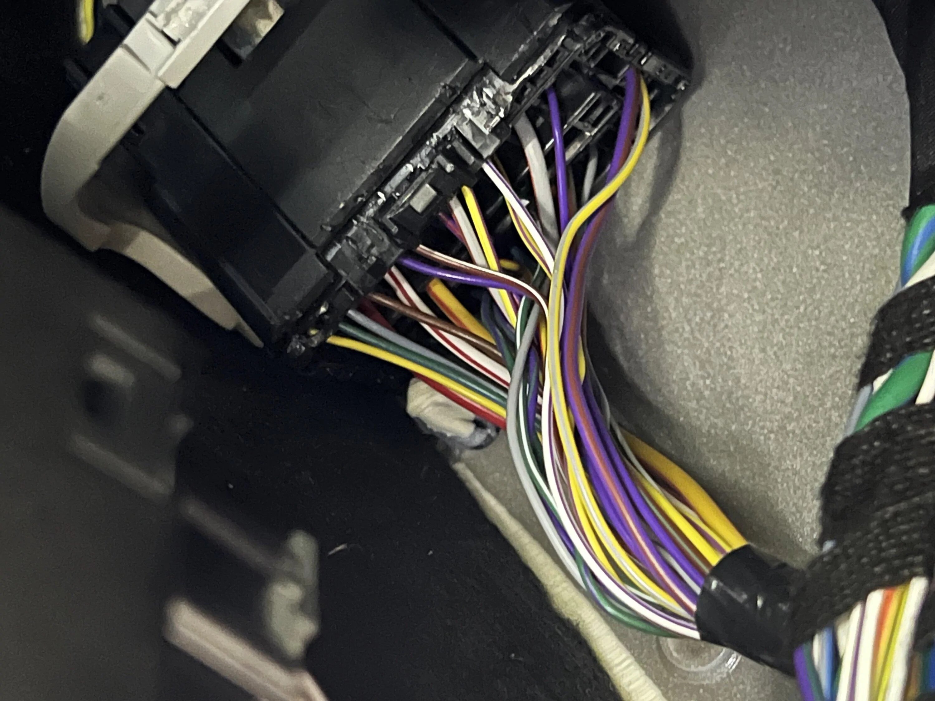

Did you check c265 as well? I think that's where people have been missing wires (someone please correct me if I'm wrong)

Yeah if your missing wires the easiest way to tell is in your passenger kick panel which is a pain in the a** just take your time and don't break the tab on the connector

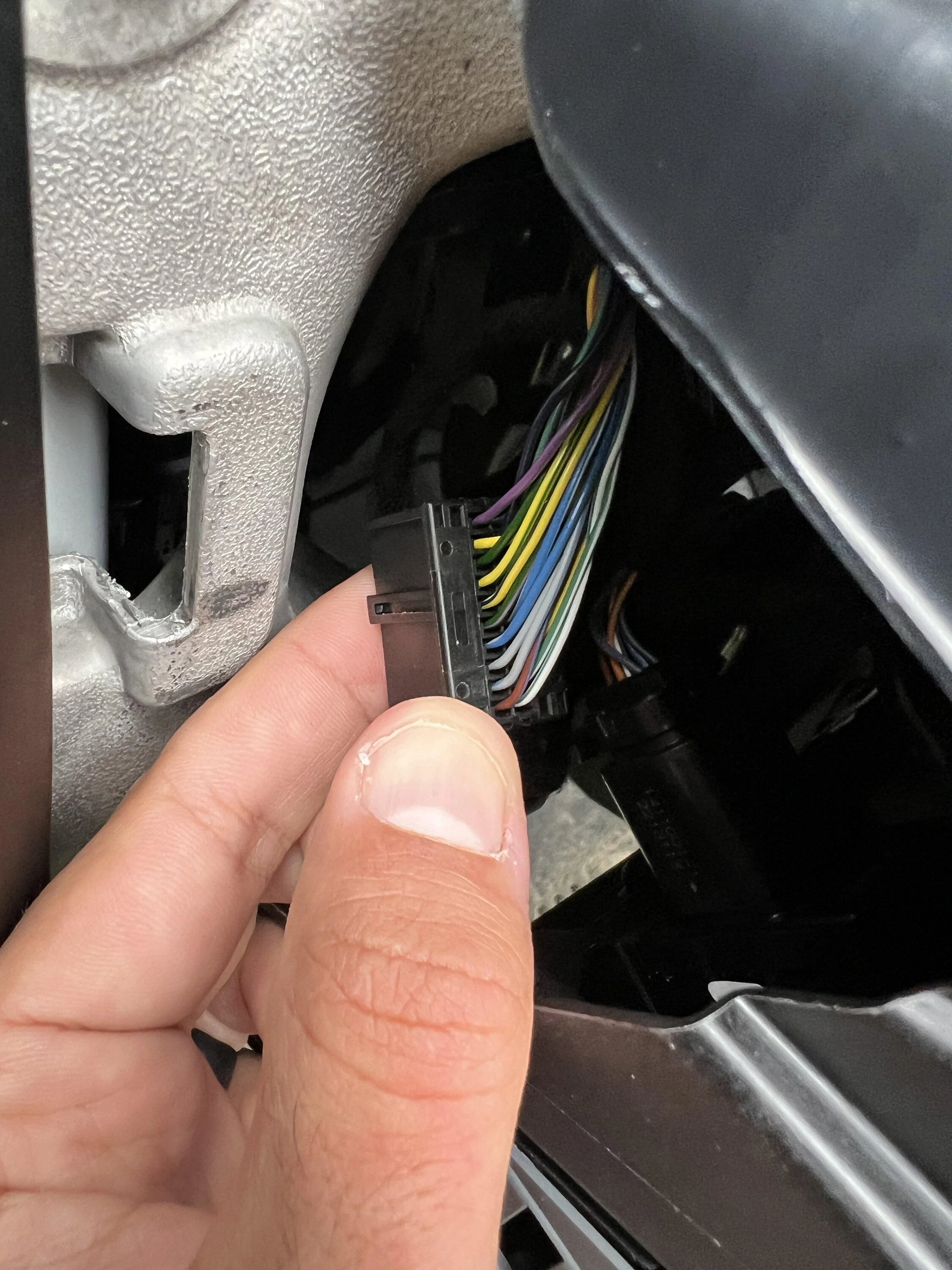

Anyone got any tips on getting the c265 plug out. I got the gray retainer clip off fairly easily but can’t get the plug to unseat. I took a photo but it’s impossible to tell.

Haha ok good. Thought I was blind for a minute. I messed around with the c265 plug too but couldn’t get it unseated easily. I think I’ll just take the bumper off tomorrow.
If you just look for the colors of the wires, you could tell that way. Probably be easier than pulling out the frunk since you already know where c265 is

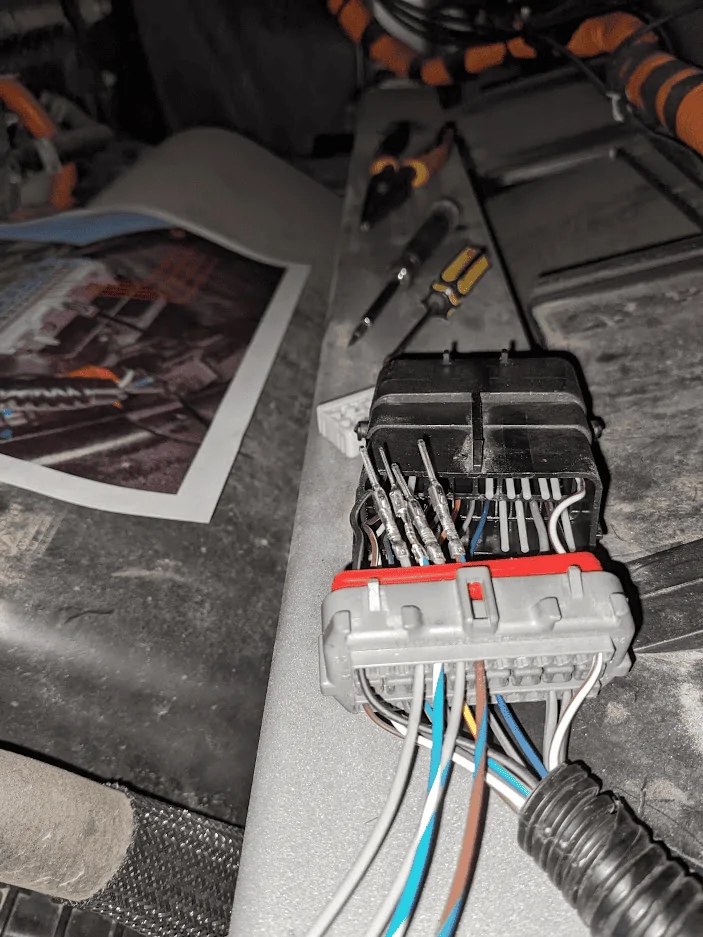

If you haven't done it before in plain view which is how you can do it when you take the front bumper off then I'll be honest it's probably impossible to figure out. It can be done once you know exactly how it works, but it has to be done with one hand from below by reaching up beside the right frame rail by the PAWS speaker (which I also had removed long ago). Once you get the connector separated, the truck side can be brought up into the frunk tub area through a slot, I did this 3 different times while figuring everything out. This is one of those times:
Ford F-150 Lightning DIY: Installing ACC (Adaptive Cruise Control) and LKA (Lane Keep Alert) to 2022 F-150 Lightning XLT 1685768309145
That connector is so big even after you've unlocked the cam lever it's still a PITA to separate with one hand. I had my brother help me the first time with screwdrivers from the top side looking through the crack from the frunk tub space. You can also initially unclip the cam lever from the top side with just the right long screwdriver or pick.
