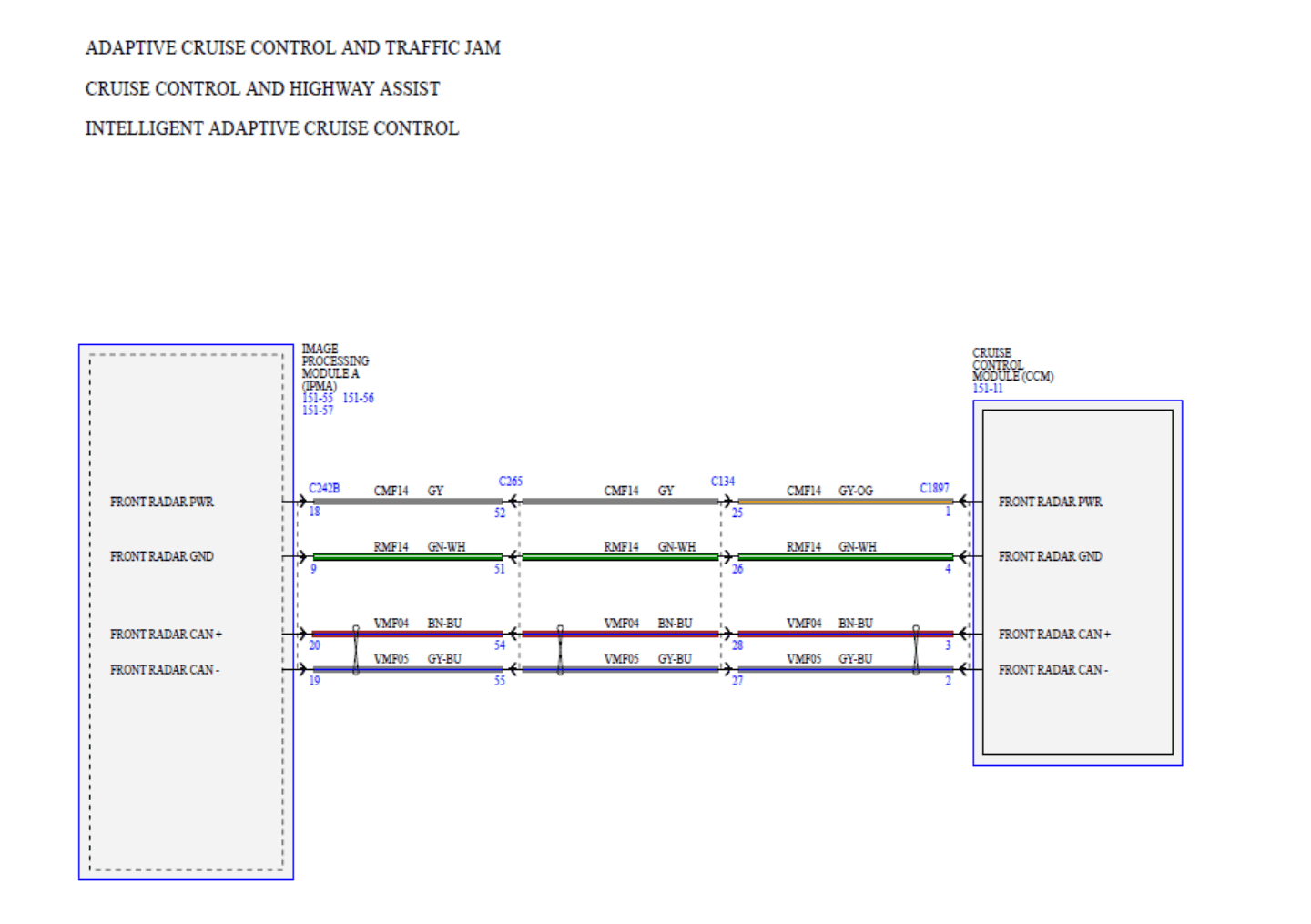

Anybody have a video of this install yet? I need to see it first. If I can find that I have the wires this seems awesome.
ZSC100
Zach
Mar 29, 2023
371
290
Tulsa, OK
Electrical Engineer

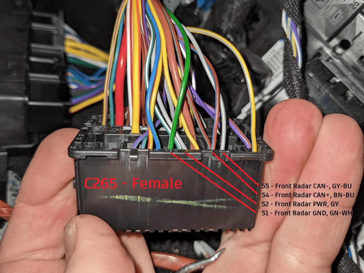

You don't need a video to check the wires, remove your fuse box cover and passenger kick panel and look at plug C265.
Ford F-150 Lightning DIY: Installing ACC (Adaptive Cruise Control) and LKA (Lane Keep Alert) to 2022 F-150 Lightning XLT 1686160798513

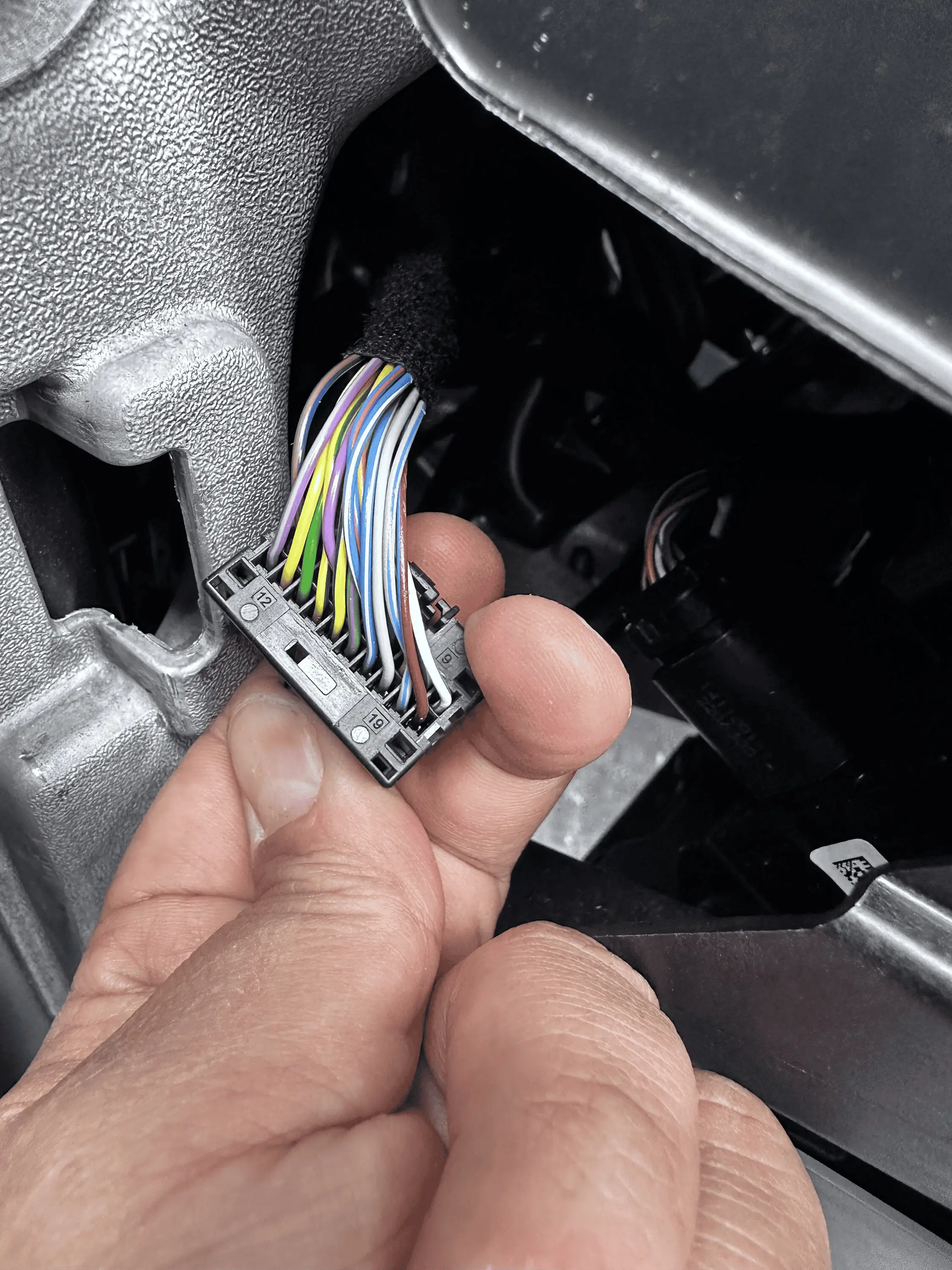

See my post on page 6 to learn how this connector comes apart.
Ford F-150 Lightning DIY: Installing ACC (Adaptive Cruise Control) and LKA (Lane Keep Alert) to 2022 F-150 Lightning XLT 1686161457156

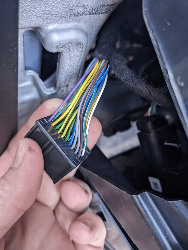

IMPA is Image Processor A, and it's just above/in the drivers kick panel, you can reach it from underneath and through the dash side panel with the door open. This is the connector that has the CCM pins:
Ford F-150 Lightning DIY: Installing ACC (Adaptive Cruise Control) and LKA (Lane Keep Alert) to 2022 F-150 Lightning XLT 1681509154916-
You can pop this connector out easily in 30sec to check if you have wires form the IMPA or not.
9,18,19,20 will have wires of the correct color based on the diagram.
Just to summarize: To check for missing wires, based on your diagram and pictures, we need to inspect the IMPA connector (C242B?), and the C265 connector. What about the C134?

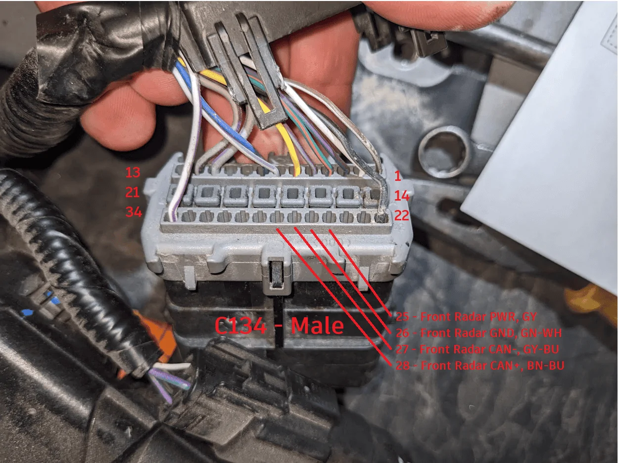

Well, sorry I wasn't super clear. There are three segments of wires from the IMPA and CCM. Most everyone seems to have the first. The middle segment is the one that some don't have and yes that does require you looking at C134. If you've never messed with that connector or had the bumper off, You can get to it by taking the plastic bumper cover like piece above the bumper off. It has a few screws in the fender well and then it pops off like a bumper cover.
Once you can see the connector, you're looking for these four wires.
Ford F-150 Lightning DIY: Installing ACC (Adaptive Cruise Control) and LKA (Lane Keep Alert) to 2022 F-150 Lightning XLT 1681156950543-
The final segment is the actual front bumper harness.
Thanks! So if I understand this correctly is it safe to say that if the wires are present in the C134, then they'll also be in C265, and vice-versa? So I only need to check one of the two connectors to check whether these 4 wires are already in place?
It's not safe to say anything unfortunately. FORD behavior with the REVC is bizarre to say the least. My wiring for Passive Entry doesn't match the color codes of the official wiring diagrams, and even more, the wire colors they used are misleading electrically.
It seems that most everyone has the wiring form the IMPA to the to C265 for the CCM, then from C265 to C134 about 50%, then everyone needs the bumper harness. They're calling this bumper cover like piece above the bumper the "upper bumper" here:
It's really not too hard to take off if you have a bit of experience with bumper covers. They you can see if you have the middle segment of wires or not.
I found the C265, but I'm struggling to find the IPMA. Do I need to remove any side panels on the driver's side to see/access it? Looking at the picture above I can't even recognize that big metal panel on the left.
My C265 female side definitely does not have the 4 wires (nothing to splice into). I assume this means the IPMA does not have the wires (though I need to confirm). Can I just bypass the C265 altogether and add the four wires directly between IPMA and C134? Does the C265 distribute these signals elsewhere as well?

Yes, with the driver's door open it the panel on the left side of the dash. Once you have the panel open you can reach up from underneath while looking into the dash to see what you're doing. The IMPA is the biggest module mounted up on the left/outside behind and to the left of that access door.
You very likely have the wiring from the IMPA to the C265 (passenger kick panel), this means you only need the wires from there on. The harness you buy from ford is the bumper harness, leaving the wires you need to add manually only from C134 to C265. In other words, the wires you have to add manually (non OEM) are the 4 wires that make up the center segment in the wiring diagram.
