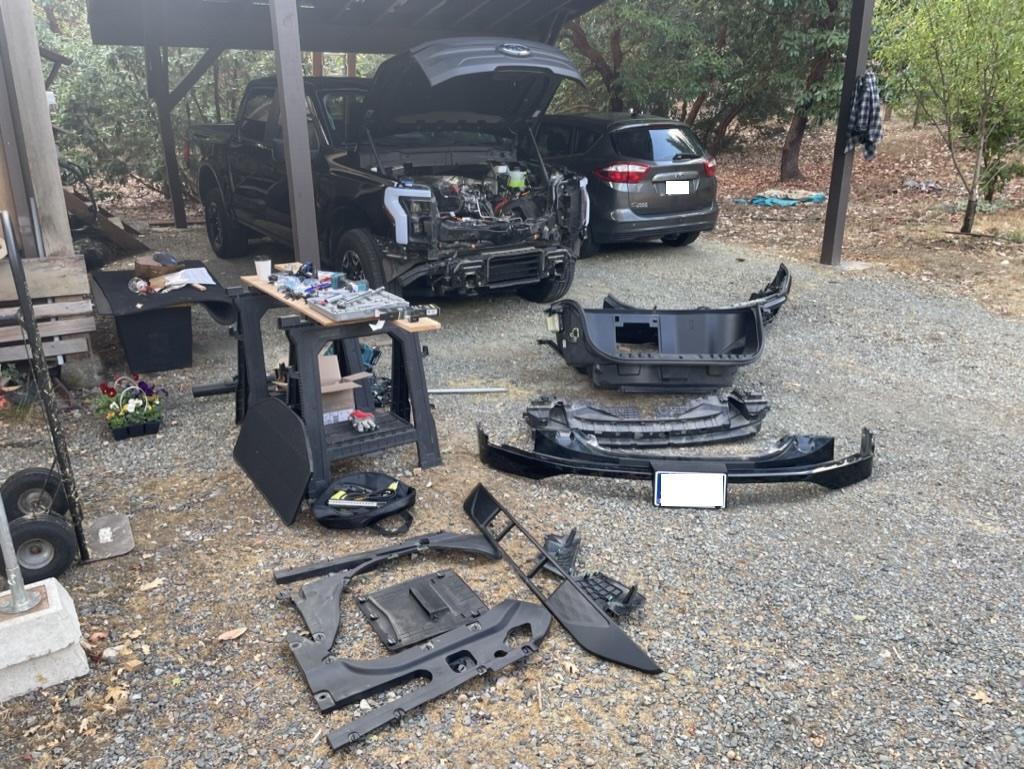

Good news is that it went much quicker the second time! Now that I'd learned how to do it, it only took about an hour and a half to get the radar unit installed and the wiring harness swapped out.
FORScan took me good hour to get working on MacOS (using wineskin and the OBDLink EX adapter), and maybe another hour of clicking around to get all the necessary hex digits in the right places. It freaked me out when the first write caused my truck to reboot and start reporting a bunch of errors, but by the end of the process everything was working perfectly.
I also ran into the same issue that this member had with the CCM unit not appearing until the IPMA was written.
Once it was all working + calibrated, I took it my truck for a spin on a quiet two lane highway and the system performed flawlessly. I was really blown away by the UX of the lane keeping system. For some reason it feels more natural to me than other lane keeping systems I've used. It's not as advanced as some of the other systems out there, but it works very well for my needs.
In conclusion, this mod was completely worth it for me. The addition of Adaptive Cruise + Lane Keeping makes boring freeway driving so much more bearable.
