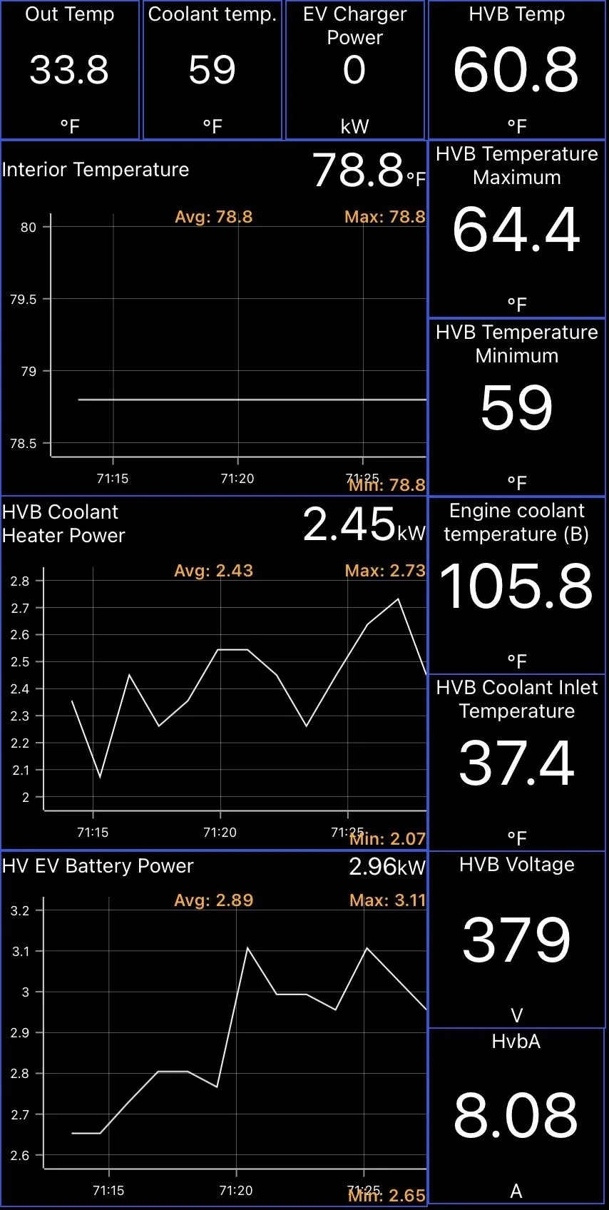

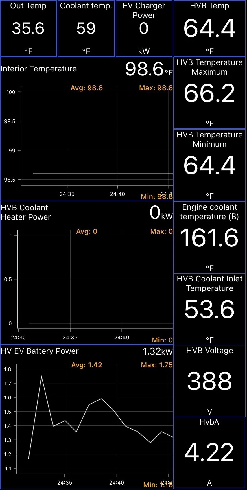

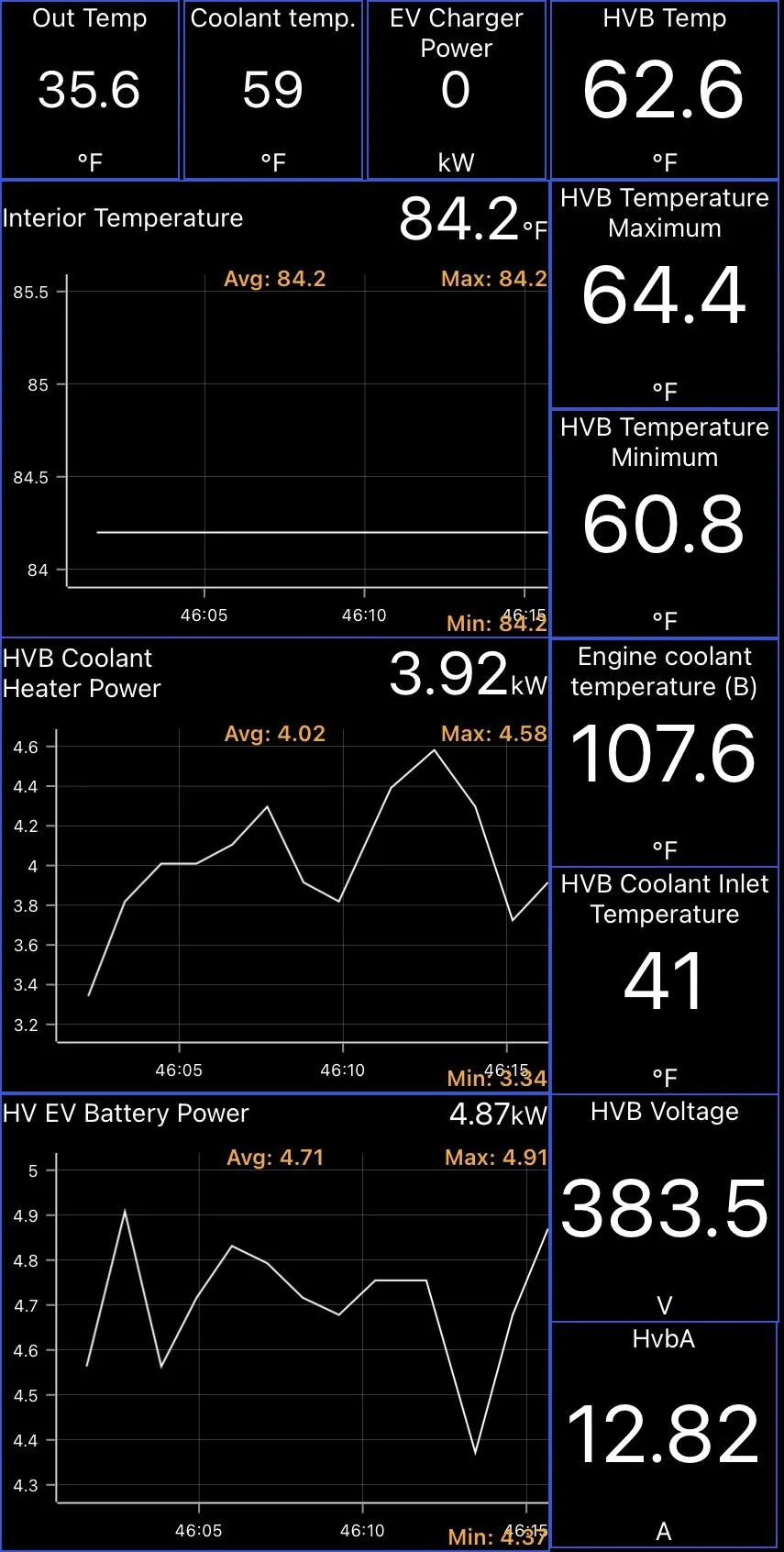

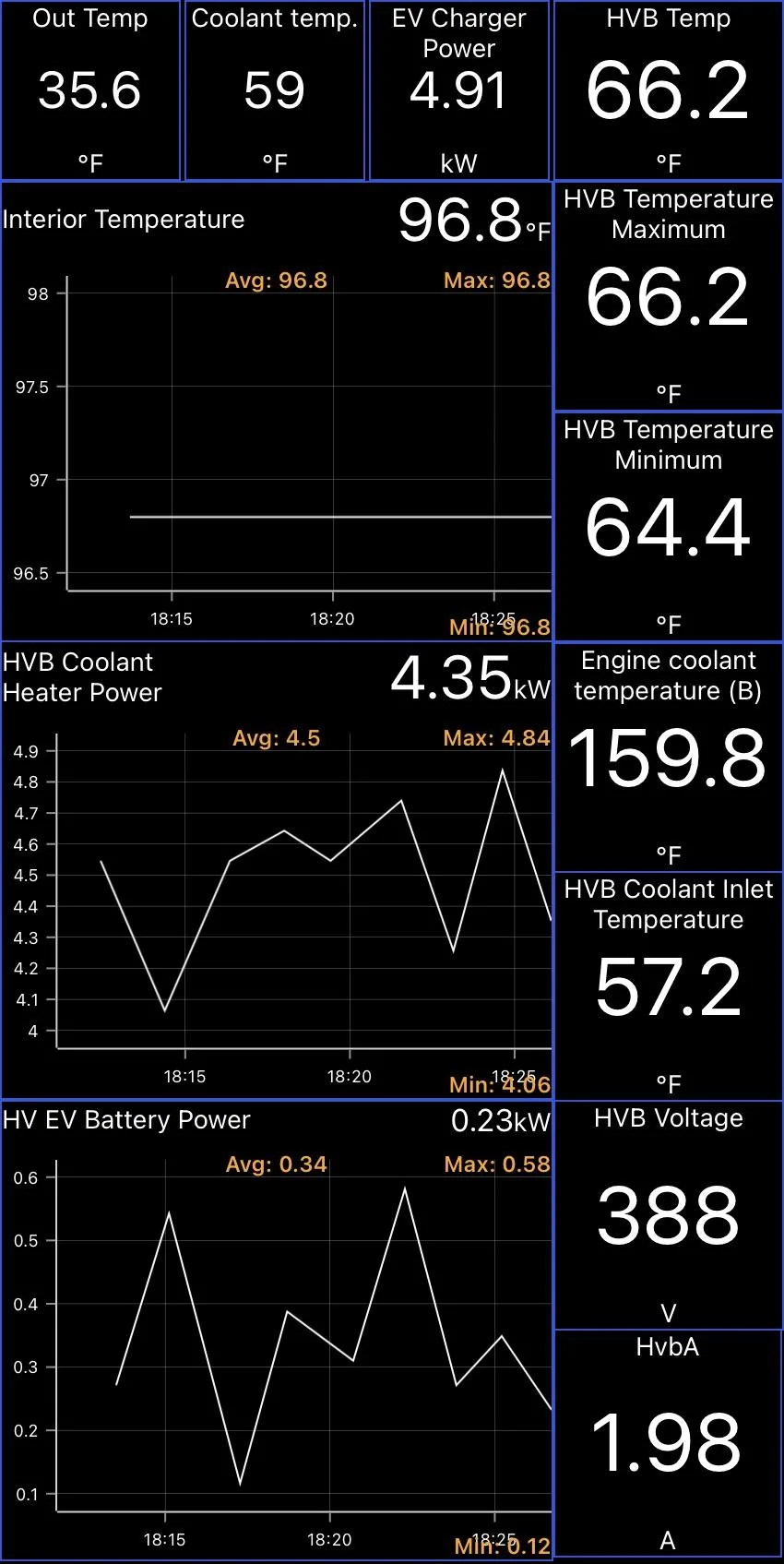

FWIW, some data.
Last night, I set a Departure Time of 0620 hrs for this morning (truck parked outside) after it finished charging to 90% at 2119 hrs.
Unfortunately, CarScanner would not connect to to my OBDLink CX to monitor my truck overnight since it goes to sleep; I missed force powering the OBD up this morning prior to the start of Preconditioning, but I did record data during the last 15 min of the preconditioning and the subsequent drive.
I observed my Battery Temp at 2330 hrs last night to be 32.8 degF…..a little over 2 hrs following completion of the charge session (FCSP set to 240V/80A).
Notes of interest. I have found two PIDs related to Coolant Temperature.. One constantly reads 59 degF regardless of when observed…..it never changes?. The other I’m monitoring achieves temps into the mid to upper ?s at times…..I’m suspecting this PID is taking readings of the coolant loop serving the battery pack…not sure what the other is monitoring……
I preset the truck environmental controls last night to Auto #1 @ 68 degF, Seat Heat @ #3, Steering Wheel Heat ON. When I got in my truck to start driving, I found the environmental controls set to Auto OFF @ 68 degF (Defrost ON - Fan @#3), Seat Heat @ #3 (ON), Steering Wheel Heat ON - No heat.
I manually returned the environmental controls to my presets before the drive; the Steering Wheel Heat never activated.
0619 hrs - Preconditioning in Progress
Ford F-150 Lightning Does anyone have Lightning cold weather preconditioning detail information? DB5EA8E9-A385-4BCD-BF4A-B8C011AD89F9
0625 hr - Preconditioning Completed & Disconnected from FCSP - Before Drive
Ford F-150 Lightning Does anyone have Lightning cold weather preconditioning detail information? 411F0596-DB3A-4C15-BC02-F9898E99196E
0647 hrs - 22 mins into the Drive - 45 mph
Ford F-150 Lightning Does anyone have Lightning cold weather preconditioning detail information? F9DE6B03-5CE6-472B-9048-B8AD6283D003
0712 - Parked at End of Drive
Ford F-150 Lightning Does anyone have Lightning cold weather preconditioning detail information? 55D1FB56-CF80-4E70-8EE3-4E51D8EFABA9

Outstanding information. It is good to see the HVB temperature holding up during your drive.
What is with the Interior temperature reading? Is that actually a reading of a heading element temperature? Certainly the cabin isn't at 96 degrees is it?

CarScanner said the IT was 98.8 degF at the end of preconditioning. Don’t know the specific location of the IT reading, I just picked one of the available interior temp PIDs.
I will say the Defrost blower was cranking and it was uncomfortably hot when I got into the truck….my wife loved it ? The temp did cool, as noted on the subsequent screenshots, with the Defrost OFF as the drive progressed.

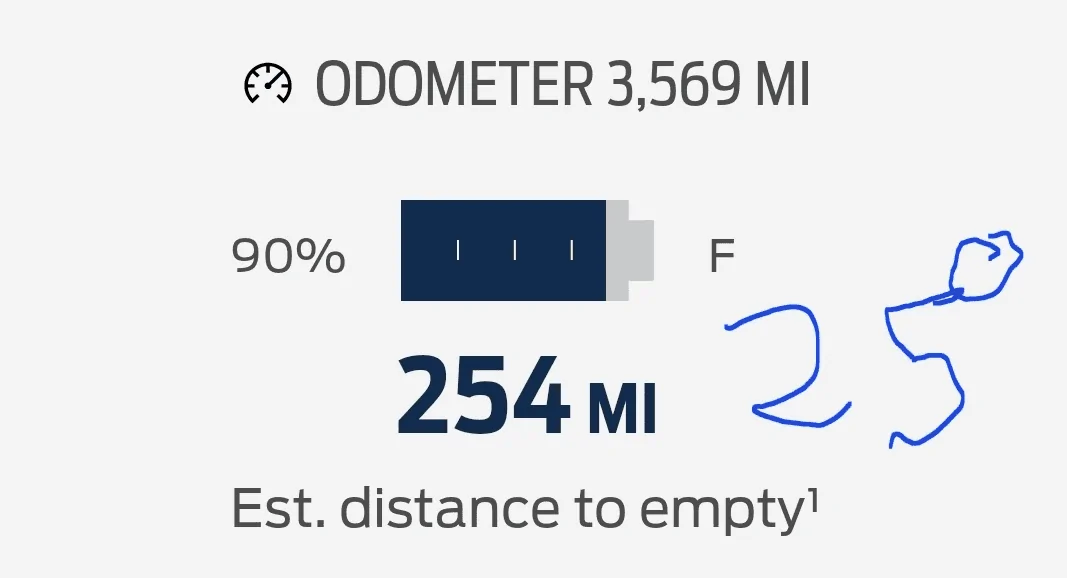

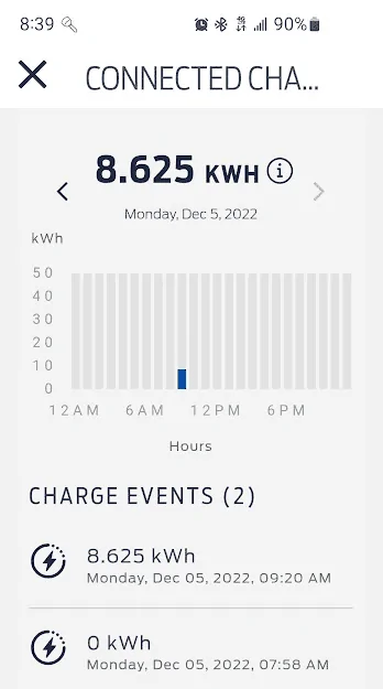

This morning I did a 30 minute session of charging, by clicking the charge to 100%
This was the SOC and Projected range at the time at 25º which has a MPK of 2.15
Ford F-150 Lightning Does anyone have Lightning cold weather preconditioning detail information? 1670278083311

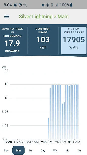

The truck was pulling full rate most of the time except a couple minutes where it slowed
Ford F-150 Lightning Does anyone have Lightning cold weather preconditioning detail information? 1670278178646

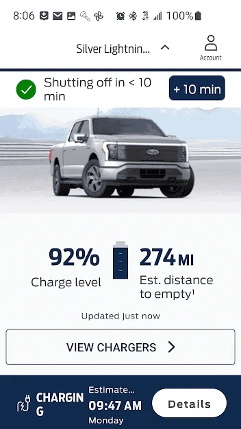

At 20 minutes into the charging session I remote started the truck to warm the cabin.
SOC 2% [2.62kWh] Range enhanced by 20 miles [7.63 MPK] really is the enhanced capacity of the original 90% as the battery slowly warms though charging, MPK now 2.27
Ford F-150 Lightning Does anyone have Lightning cold weather preconditioning detail information? 1670278290938

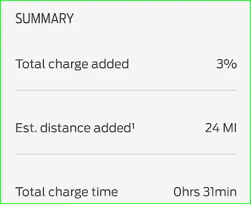

Resumed charging schedule, [stop charging] 8.22 kWh consumed including the 10 minutes cabin warming phase, FCSP data confirms Emporia
Ford F-150 Lightning Does anyone have Lightning cold weather preconditioning detail information? 1670278688654
Ford F-150 Lightning Does anyone have Lightning cold weather preconditioning detail information? 1670278753325
FP charging log, says I gained 3%, 24 miles
Ford F-150 Lightning Does anyone have Lightning cold weather preconditioning detail information? 1670278889474

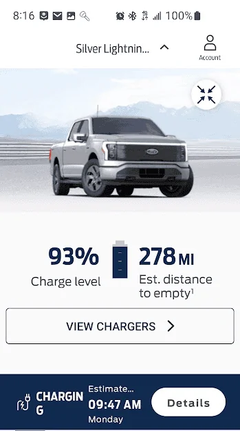

FP predicted range is now 278 at 2.28 MPK

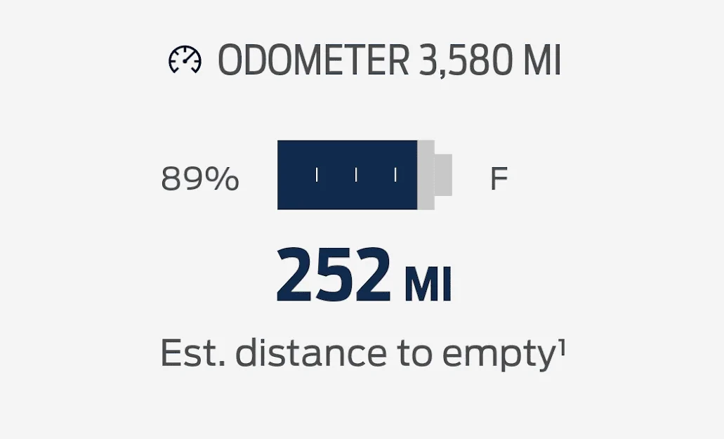

Drive 1.7 miles to first stop,
81 minutes later as the truck has cooled off,
1% and 8 miles dropped from range. MPK=2.22

This evening at 5pm, we're back to same range and SOC with only 11 miles driven for the day in two local round trips, with cabin temps comfortable, at the moment temps are around 45º the projected MPK=2.16
