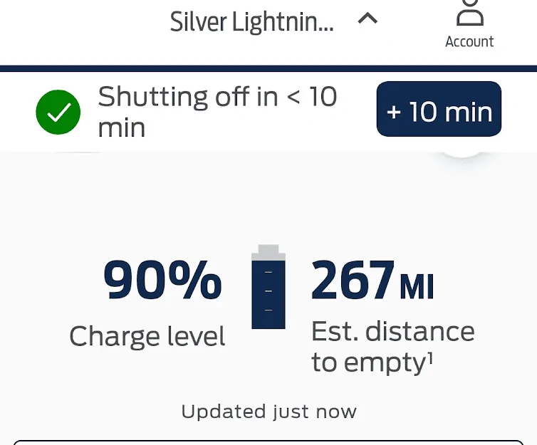

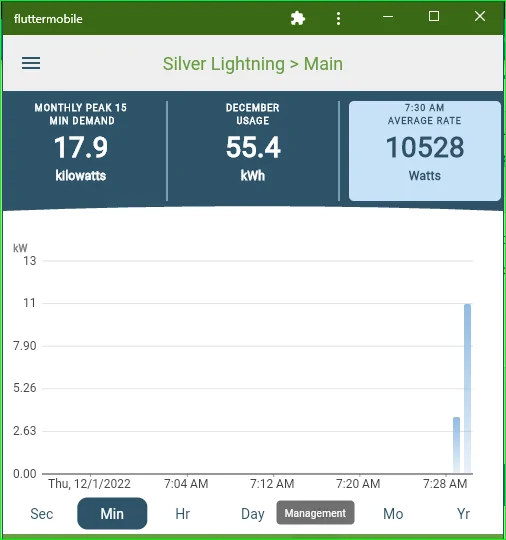

This morning with outside temps and cold garage was 37 degrees. Last night I scheduled a departure time of 8:10 am, the pre-conditioning session started at 7:29, by 7:30 the peak rate of energy consumption was 10,528 watts, but it quickly tapered to a slower pace.

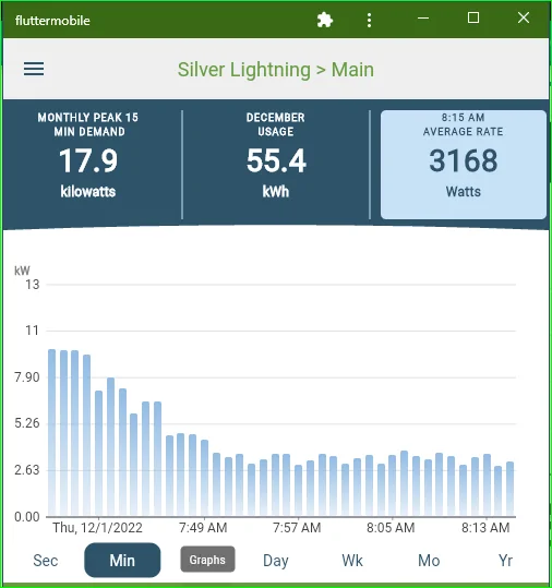

The session ran continuously until I unplugged the truck at 8:15, though Ford Pass alerted me that the cabin was ready at 8:10, I'm not sure how much longer the session would run if I did not immediately go out, need to research the manual or test that concept. I wonder if the 3.168 kw draw rate continues at that pace after the truck is started and HVAC remain in auto mode.
Ford F-150 Lightning Does anyone have Lightning cold weather preconditioning detail information? 1669919811571

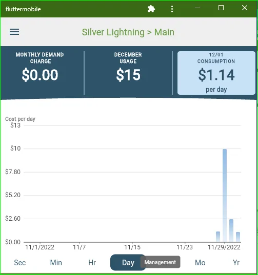

Total energy consumed during that 46 minute session was 4.14 kWh, if this ran they same way off grid, 3.5% of my 90% ER SOC, dropping it to 86/87% . 4140 is about 7 miles at a MPK drive rate of 1.8
Ford F-150 Lightning Does anyone have Lightning cold weather preconditioning detail information? 1669920045350
$1.14 was the cost to precondition for 46 minutes at $0.27 kWh

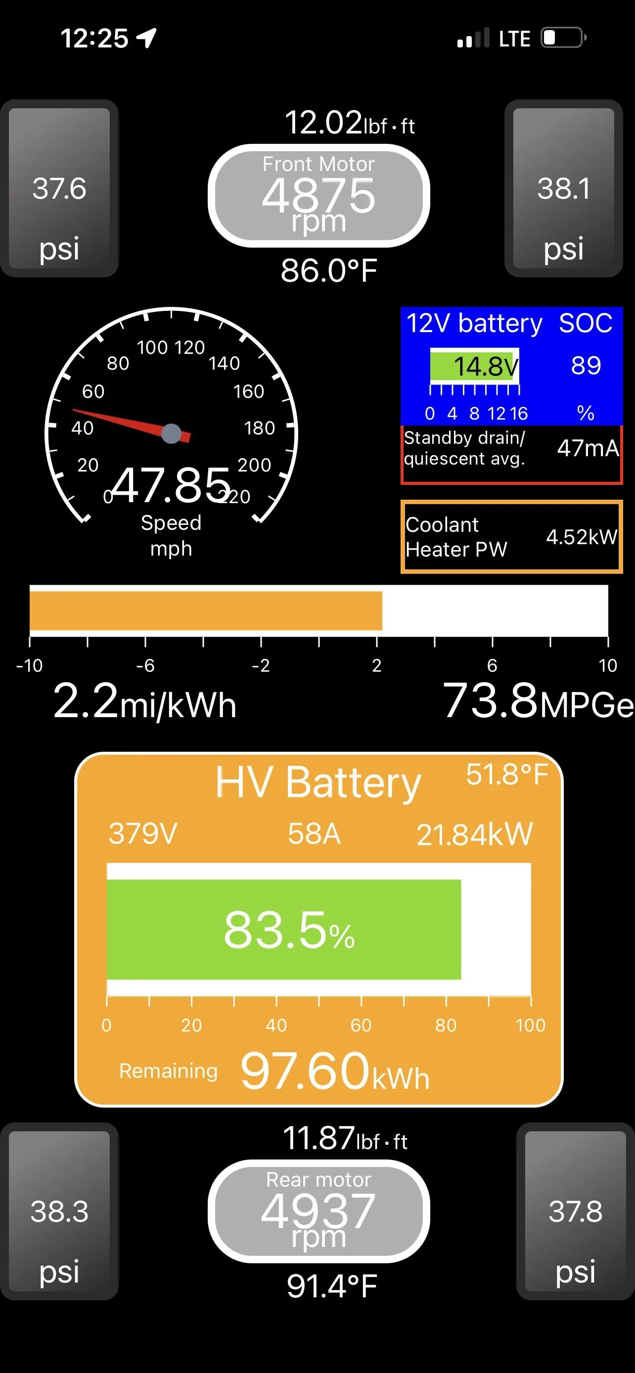

FWIW, I think I have found a way to monitor the Power used by the cabin “E Heat”. The attached screenshots of one of my CarScanner Dashboards were taken ~5 min. Into the final leg home during today’s errands that started at 0800 hrs.
Outside Temp: 41 degF
Interior Temp: Set @ 68 degF/Auto Low
The truck was warm, having been parked ~5 min. before departure following an ~20 min. highway drive.
I started this leg with cabin E-Heat ON….after ~5 min. into this drive I manually shut-off E-Heat and my Dashboard showed Zero Power being used by the Battery Coolant Heater
I manually turned E-Heat back on and Battery Coolant Heater began drawing ~4.5 kW. I repeated this a couple times with similar results, so I’m pretty confident of the ability to measure the the Power draw to heat the cabin.
Next test will have to wait for colder (below 20 degF) weather in January for some good preconditioning impacts….I expect this data will be similar to your results monitoring your FCSP……..
Now that I’ve got the right PID to ext tests will

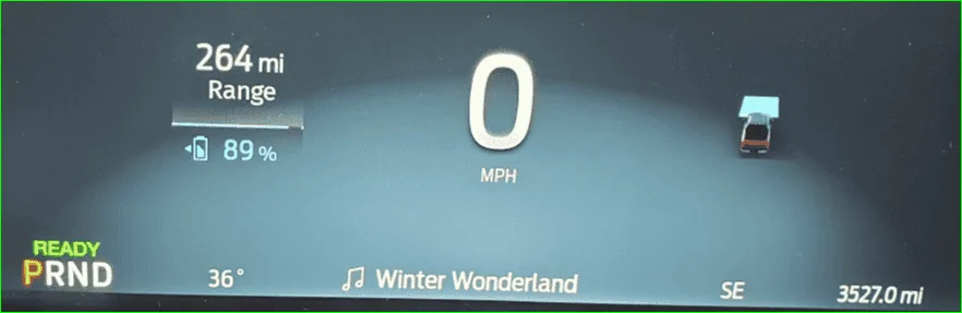

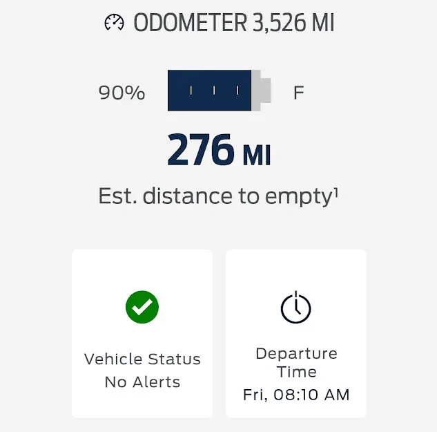

Friday, I will do a standalone departure event, with the SOC starting at 90% from tonight top off charge, looking to see what the startup SOC when we hit the road at ~8:15 am
Thursday evening I charged up and also reset the efficiency driver data to get back to an unrealistic range prediction of 276 miles at 90% SOC, I know this is going to drop back to winter expectations in a few days of non-hyper-miler driving. Truck was in the cold garage but unplugged.

Friday morning at about 34º my truck did not start the cabin conditioning phase until about 3 minutes prior to my scheduled departure time at 8:10, unlike yesterday when plugged in it started 40 minutes early to work on conditioning the battery. Note the range dropped 9 miles at same SOC, cold soaking adjustment is the likely reason.
Ford F-150 Lightning Does anyone have Lightning cold weather preconditioning detail information? 1669998638972
2.26 MPK
Got in the truck around 8:15 so it had about 8 minutes of warming, the heat was on, cabin temp ok, steering wheel and both seats were warm. SOC dropped 1%, range dropped 3 miles.
Ford F-150 Lightning Does anyone have Lightning cold weather preconditioning detail information? 1669998926441
We did our nearby errands and breakfast then headed home, a whopping 6 miles, heat on while driving, then when I parked at CVS & Walgreens, I used accessory mode only while the wife shopped for 15 or so minutes, SOC dropped 3% (3.93 kwh) and projected range at that point was 252. dropped 18 additional miles in addition to the 6 we actually drove, or 1.5 MPK, vs the original 2.34 MPK from last nights reset, or the morning cold soaked condition of
Ford F-150 Lightning Does anyone have Lightning cold weather preconditioning detail information? 1669999406184
2.21 MPK
I won't trust these ranges for a few days until the real numbers settle in.
Conclusion at the moment is as several experienced posters have said, full battery preconditioning is not happening while unplugged, only cabin heating/seat/steering is occurring.

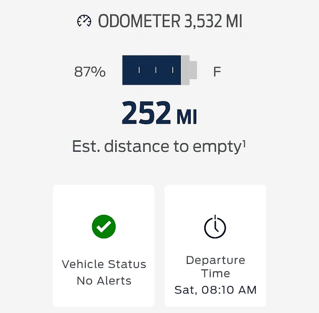

2.34 MPK
2.26 MPK
We did our nearby errands and breakfast then headed home, a whopping 6, heat on while driving, then when I parked at CVS & Walgreens, I used accessory mode only while the wife shopped for 15 or so minutes, SOC dropped 3% (3.93 kwh) and projected range at that point was 252. dropped 18 additional miles in addition to the 6 we actually drove, or 1.5 MPK, vs the original 2.34 MPK from last nights reset, or the morning cold soaked condition of
2.21 MPK
