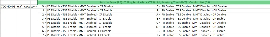

I've seen this topic come up many times here and in the Mach E forum. I am not sure if I have mentioned this before, but there is a setting in the APIM config called "Comfort Pet" which is disabled from factory. Somebody with FORScan would need to turn this on, look through the touchscreen for a new button and turn it on and thoroughly test what this does before trusting it.
Tried that a while back for giggles and didn't notice any new toggles or anything

What year Lightning do you have? Earlier Lightnings require the vehicle to be on during PPO operation. You have to turn off climate control or the HVAC will run continuously the whole time PPO is operating.
You can enable it after one of the recent OTAs if you have forscan. Will shut off if it's not drawing 100w+ at least every few minutes.
