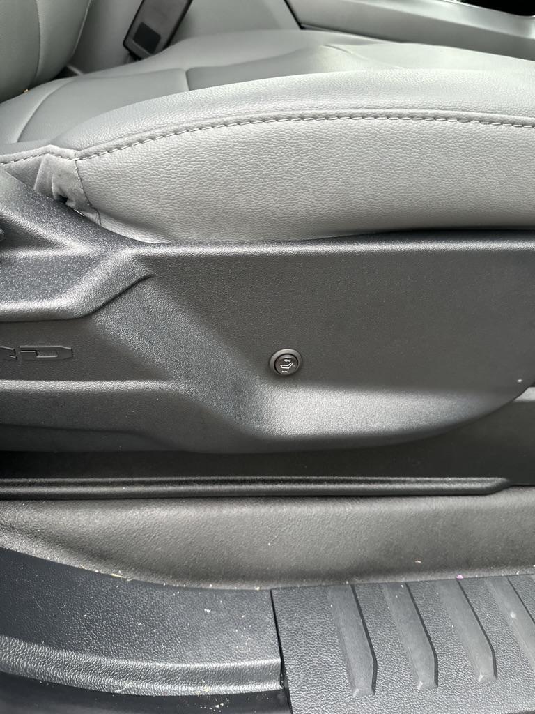

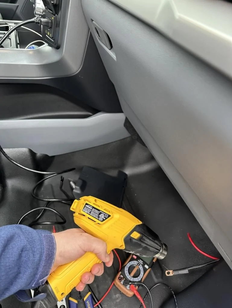

I just landed the switched on the side of the seat. I didnt see an obvious place to land them on the dash or center console. And this way if I ever swap the seats with powered seats that have OEM seat heaters, I won't have two holes in the dash.
I ordered these fuse taps off amazon. I am glad they came with spare fuses, because I couldn't get these micro2 fuses out without destroying them.
https://www.amazon.com/dp/B081SS7ZLF?psc=1&ref=ppx_yo2ov_dt_b_product_details
Took me probably 2 hours to do the first one, and 30 min for the second. Then another hour to figure out which circuit to use and wire them in. It was really nice to be able to use my heat gun right from the truck. I did cut the first one (passenger side) a little to allow for some of the velcro and snap fasteners from the seat cover. But on the drivers side I just put it in as is and the cover fits and sits there just fine. Less than $100 all in and very happy with it. Only problem is to make sure the passenger turned theirs off when not in use.

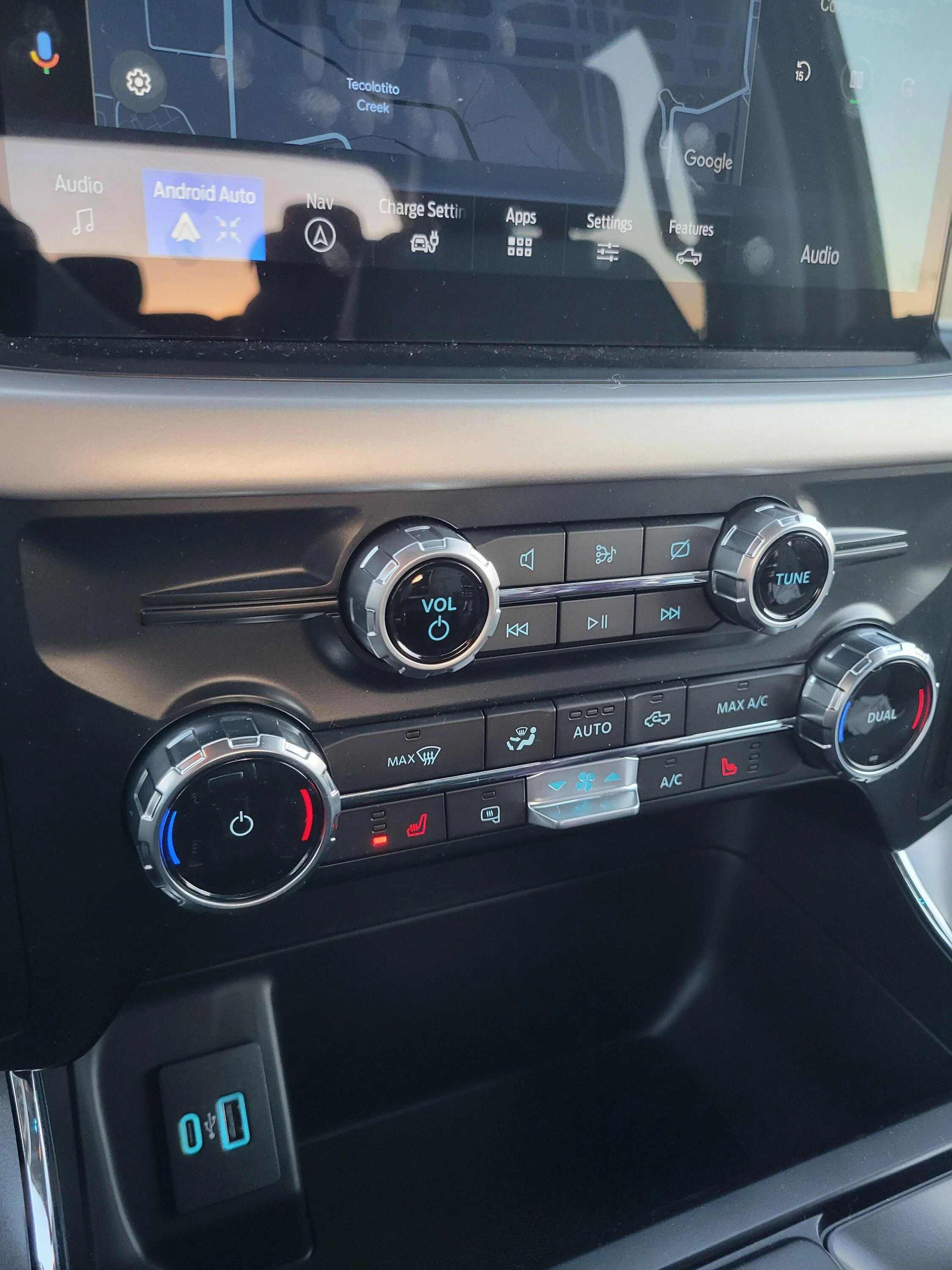

Your pro doesn't have heated seats? My 2023 has them. Was it an addition for MY2023? Must be why they raised the price by 40%
What does your HVAC control look like? Is there a physical button for turning on the heated seats?

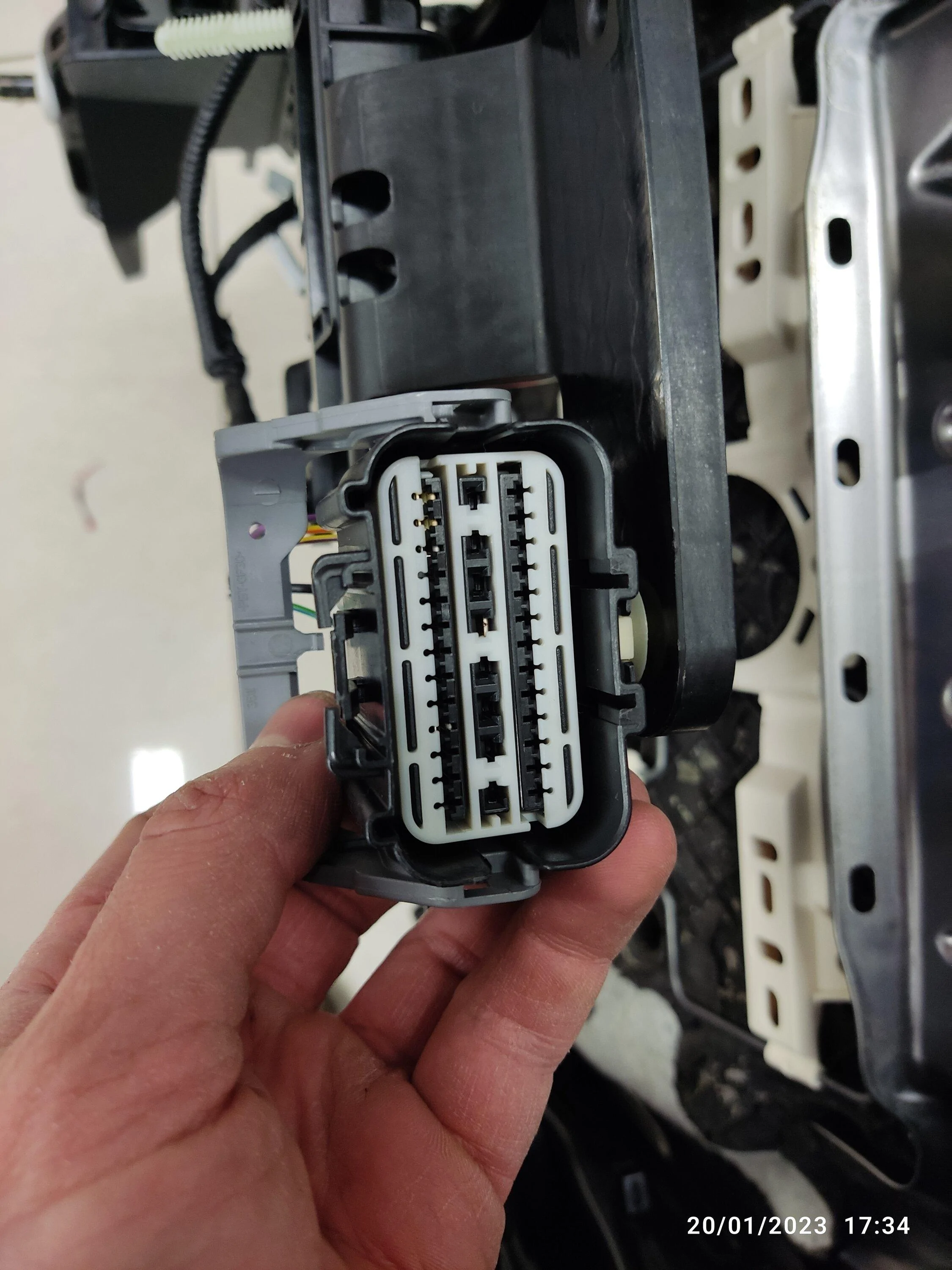

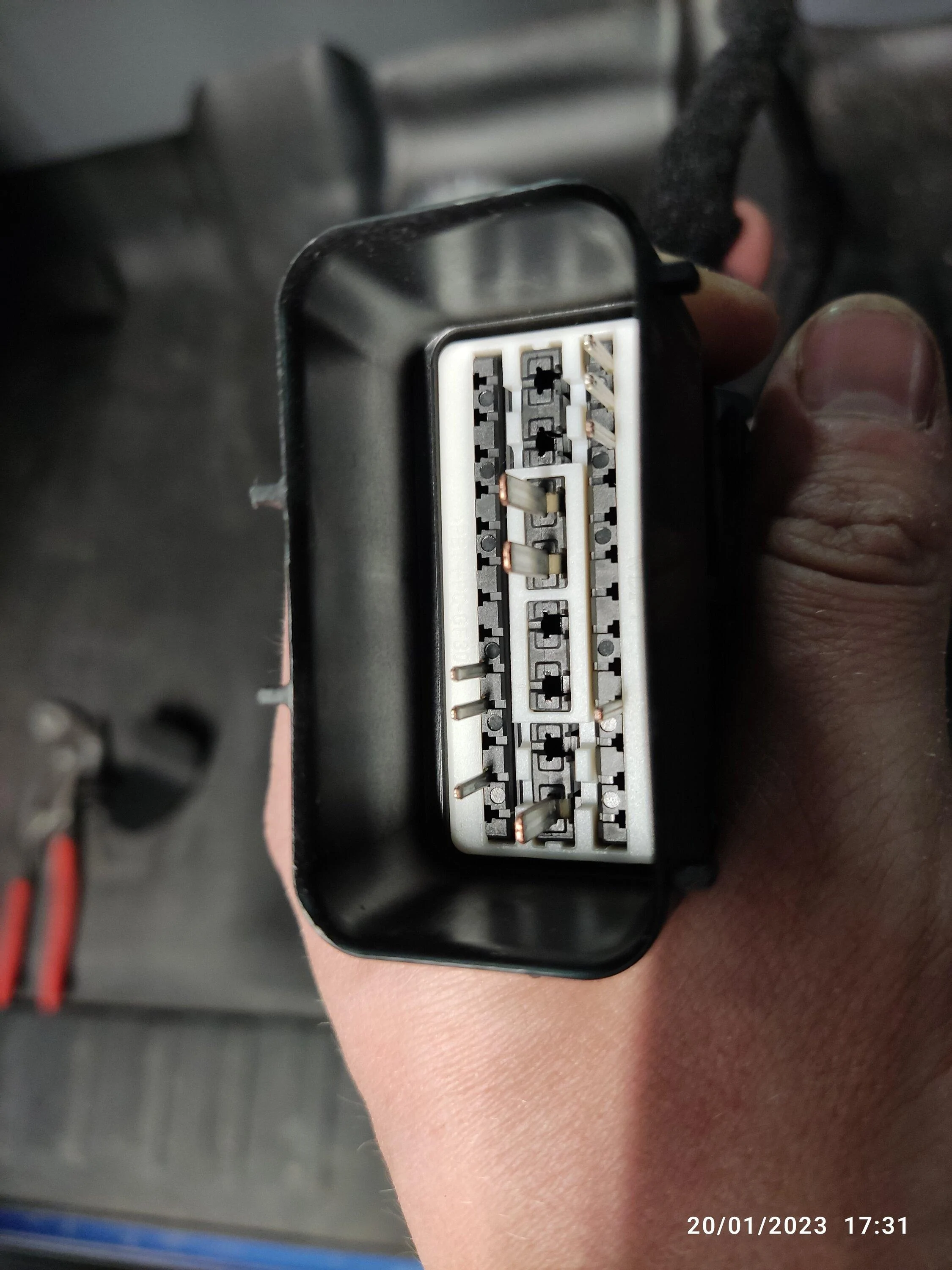

Do you know what the extra pins are for innthe connectorsnfor the seats? Maybe for heated seats? :) ? Would be nice to get the power from there... There qre only 5 wires in the connector on the seat but 10 on the car side wich of 3 are thick for higher current, and only 1 thick used on the seatlooks like ground wire.
