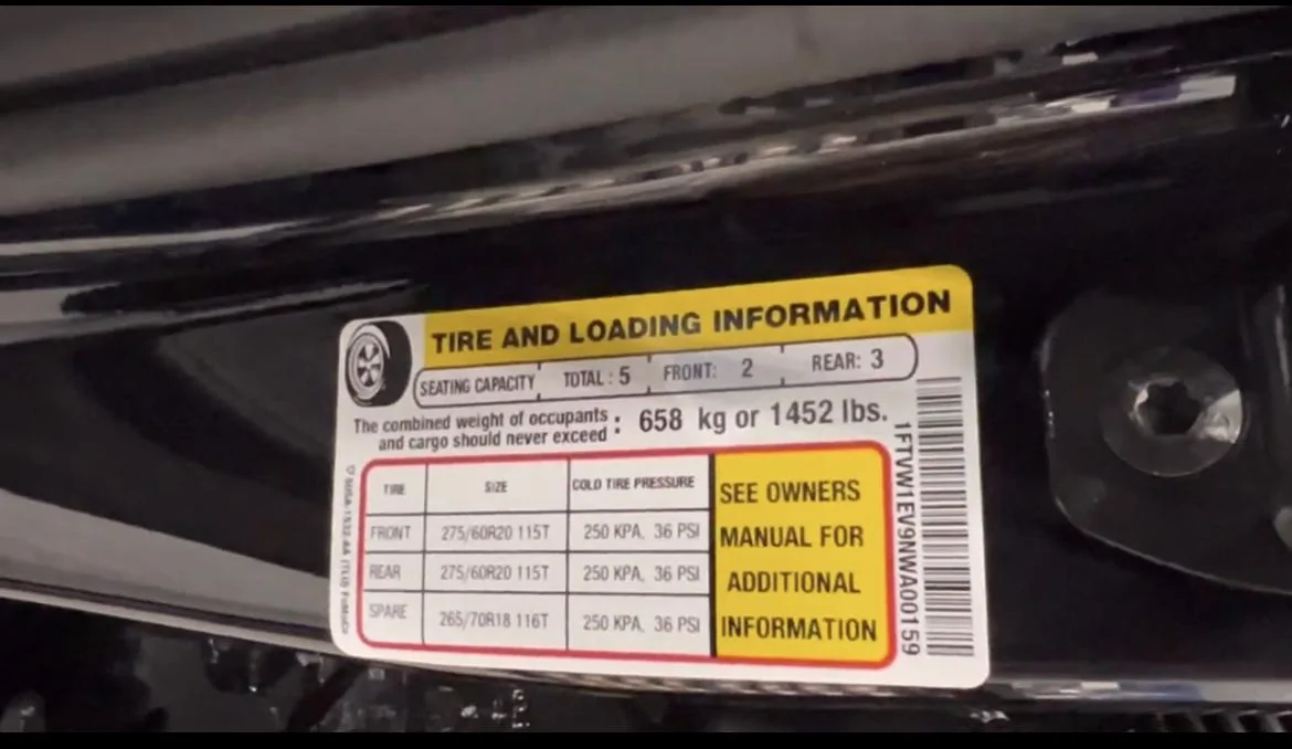

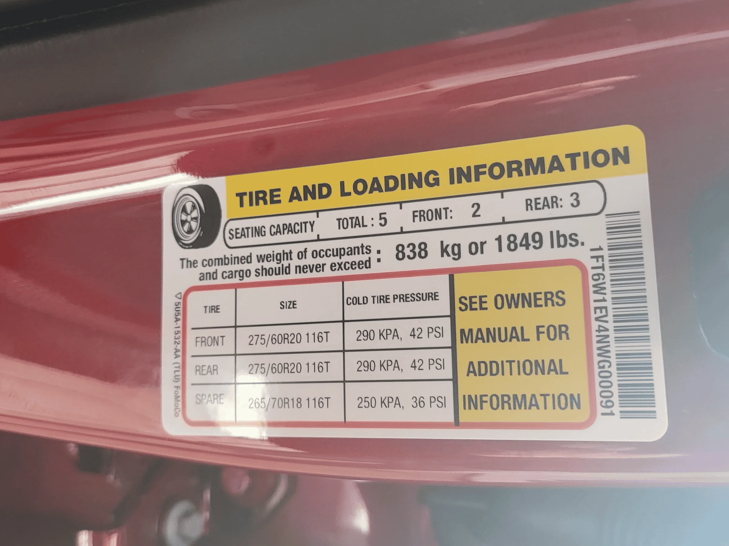

Here is mine:
I have AT tires and spray in liner (Lariat ER). Maybe I should of chosen the all season.
Ford F-150 Lightning Door Sticker Thread (GVWR / Payload / Tire and Loading Figures Label). Help and Add Yours! 20220709_063109

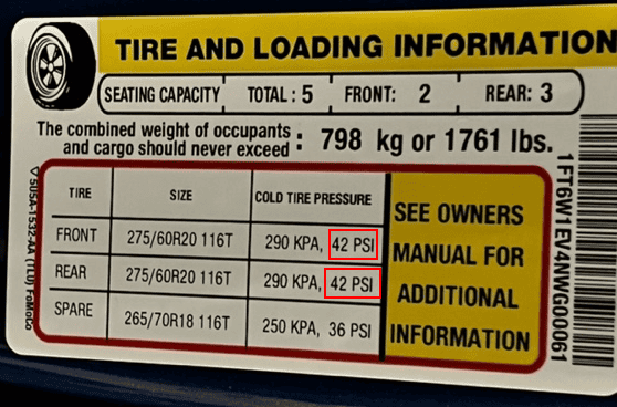

What I am I missing about the Lariat ER that makes its payload much lower than some other extended range models?
The All Terrain tires reduce the GVWR and therefore payload by 150 pounds. For some reason the All Season 20” tires get a 42 PSI rating where the All Terrain get a 36 PSI rating and the lower GVWR

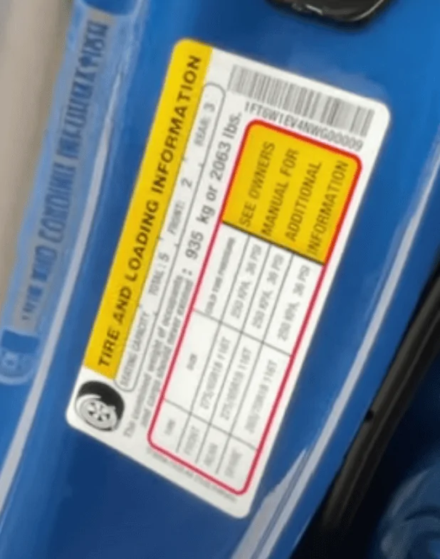

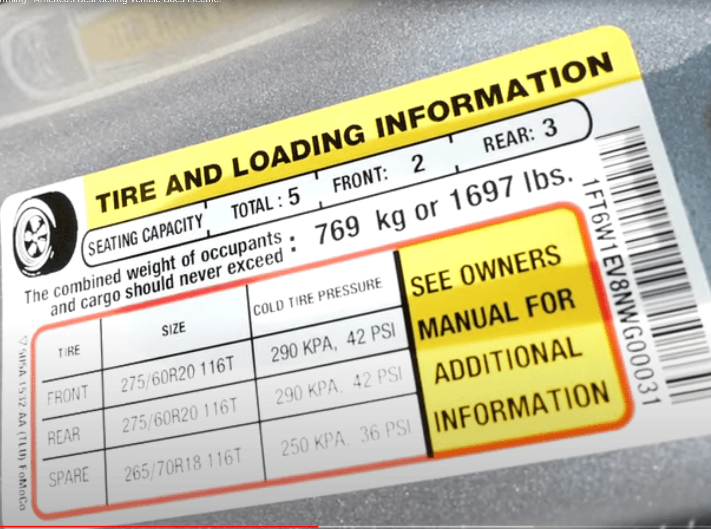

2022 Ford F-150 Lightning XLT Standard Range (312A)
20" wheels, Max Tow, factory Spray in Liner
Ford F-150 Lightning Door Sticker Thread (GVWR / Payload / Tire and Loading Figures Label). Help and Add Yours! 20220725_211820

interesting how your spare is only a 18" wheel, while your truck's wheels are 20's

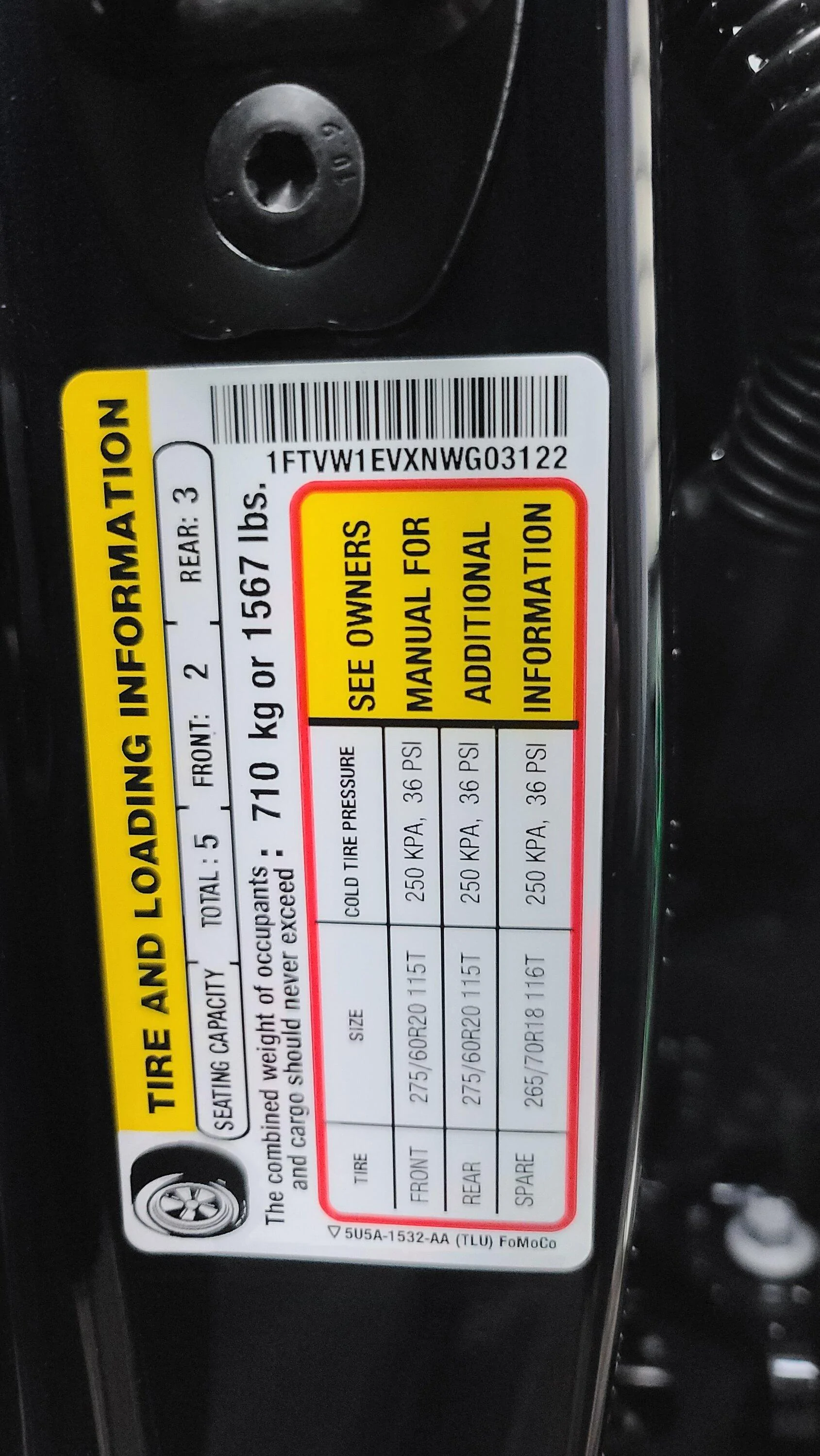

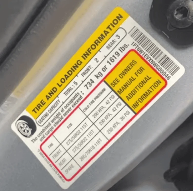

My XLT SR with Max Tow, Tow Technology and spray in Bedliner arrived today. Here is the window sticker for it. GVWR is 8250.
Ford F-150 Lightning Door Sticker Thread (GVWR / Payload / Tire and Loading Figures Label). Help and Add Yours! 1660350251361

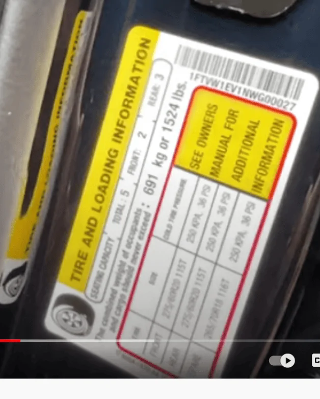

Compare to my Dealers Mannequin unit a Lariat ER with All Season Tires, Max Tow, Tow Technology and spray in Bedliner. GVWR is 8550. Nearly 300 pounds lower payload capacity.
Ford F-150 Lightning Door Sticker Thread (GVWR / Payload / Tire and Loading Figures Label). Help and Add Yours! 1660350357650
