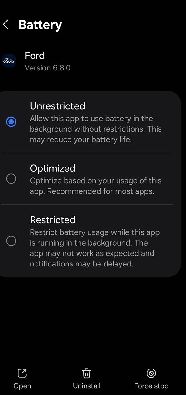

Make sure the battery usage feature (Androids) is set properly to UNRESTRICTED
Ford F-150 Lightning Doors delay unlocking when near truck 1773499617957-ed
