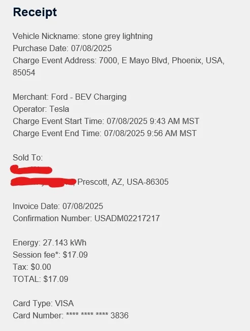

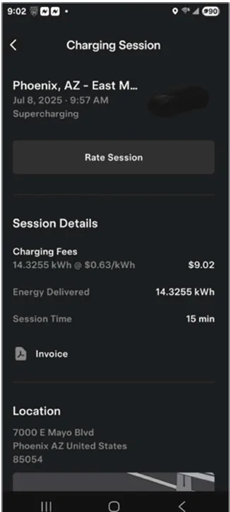

Ok, here are my receipts: Note the time of 9:57 and 9:56. I did not start a session with plug and charge. it has never worked, it always give an error. Hence I moved on to the tesla app.
You are right with my math error. the charges are the same per Kwh. I will edit post on that.

Those are two unique sessions.
The Ford session ran from 9:43 - 9:56.
The Tesla session STARTED at 9:57 and ran for 15 minutes.
In FordPass charging history, you SHOULD (assume it capture both sessions) see TWO charging sessions, the first delivering 27kWh (a ~20% change in state of charge), the second delivering about 11%, for a total between the two of around 31% charge.
I am/was confident that the tesla receipt indicates the end time of a 15 min session. So you are saying I did 2 successive sessions totaling 41 Kwh. I find that hard to believe given the time I was there and the state of charge going in but I have no proof to argue that. none the less, something is wrong as all I was getting was errors when plugging in with plug and play. I am not going to do that at tesla stations anymore. Works fine at EA stations.

Did you going into FordPass, Energy, and pull up the charging history? That would show it.
I am confident that the Tesla app indicates the START of the session. I record my trips on log sheets. I write down the time I stopped, the charger location, energy, ... and the minutes of charging. That start time is the same (within minutes, I start the session 1-3 minutes later) as the Tesla app indicates.
If you open the Tesla app, and activate the session, and then plug in, and the Tesla session FAILS, then Plug & Charge can take over. If you plug in, Plug & Charge takes over, and then if you try to activate with Tesla, you cannot, because that charger is in use.
Safest is to turn off Plug & Charge on a trip where you aren't going to use it. Given that it's no different (cost wise) than activating the session with FordPass (just saves seconds), I leave mine off now.
Absolutely, the time shown on the Tesla receipt is the start time. I keep a Google Spreadsheet of all my charge sessions (103 so far). I just checked the charge times in the Tesla app and compared that to the start and end times from my spreadsheet for every single SuperCharger session. In every single one, the time listed on the Tesla app is the start time. Note BTW, if you just plug in and therefore use Plug and Charge, the Tesla app does NOT list the session at all.
Alright, lesson learned. If they were successive charging sessions I just have to figure out why the truck keeps throwing errors even though it actually was charging when using plug and play. Actually I am just going to leave plug and play off for no on.
