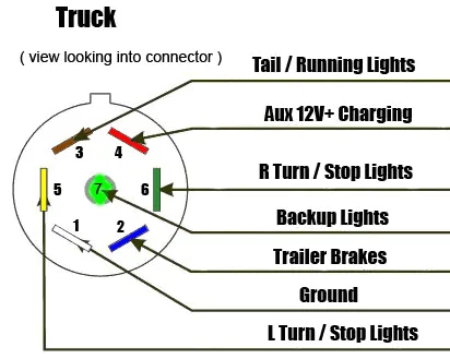

I have these OPT7 running board lights installed, and wanted to see how the turn signal lights would look. but I have no idea which wire to tap into on the taillights to give them power when turn signal is on. Anyone know?

I would tap into the wires that run to the trailer lighting socket.

any idea which one of those wires would be turn signals? i assume there would be one for left and one for right

Left, right, running lights, ground. I would find a trailer and jump from trailer to truck, one pin at a time, til you find the one for trailer running lights.
3,128
4,491
I think it will still light up on braking. Can’t get turn signal only.

Keep in mind that if the truck detects a load on the trailer harness wiring, it will disable rear safety sensors and display "towing" range. At least it did with the y harness I used that came with the led lightbar I tried to use.
