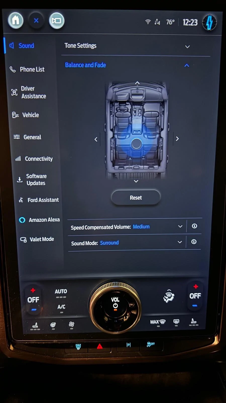

My drive mode page “Controls” in vehicle settings seems to be missing from the menu. I can no longer see any of the drive modes available to select and I also can’t turn off One Pedal Mode if I need to?
Any ideas?

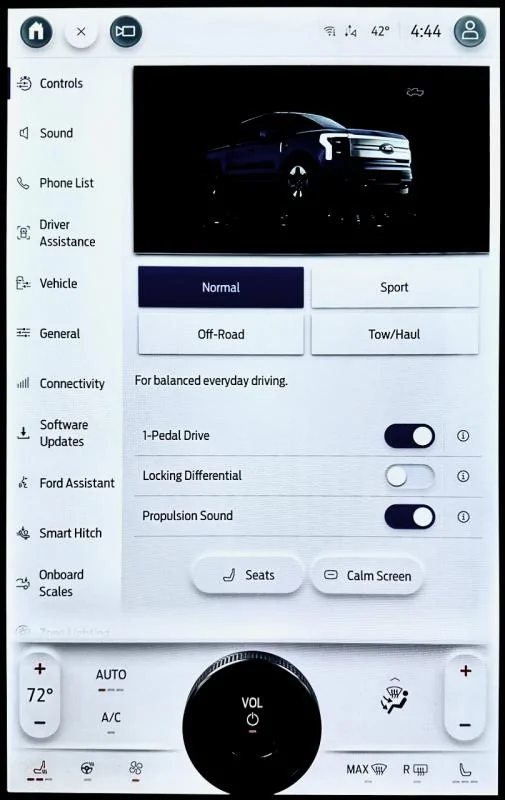

What it should look like…

Are you sure it just isn’t scrolled off the top of the page? Can you drag the left column down?

Try rebooting the Sync screen, hold the Volume down and Next Track buttons for ~30 seconds or until you see the screen flash off.
