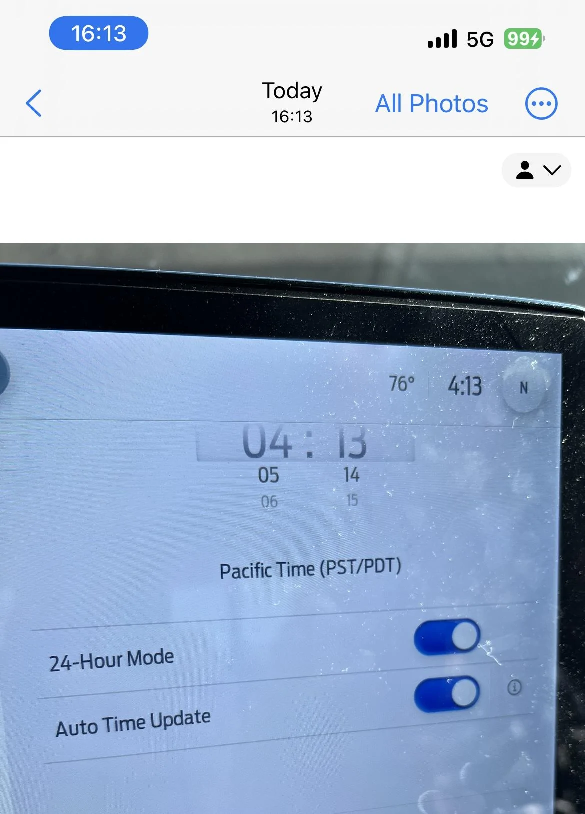

I take it back. I noticed the problem, again, yesterday. This is after receiving the Ford Power-Up update for "Improved DC Fast Charging."
Ford F-150 Lightning Sync 4a Bug: 24 Hour Time IMG_4195
240
17,083
19,454
I too have this issue. It says, '24 horu clocke enabled' but it displays a 12 hour clock. Given Ford knows about this problem, why can it not be fixed? What's so complicated?
