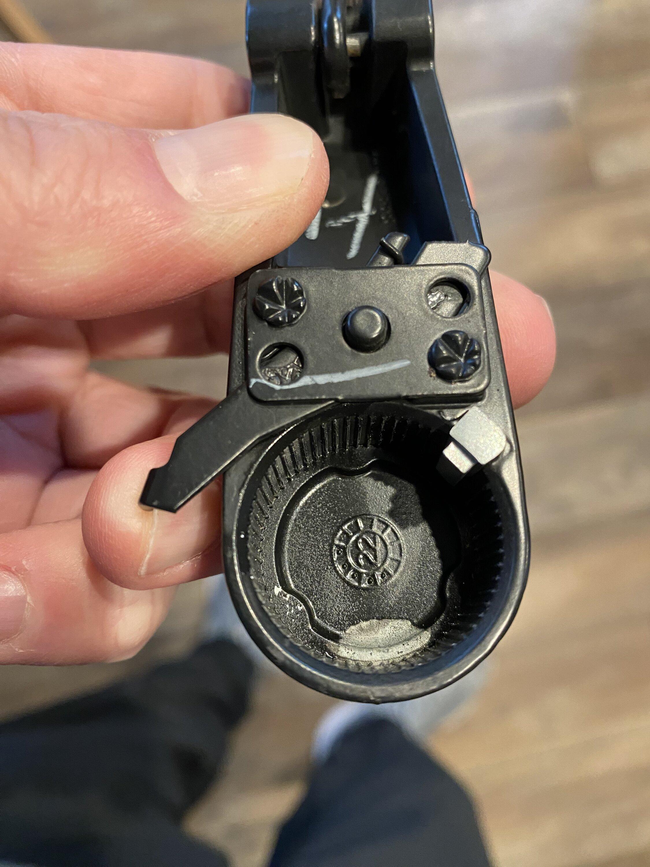

If you go pull your wiper off like noted above by pulling that tab and then lifting it off of the splined shaft you can see where there once was a "key". This key is used by the factory to get the wiper on in the correct position. Many of those keys fall out after installation and they get lost and are truly not needed, until you are ready to pull and then put the wiper back on again. My Ford technician actually had glue with him and glued the key back into the wiper arm so it would align properly and wouldn't get lost.
You just need to pull the wiper, look for the keyway on both the shaft and the wiper and better align the blade a little "lower". That way when you turn it on, it doesn''t travel quite so far to the pillar. It is likely only off rotation by one or two splines.
Take a look, fix it, and save yourself the hassle of having to visit an already incompetent dealer who didn't put it back on right the first time.

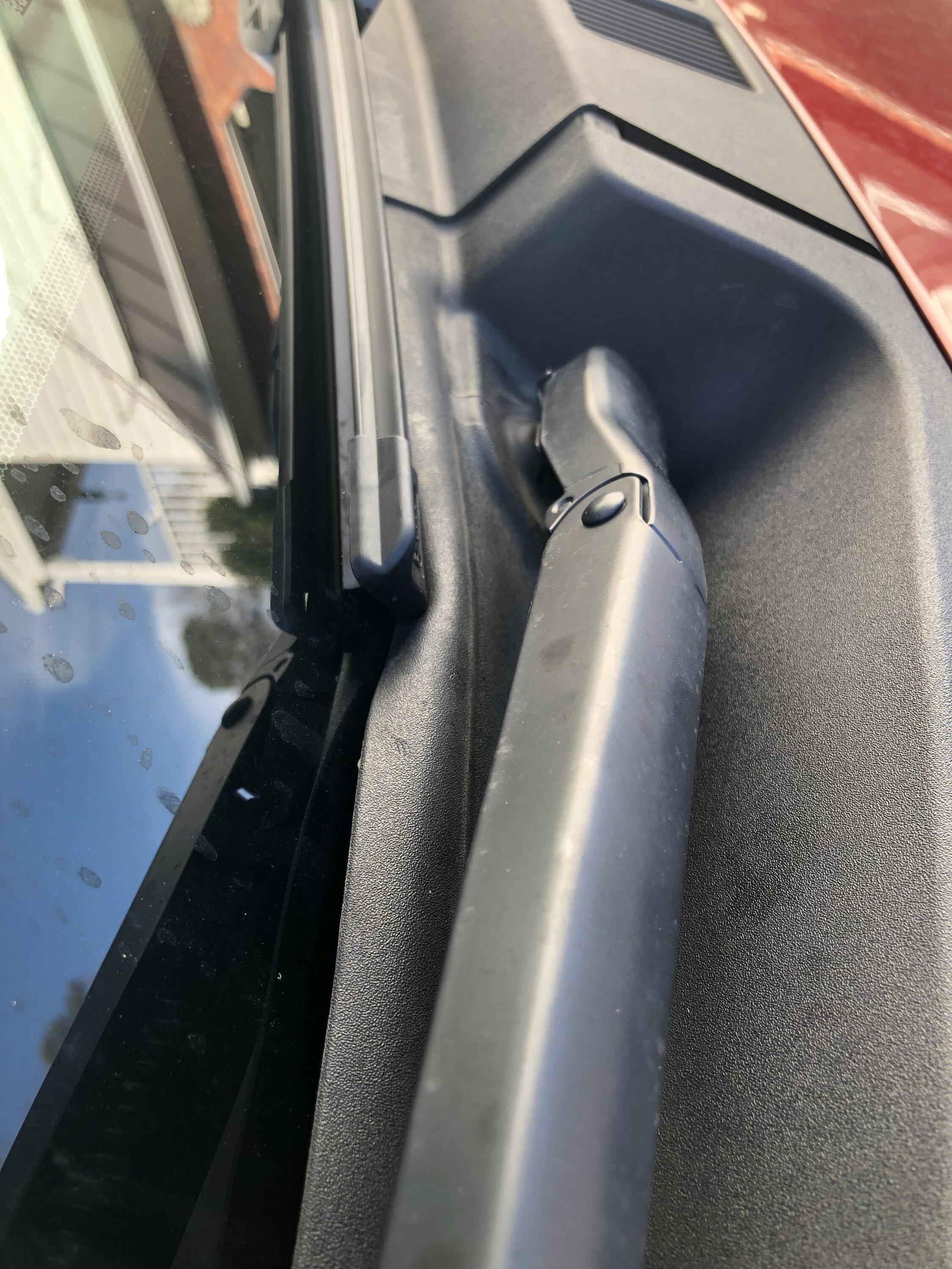

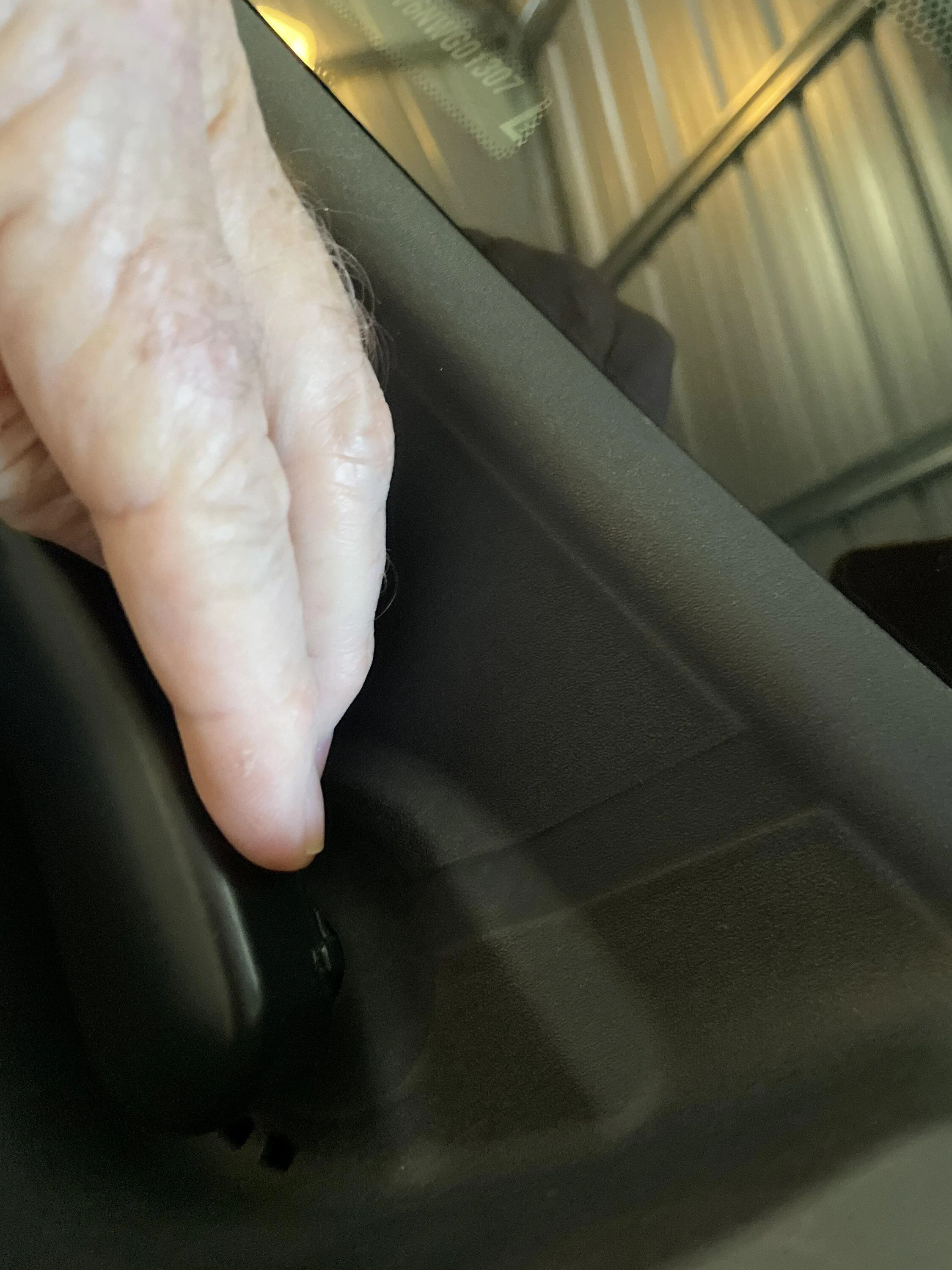

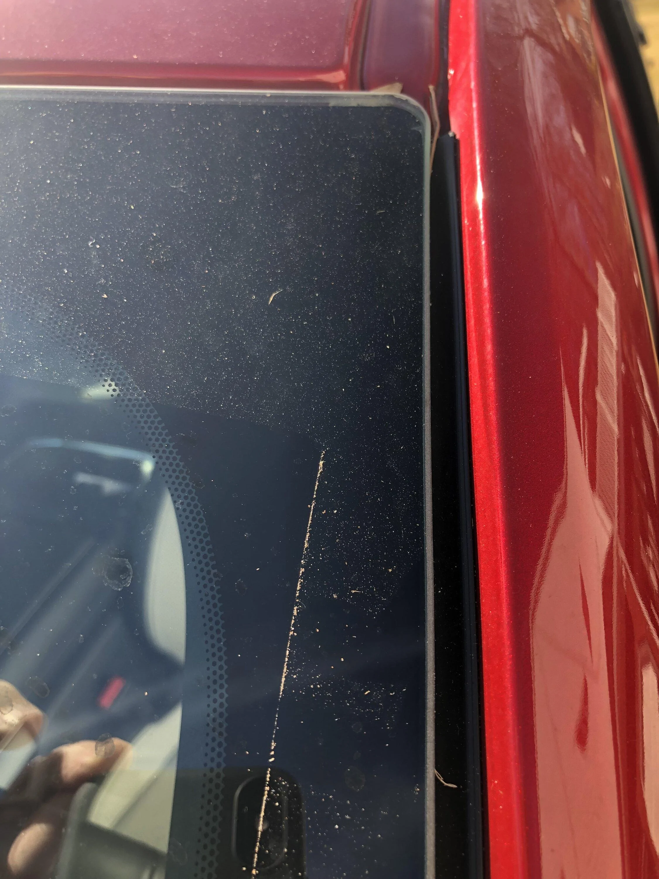

I had the opposite problem. My driver side wiper blade was parking on top of the rubber trim at the bottom of the windshield (Wiper Before Reset photo). I moved the wiper arm one notch on the splined shaft and got clearance from the rubber trim (Wiper After Reset photo). I still have a little clearance at the A Pillar per dust "test" (Wiper After at A Pillar photo).
I have had the Wiper Motor Replacement Recall completed, so the wiper arm may have been incorrectly positioned then. I have no record of the position prior to the recall work.
A few notes on wiper arm removal and re-installation ... the tab on the locking clip swings out away from the wiper arm base (radial to the shaft) and you may need a small straight blade screwdriver to move the tab; it works best to raise the wiper blade up and off the windshield to remove and relocate the wiper arm; when re-installing the wiper arm push the arm fully down on the splined shaft until the locking tab returns up tight against the arm base.
Ford F-150 Lightning Driver side windshield wiper hitting A pillar Wiper Before Reset
Ford F-150 Lightning Driver side windshield wiper hitting A pillar Wiper After Reset
Ford F-150 Lightning Driver side windshield wiper hitting A pillar Wiper After at A Pillar

I just went out and got mine fixed up, after the wiper motor recall was done, the key must have fallen out and was dropped into the plastic molding below. Took about two minutes, a small dab of grease to hold the key in place, good to go. Thanks to those on this thread for the help!
Added a photo here for anyone else with this issue, showing the key/keyway.

bumping this again, I don't see a way to adjust the wiper arm with the key in place. Is the solution to remove that metal piece above and just reposition it without it in there? Does that serve any purpose other than initially lining it up?
3,799
4,913
Using the key in place should put the wiper right where you need it. If yours truly isn't then maybe try removing the key and realigning your wiper. The key is strictly there for alignment at the factory and many of them fall out and get lost. So readjust to make yours park correctly and to just stay off of the A pillar when wiping.

with the key in, it's hitting the A pillar when at high speeds. They probably misaligned it after the wiper motor recall. I'll pull the key out and put it a few notches lower.
