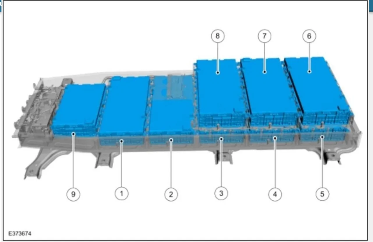

Think about where some of the battery modules sit and maybe that would present some problems?
Ford F-150 Lightning Dump bed possible on Lightning? 9 battery modules
