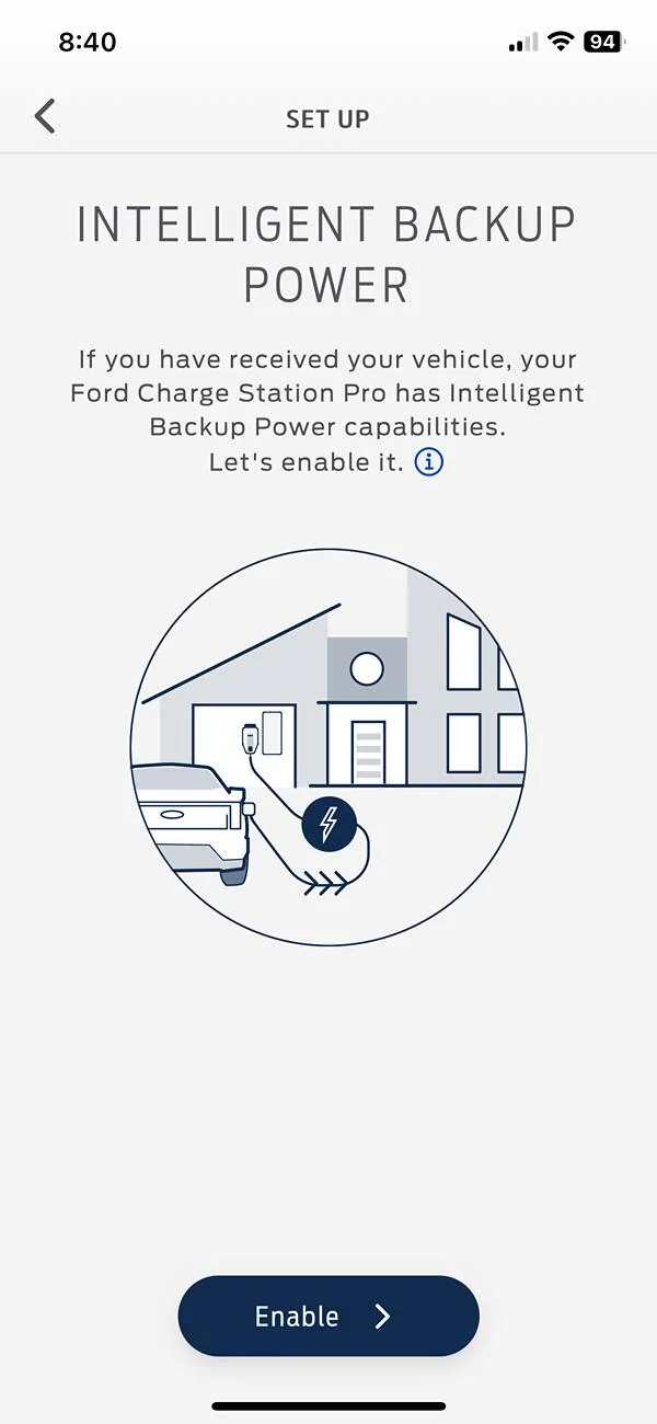

I have now been able to enable/activate the system. However, so far it seems like I have to “”re-pair” the truck each time I want to test the system. The problem there is that the ChargeStation Pro and my phone (and maybe the truck) must all be connected to my home WiFi, the router/modem for which runs on house power, to re-pair & start power transfer. If power’s out, I would then have to plug router/modem into a Jackery or something to get the system going.
If anybody has a solution/work-around to this, please let me know. Thanks!
Once the truck is paired (shows on the truck screen) you should never have to re-pair again. Also WiFi is not needed for the system to work. It is just Bluetooth between the truck and the charge station. Something is not correct in your operation.
why do you think you I e to keep re-pairing the Bluetooth. Can you describe exacltly what is going on?
