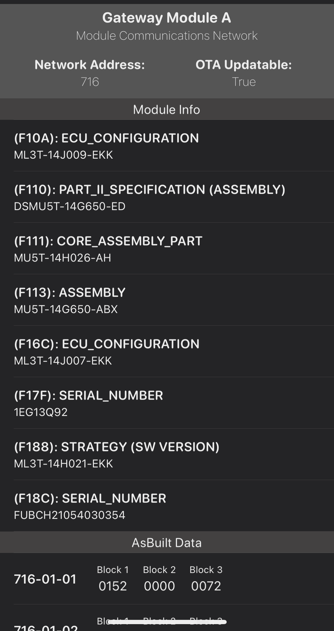

I'm using the Mongoose. I updated it again and it cleared it up. My GWM has a hanging update that wont go away. Files all seem to be the same everytime. Who knows.
<F10A>ML3T-14J009-EAJ</F10A>
<F110>DSMU5T-14G650-EC</F110>
<F111>MU5T-14H026-DA</F111>
<F113>MU5T-14G650-EAF</F113>
<F16C>ML3T-14J007-EAJ</F16C>
<F17F>1EG1CC0V</F17F>
<F188>ML3T-14H021-EAJ</F188>
<F18C>FUBCH21224031180</F18C>
<F190>1FTFW1RG1MFC28185</F190>
Maybe your last network scan to clean up node F190 will kick up a fresh report to the Ford server and finally clear the update offer from the queue. Sometimes it takes a day.
Jeb
Is the F190 field supposed to be in all the GWM? Mine doesn’t show my VIN or F190

Jeb
I’ve always seen it. Try doing a new network scan and see what it does. This is odd and I have no answer other than perhaps the last scan you did didn’t report everything up to the server.
I also just noticed that your software version (Node F188) is not the most recent. Strategy should end in ELL, not EKK.
Should I do a PMI on it. If so do you always select new module? Can't remember.
No, I wouldn’t do that yet. Are you getting any DTCs? Has the GWM update cleared from the S/W tab in FDRS? If you don’t have DTCs and the GWM update isn’t being offered anymore, I’d do a fresh network scan and check again in the morning. Give it some time to propagate to the as-built database before doing anything else. Remember, what you are seeing in @tonesto7 ’s widget is NOT your local programming. It’s only the as-built data backed up onto the Motorcraft site.
Nope no DTC's everything green. I updated it like 3-4 weeks ago. The only thing in the updates field is GSM, the normal re-occurring update.
I also did a network scan\refresh a few days ago.
I don't see an F190 field in FDRS either under GWM.
There is a new GWM that came down since you last updated. You won’t get it until you apply the most recent IPMA update, which also came down since you last updated. Maybe that’s the issue. I don’t remember what was in the GWM update prior to this one. But DON’T do a PMI. Wrong tool for this.
If you are still using a Nano, you probably are stuck where you are for now.
My vehicle is not Blue Cruise capable so I am not sure if that affects different updates\modules available.
