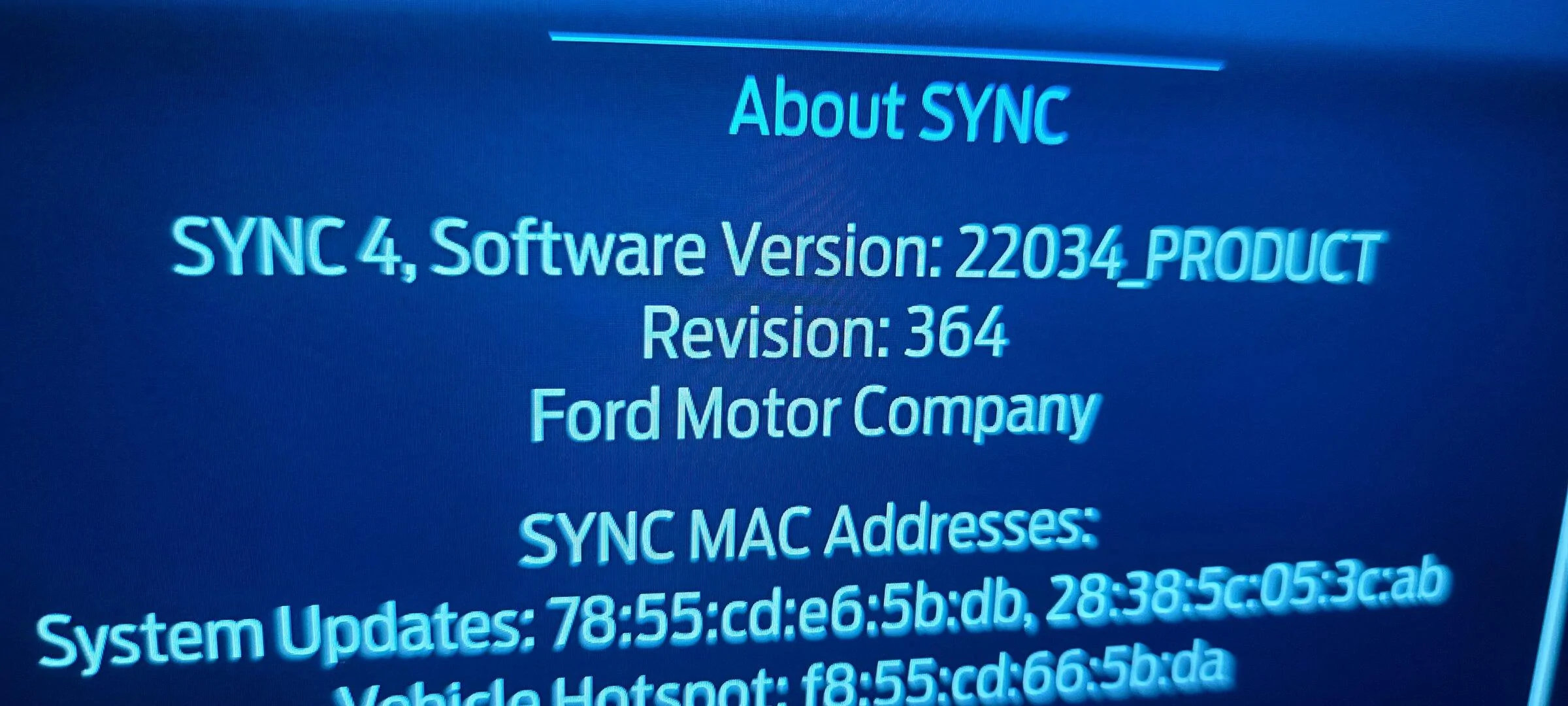

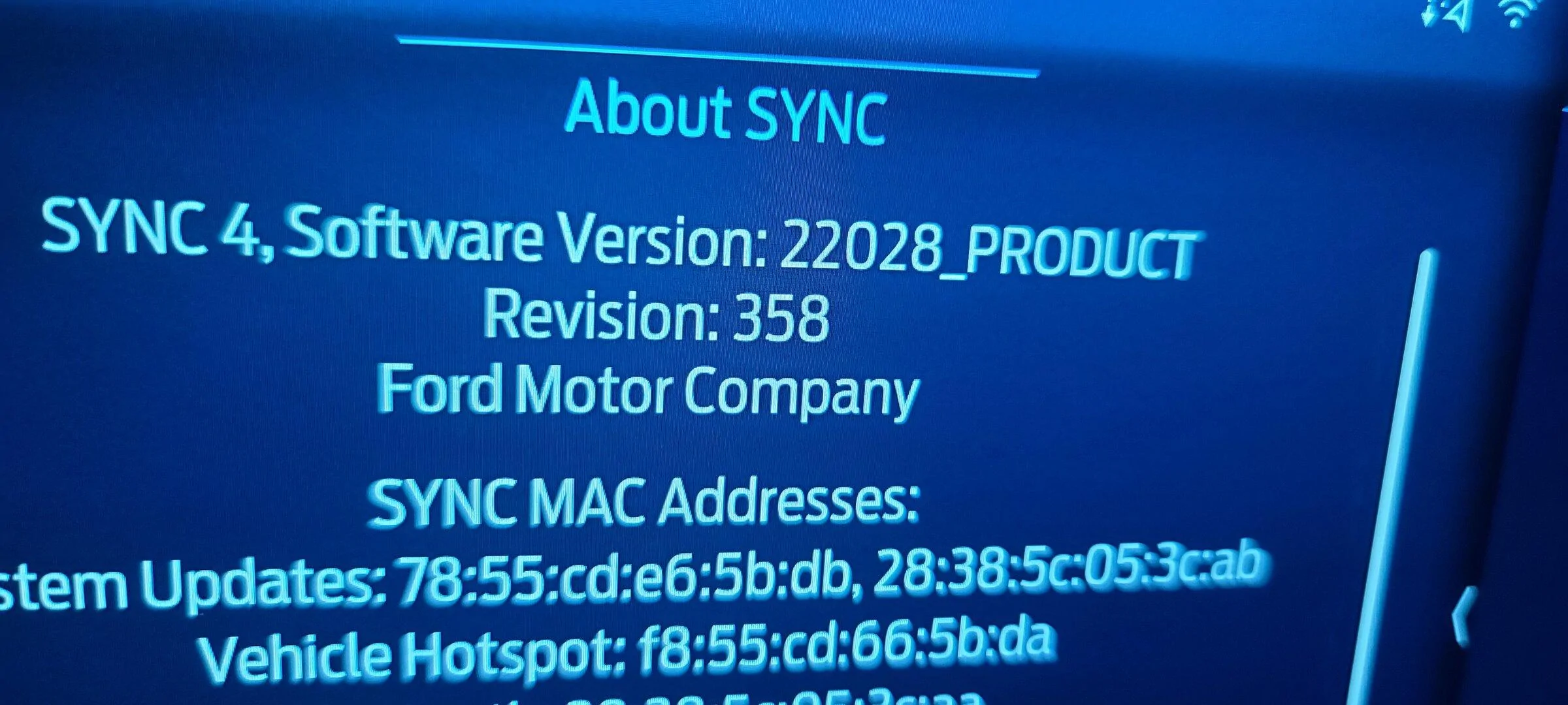

22028 was the latest offered to me as of this afternoon.
I'd be happy to keep an eye out on it for you. But you WILL be getting another APMI/GWM update.
Mine popped up after about 5 days and since I'm not Bluecruise, I didn't think I would be getting them.
Both updates went smoothly. I was 100% green. (no dtc in any module) And wallah, the fancy 2022 features were all there.

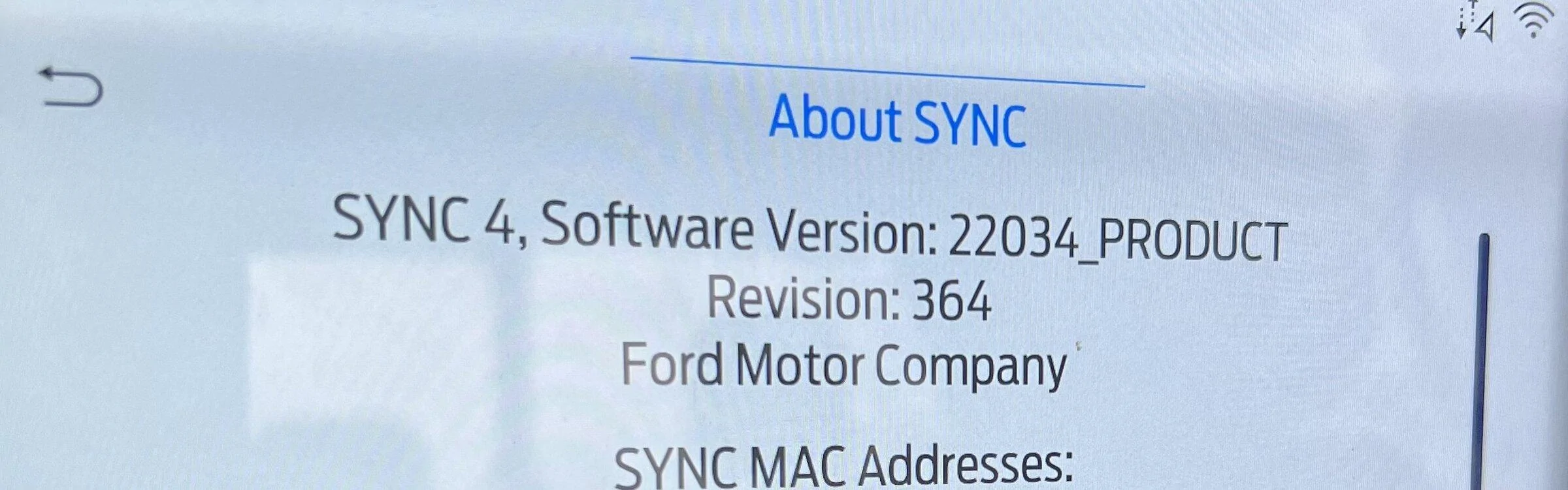

Went and checked again before my latest license expired. Just like you said, another GWM and APIM update. 22034 now and those features are now there. So that seems to be the minimum. Appreciate it fellas!

What version is does your Sync show? I don’t have BC either on my trim level. Are you on 21281 rev 244 as well?
I'm pretty sure I'm the same as those with BC.
