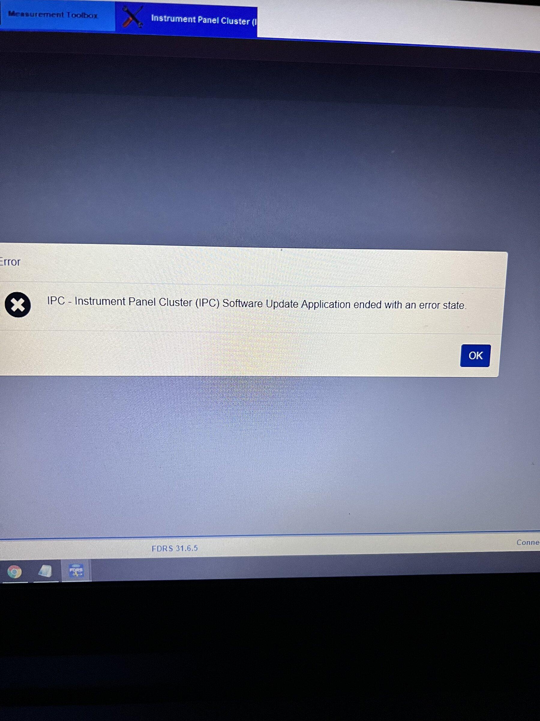

Anyone get this while updating IPC?
Ford F-150 Lightning ECU module programming guide using FDRS A2D72882-89A4-4C07-98A1-34F0EB66B726

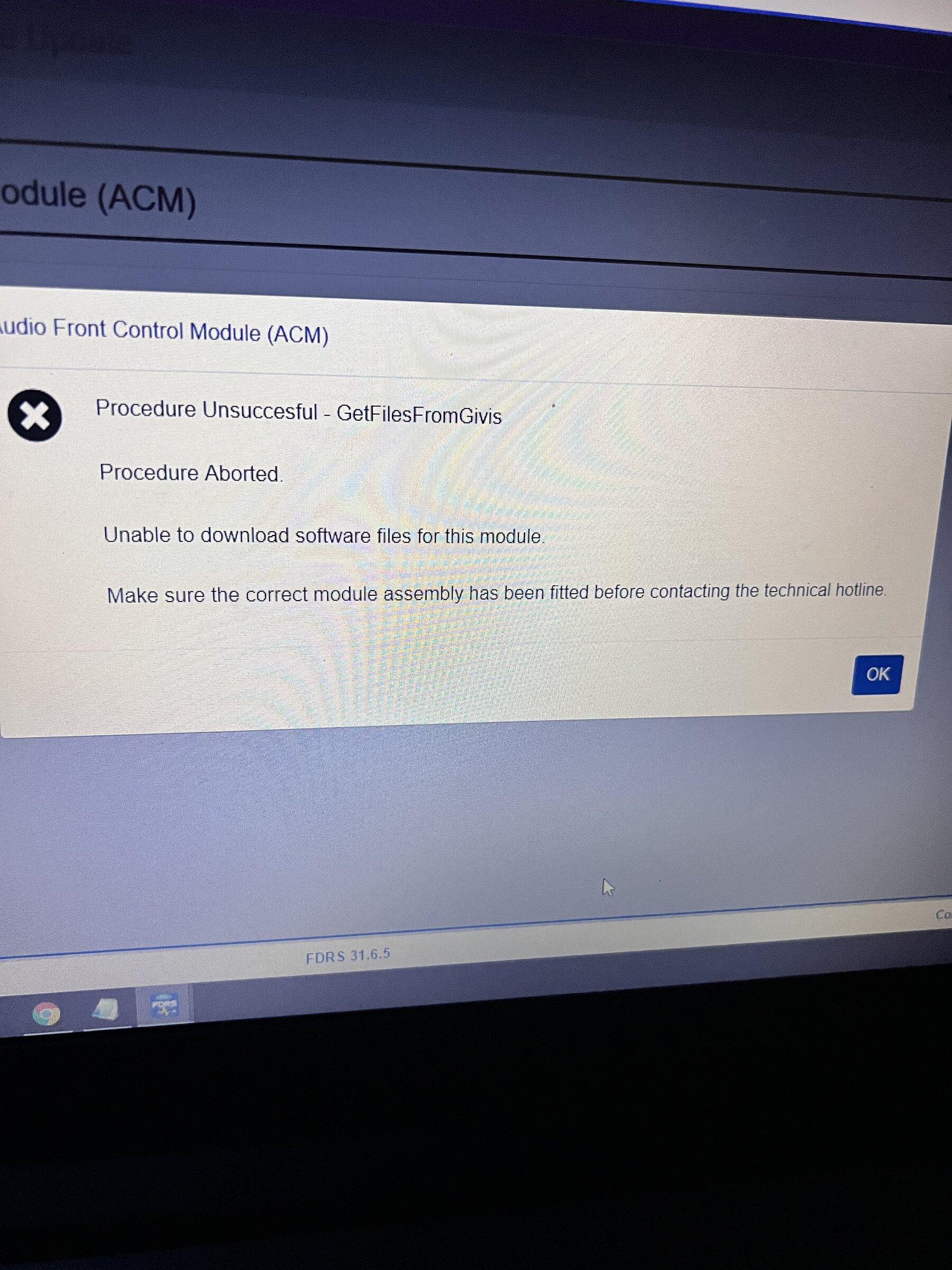

Also getting this while updating ACM
Ford F-150 Lightning ECU module programming guide using FDRS B43EC443-FA7A-4123-9BEF-C416D0BB5CD3
