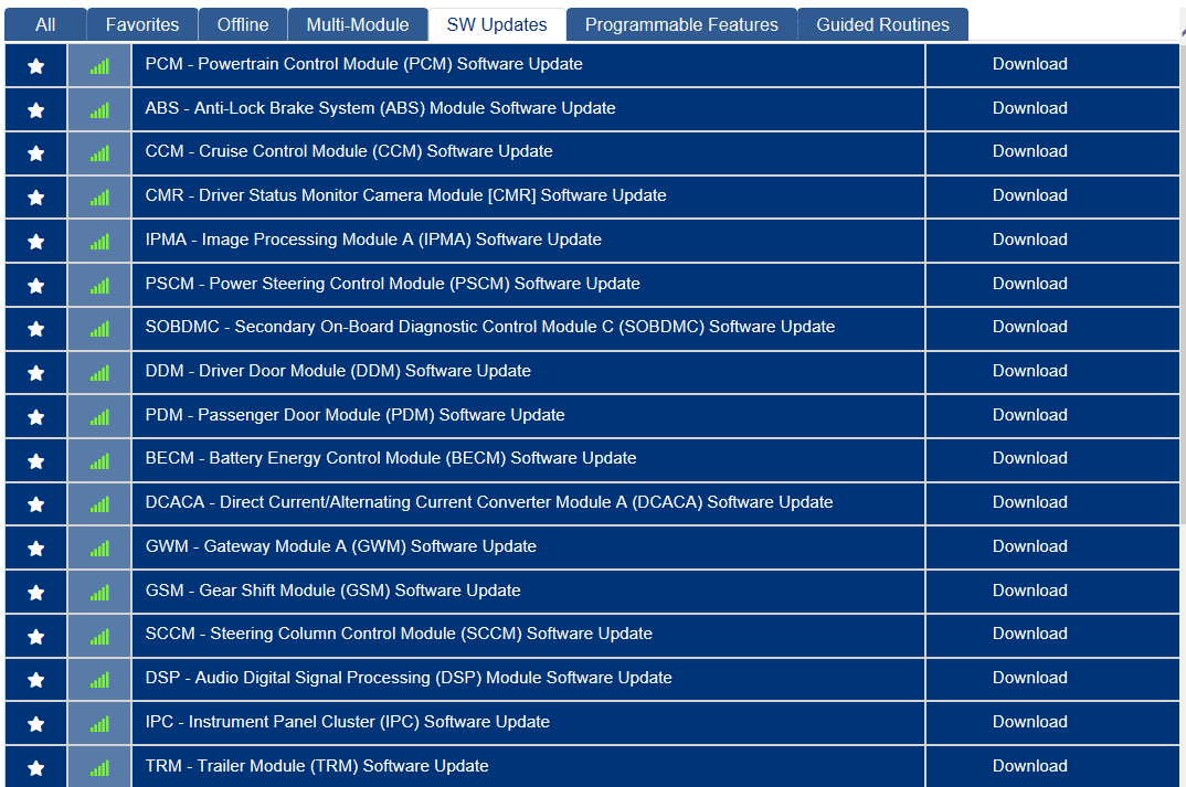

Any tips on how to get past the GWM update. I go through the update process and even the USB update says complete on my radio screen but never clears on Fords side.
@20ecoboost21
I was digging into the datalog on mine and found below. Not sure if it has anything to do with the GWM hanging but in the GWM update data log it mentions the CMR and IPMA need an update. I havenet received and updates on those modules. So it could be hanging because of that.
Number of GIVIS warnings = 3
Node address = 7C1
Warning code = 152
Source = GVMS
Details = Assembly ML3T-3G590-AJ has update available in Has-Actions ACT0037849 with coordination flag set with no applicable CAGs applying to vehicle
Node address = 761
Warning code = 157
Source = GVMS
Details = Default Service Action Id SRV0002451 not available in service action list for Vin: 1FTFW1RG1MFXXXXXX
Node address = 706
Warning code = 152
Source = GVMS
Details = Assembly ML3T-14G647-FS has update available in Has-Actions RASG0002324 with coordination flag set with no applicable CAGs applying to vehicle

ok I think you and I are in the same boat. Same model and trim levels. I think the higher trim models are getting more updates for Sync than we are.
I have a Lariat with 360 camera but no bluecruise and I’m also at 21281. I was getting regular updates before, but nothing since that one.

I dont believe the raptor will be receiving those updates. Ford stated the BC wont be available for Raptors
