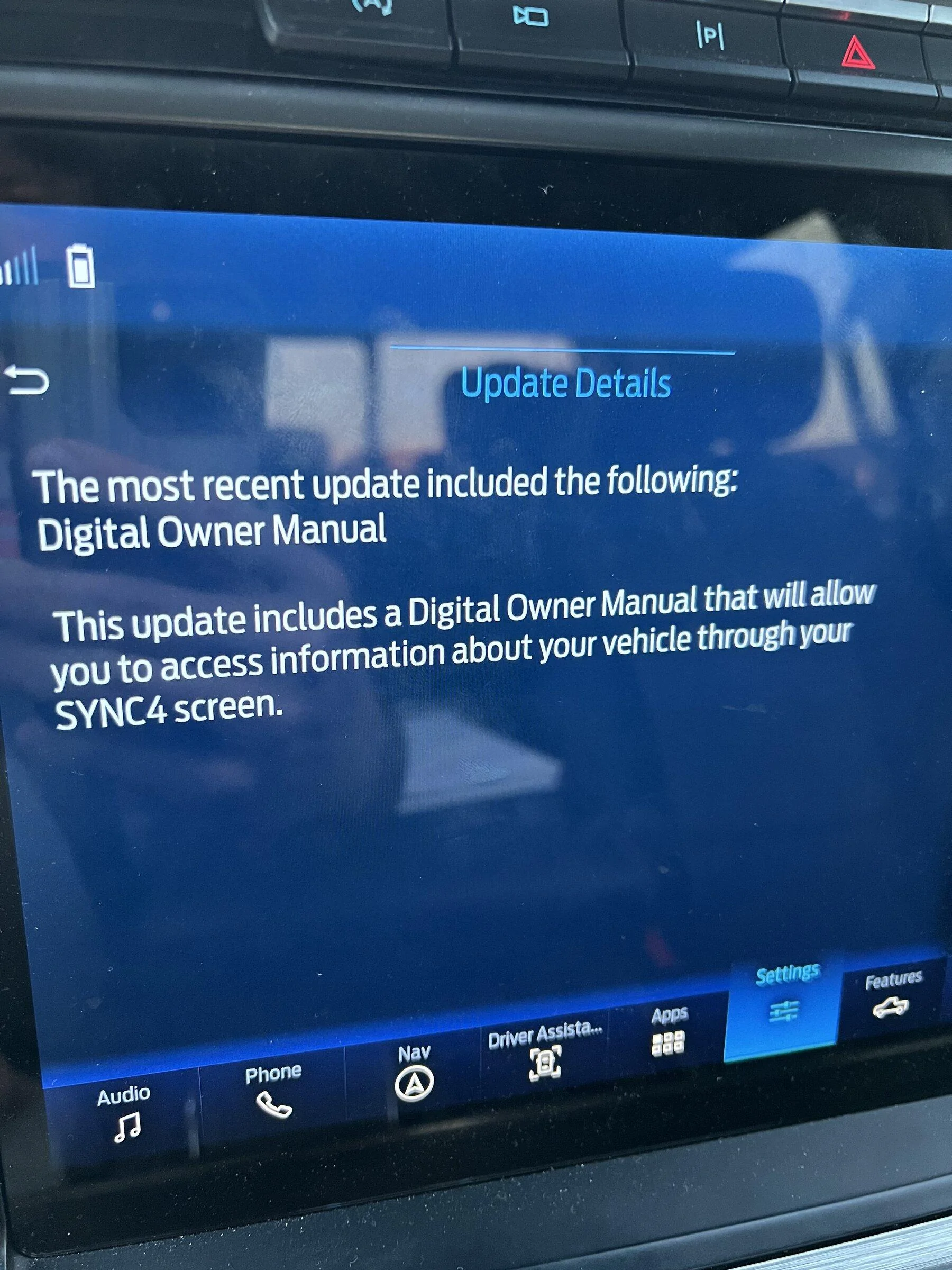

So I got an update just a few minutes ago. Extremely minor but it got pushed from the mothership. So good sign that we get OTA’s after updating via FDRS??
@tonesto7 I went in to check the OTA data in your app and it apparently didn’t like whatever Ford pushed. I’ll PM you the details.
Wow. This is really weird. I have had a digital owner’s manual under the Features tab for as long as I can remember. I think mine came with the truck. You must have missed a lot of stuff in the period you were locked down and it’s only now just getting to you. There could be more coming.
