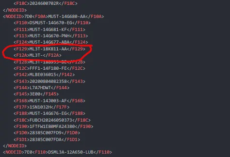

This is screwed up, I'm looking at your AsBuilt I downloaded less than 30mins ago and the part number for the APIM (7D0) is different then what you're posting! WTF?
