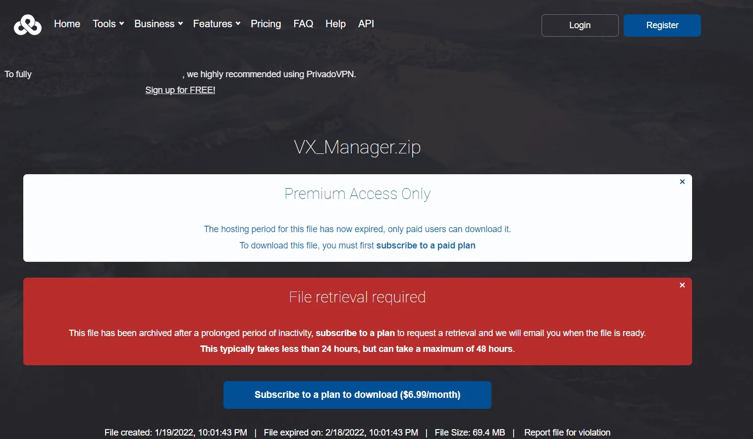

That's where I uploaded the installer originally. It offers free downloads but only for 30 days or so
I did the free registration to avoid that...

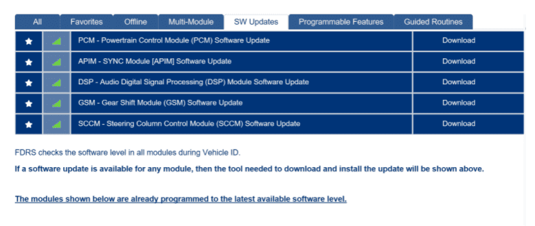

Here's my list thanks to @Bob_Mac
Ford F-150 Lightning ECU module programming guide using FDRS 1645806540938

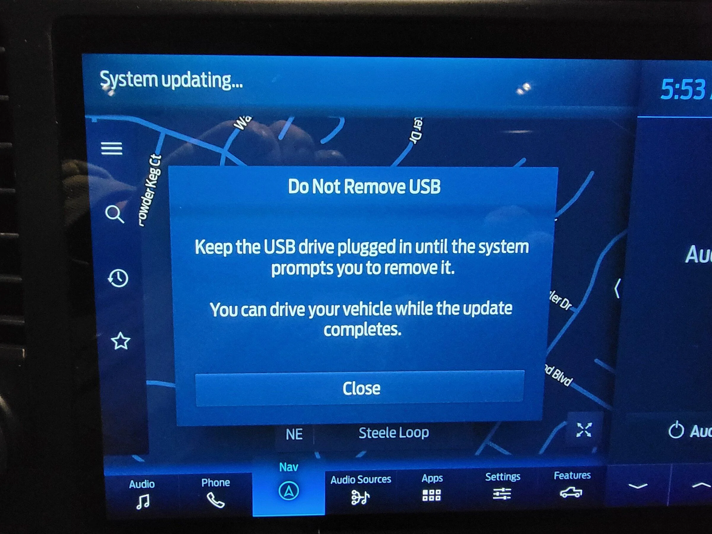

Any ideas? This one is really pissing me off.
When you're at the step in the pic, touch the "System Updating..." and see if the progress is actually updating.
