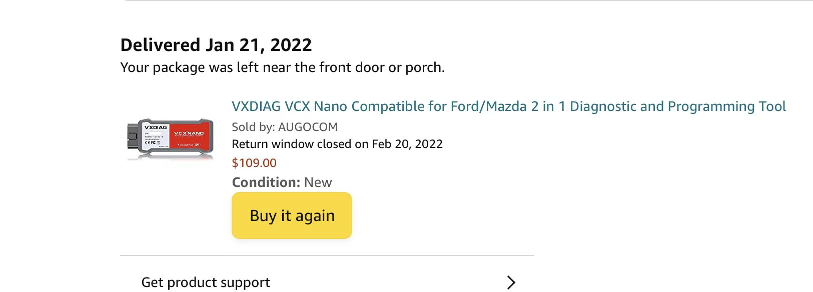

Can anyone confirm "Augocom" is the seller for the VXDIAG VCX Nano? Ships from Amazon. Hoping that's the same storefront others have purchased from.
