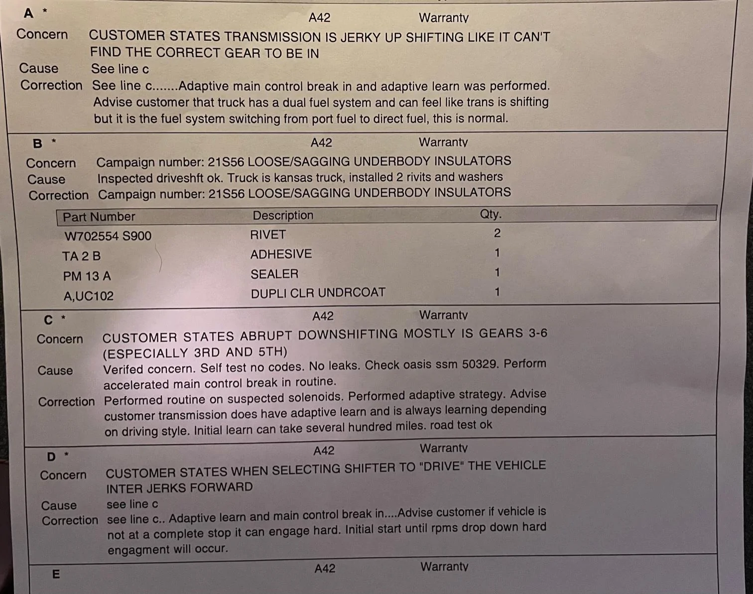

Not sure if it just coincidental, but after receiving the 2.3 update, my transmission shifting got wonky and shifts horrible now. I already completed the adaptive table reset in FDRS and also in Forscan, but still is not as smooth as it was. Downshifts to 1st and at a complete stop reminds me of the old slip bump from the driveshaft at a stop on my old 2018 f150. I have about 5100 miles now on my truck now. what are some thoughts on this?

How do I perform a reflash of the PCM/TCM software if I do not have an update for those modules? Hoping that could correct my issues I am now having with shifting?
As far as transmission goes I had issues similar to yours and the dealer did a Transmission valve body main control break in procedure and it helped a lot.

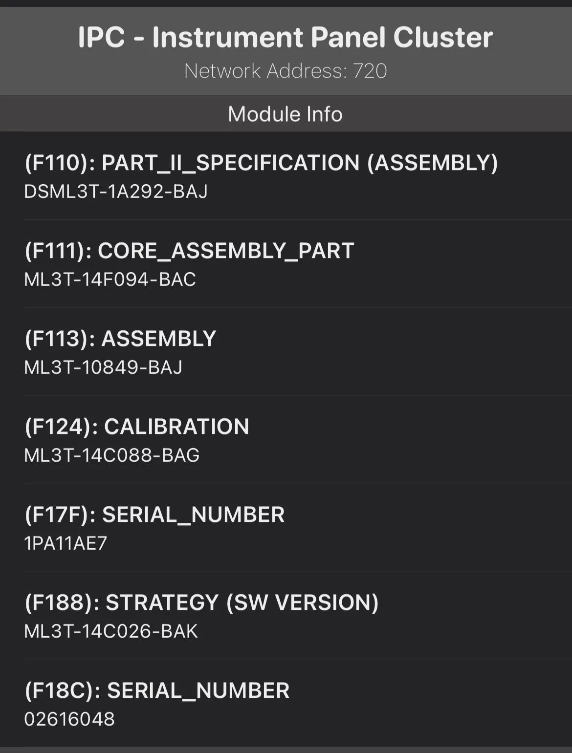

Ford F-150 Lightning ECU module programming guide using FDRS IMG_3702
I had the same situation on my XLT (302a 5.0L Feb 2021 build 8" cluster) as well. About a 6 hour IPC update with no USB option.
This is what I show now..
