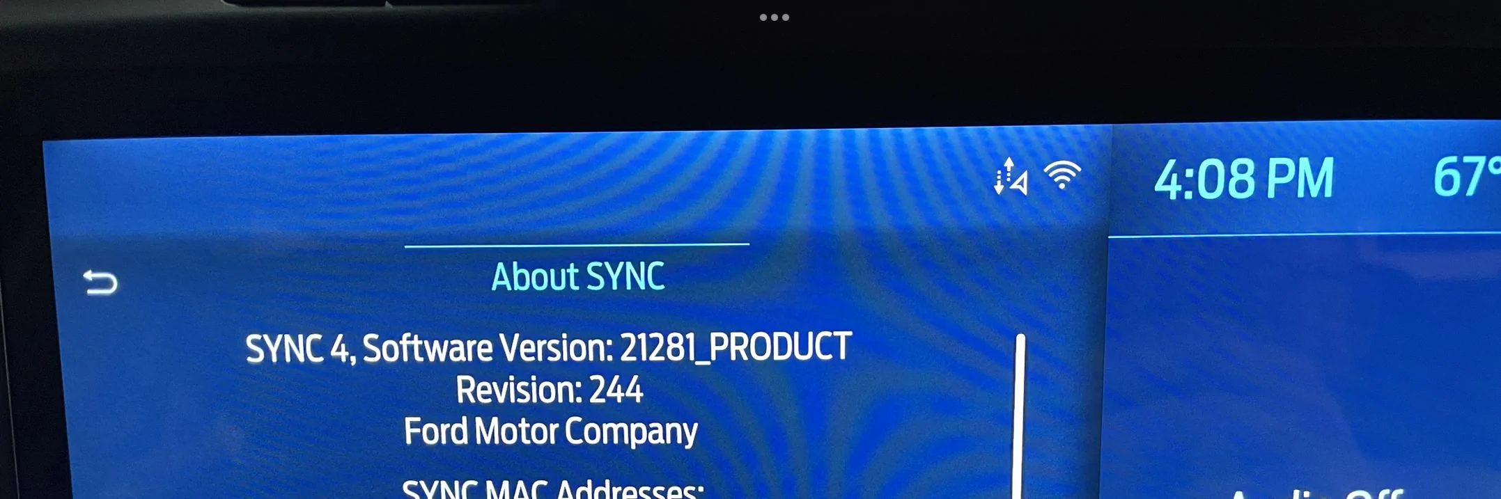

@Bob_Mac YOU SIR ROCK!
Start to finish 20min with the SS USB
