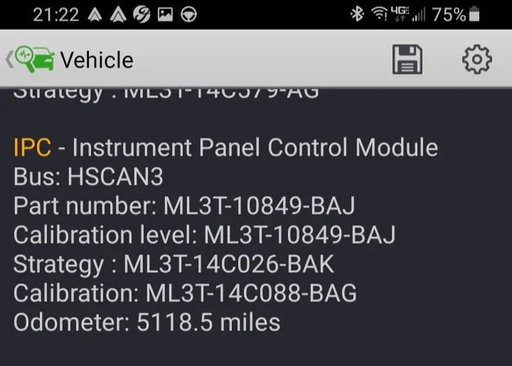

What is your F188 Strategy version at after the IPC update?
I was able to get the strategy using Forscan lite.
That is the strategy for an 8” cluster, I think. Here is the strategy using FORScan Lite, for a 12” cluster and reflecting the most recent IPC update:
IPC - Instrument Panel Control Module
Bus: HSCAN3
Part number: ML3T-10849-CCM
Calibration level: ML3T-10849-CCM
Strategy : MU5T-10F906-FCA
Odometer: 12409.5 km
Note the fairly radical change in the software format Ford is now using. It’s causing a lot of confusion and disruption. It even threw off the FORScan Team, which initially thought it was a glitch.
Bus: HSCAN3

@JEB, you are correct, as that is for an 8" cluster. I have an XLT 302 High package.
Got it. In addition, I think the strategy for the most recent IPC update for the 8” is ML3T-14C026-CTF. The second calibration (at node F124) is deleted. Which might be the problem. It is unclear whether there should be a second calibration file at F124 or not after the update. There wasn’t for me or @Bob_Mac, if I’m reading his screenshot above correctly.
