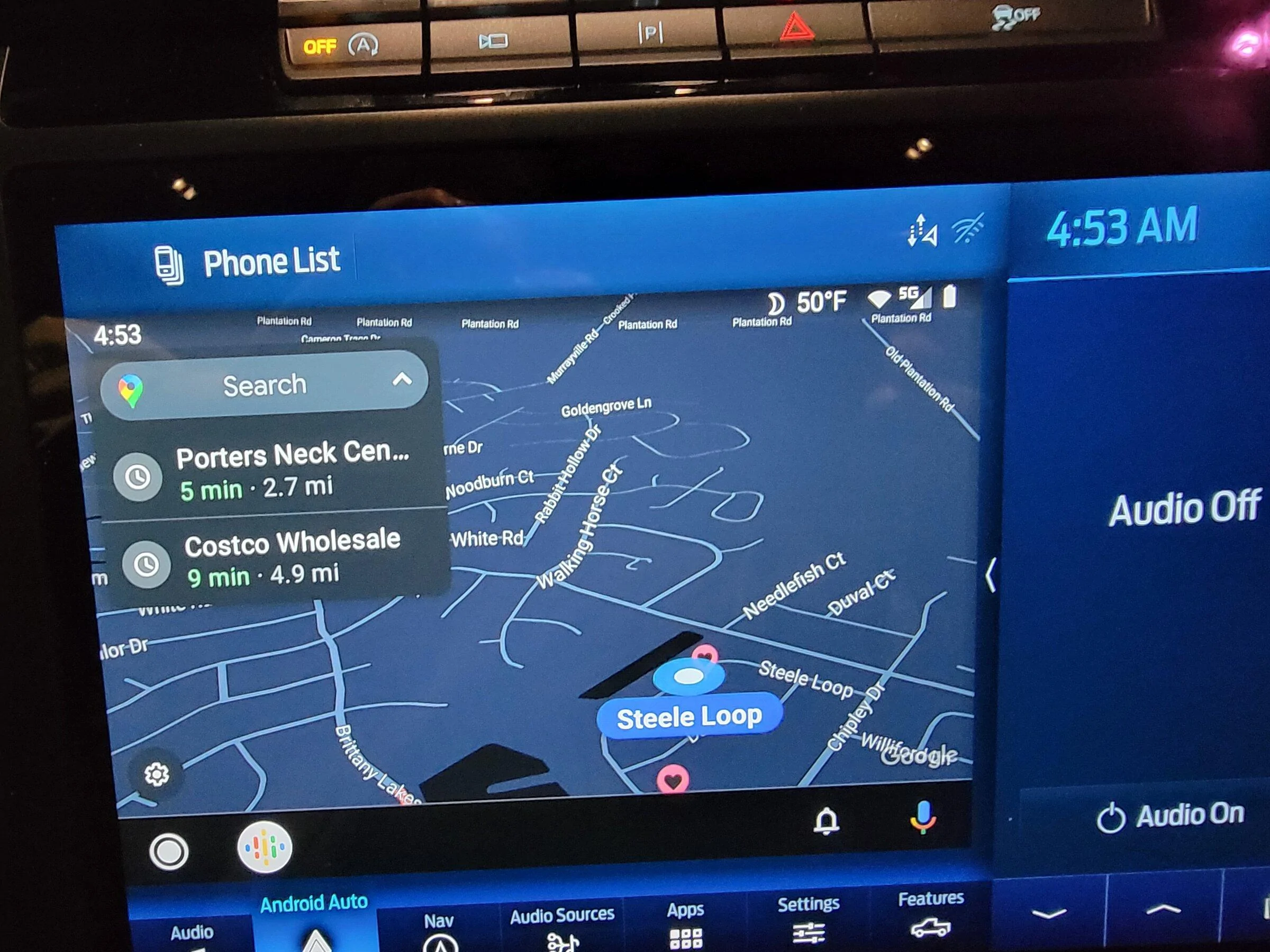

Any noticeable changes in Sync ? Did they fix the ACC SSR ? How is CarPlay screen look like ? I had a full list of bugs reported to them.
Ok, there are changes but, unfortunately the ACC SSR is still the same. No border around the Android Auto and phone details and weather are in the upper right corner of Google Maps.
Ford F-150 Lightning ECU module programming guide using FDRS 20220303_045335

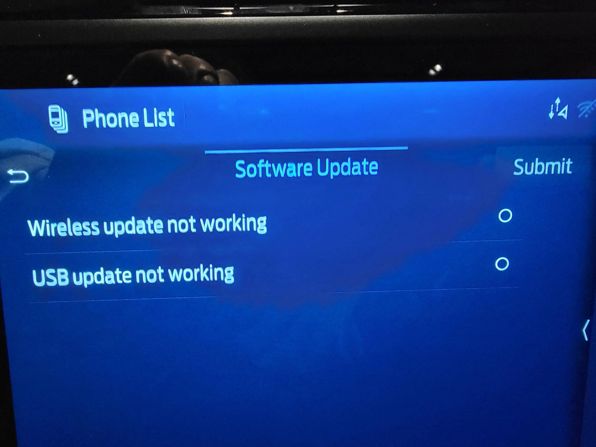

@iceman77 just noticed something, ACC doesn't stick after a restart it's disabled. Also, the Send Feedback for Updates has now changed as seen below.
Ford F-150 Lightning ECU module programming guide using FDRS 20220303_045842

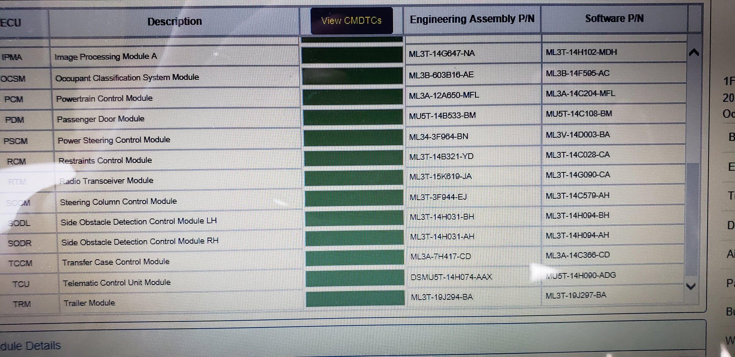

TRM update in FDRS. I performed the update and now my CMDTC is clear. Took about 5 minutes for the complete process.
Ford F-150 Lightning ECU module programming guide using FDRS 20220303_133625
