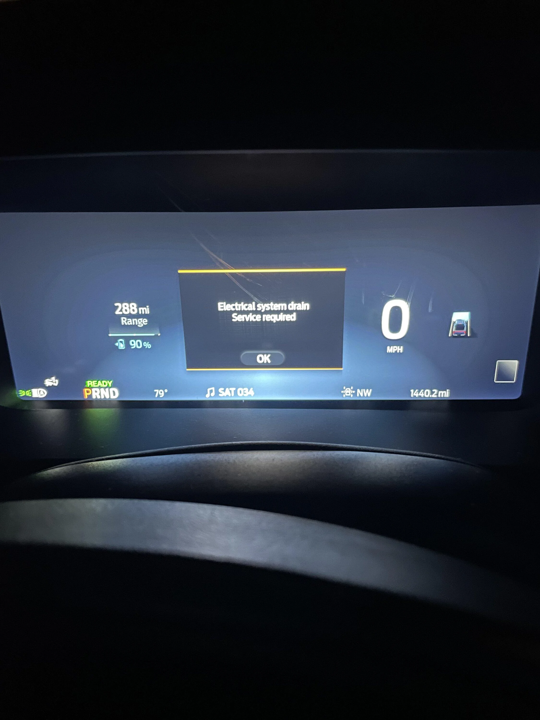

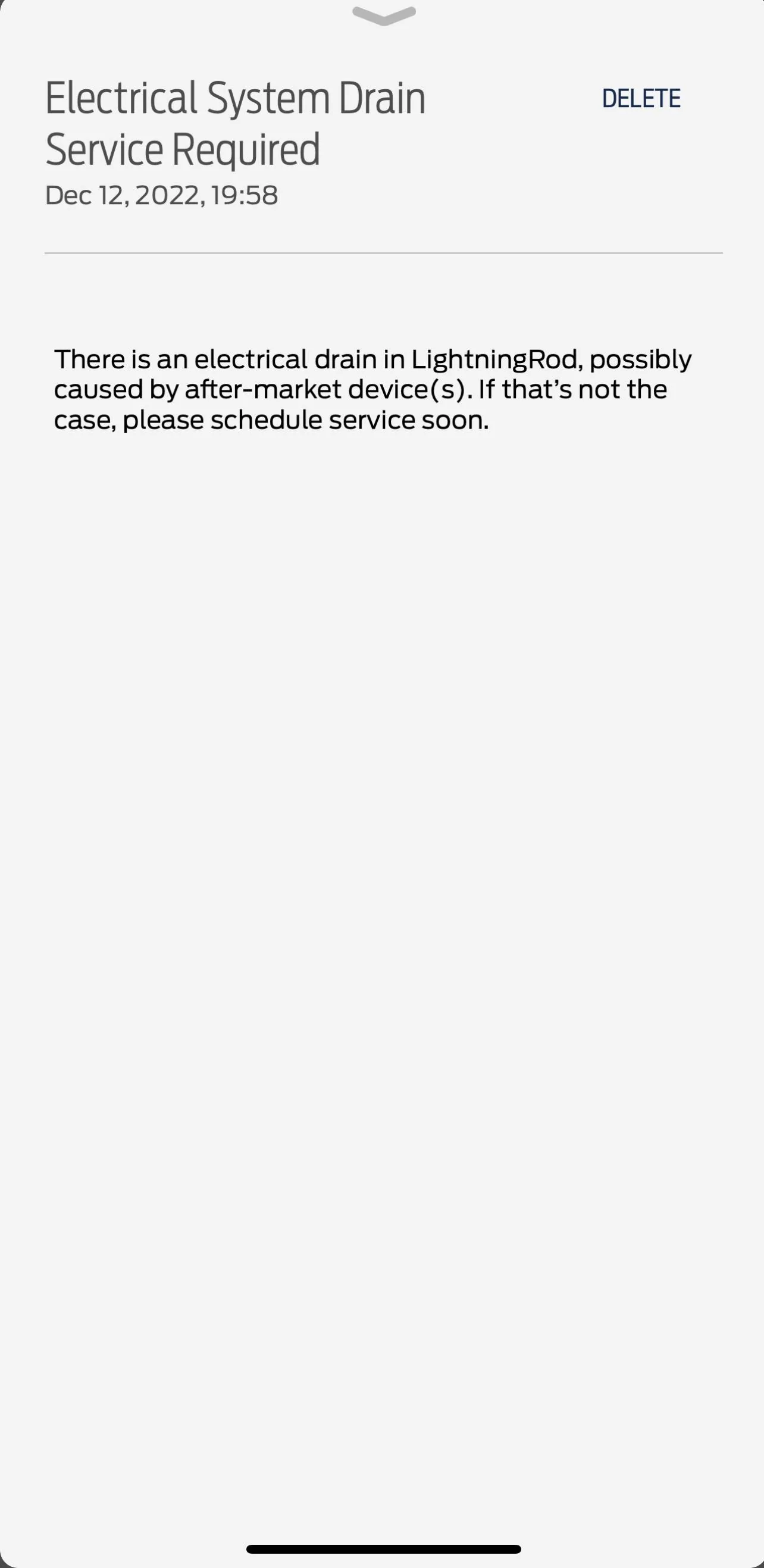

"Electrical System Drain - Service Requested" error message

Most people with Mach-Es who reported this problem have found one of two causes. Accessories installed (such as a dash cam or ODB-2 dongle) that drain the battery. Or allowing a utility or other 3rd party to access the vehicle’s data. Constant pinging of the modem causing battery drain.
If those don’t apply to you, probably time for a visit to the dealer.

and it's probably referring to the 12v battery, not the truck's battery pack...
Yes, sounds correct.
Common to have that little 35AH AGM battery go flat in no time.
OP: Open the frunk, remove the battery cover and connect a battery charger to charge it up then see.

I have been able to replicate it multiple times. Happens everytime my EVSE is plugged into the car but not actually charging (scheduled to charge during off peak). However it doesn’t happen as long as the truck hit the charge limit I set it to.
A la, it errors out if you plug in and doesn’t charge for a long time(2-3+ hours) but is not affected if the charge limit is hit or fully charged.

Never resolved. Happen to me twice but I did noticed that it happen with these conditions:
Cold outside, below 40 degrees
Battery was less than 40%
Truck was plugged into the FCSP 2-3 hours waiting to charge during set hours
