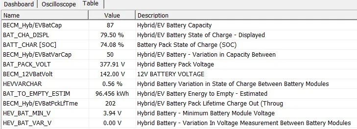

Don't want to hijack the thread but exploring the same issues with my 2022 Lariat ER with 80078 mi. I came back from a 10 day vacation and my newer 12V was dead. Revived it and noticed a low range reading (144 mi) at 80% SOC. I thought bad module of the 9 mods and actually good if happening before 100k mi.
I ran live data in Forscan and all appears well. Not sure what the 50 value is in Variation in capacity Between vs. the variation between pack SOC showing 0.56%. I attached the BECM tests I ran and not sure if I'm missing anything. No DTCs present. Any thoughts are appreciated.

Double check for a trailer profile being active, if none is active load a default trailer, then reselect no trailer attached, just curious that this is not the reason for the low range value at 80% SOC

Good call. That was it. I towed a day prior to leaving and I know from experience that you have to go in a shut off the active trailer. I definitely did that prior to the battery dying over the 10 days I was out of town.
Interestingly, it was back on my PWC trailer config I last towed. It obviously reset to that last trailer after I jump packed and then charged the 12V. Not sure why I didn't look as I've had the trailer setting not always go back to No Active Trailer.
