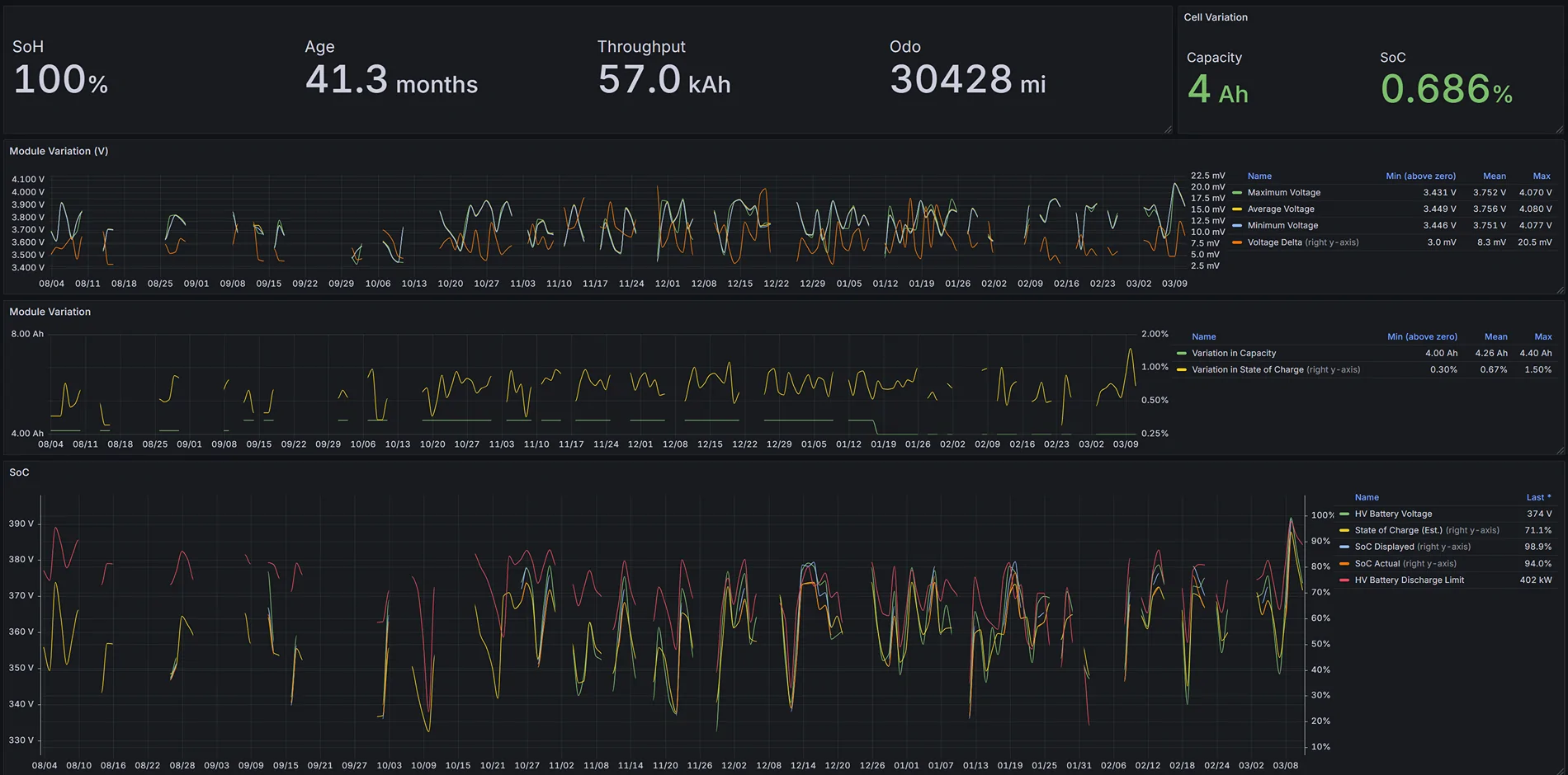

I routinely see up to 4% variation, charging to 90% every night. Then as soon as I charge to 100%, variation goes to < 0.2%.
And for me it's the complete opposite.
My variation (yellow line, middle chart) is consistently between 0.5% and 0.8% and in the rare occasion I do see a higher number it's after having charged to 100% which I do a few times per year.
I do not charge every day, more like every 3-4 days and usually charge to 80%.

For me and many others, once a cell goes bad, the ability to balance by charging to 100% becomes moot.
On my first bad module, Ford software would stop charging at ~65% and throw the red ring of death. Could not get to 100.
This time around, charging slows at 80%, then charging current completely stops around 83%. Display shows 100% but falls to 83% on starting.
I do believe with healthy cells that it will charge to 99-100 and continue to pull charging current to balance. But it won’t do that when a cell goes bad.
My deviation has always been under 0.6% except when a module goes bad which happens suddenly, see chart in post 1.
