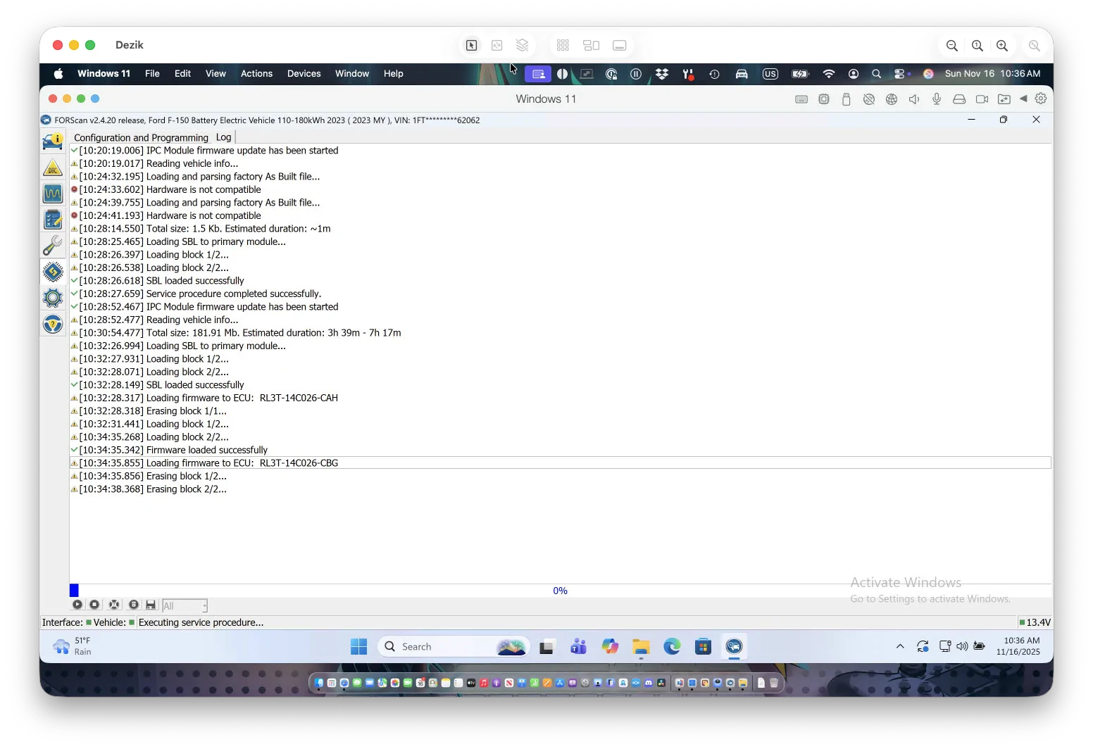

Ye Gods I've not been this nervous since I went for my U.S. Citizenship Interview.
:cwl: now the waiting begins. Block 5/5 on the last one takes a while. Don't freak out if it throws a bunch of DTCs after flashing the IPC and before you restore the 24 back up

So far, so good. Planning on making a video about it after, when it's not raining and my actual camera person is around to help. Also, no point making a video where I **** it up ;)
Super-impressed how Forscan is doing this though :)

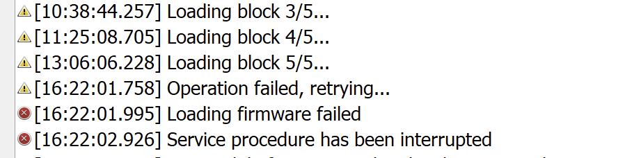

SPOKE TOO SOON!
So, the jump cables I had failed at 94%. They started to heat right where the cable meets the clamp - and looking, it looks as if there was some rust/corrosion at that point (never checked, they've been looked after for 20+ years)
The firmware update failed and I have a blank IPC. Hopefully I can flash again with new cables. Hopefully, I haven't bricked anything. The battery is fine, and the truck turns on.
@Jesse-Infotainment Not panicking yet ;)
TLDR: Do not use old jump cables, even if they're capable of the current.
Also @Jesse-Infotainment can I confirm it's best to leave it overnight and try again in the morning when it's clear?

SPOKE TOO SOON!
So close. I always get antsy that the power supply is going to fail so I kept going out and checking the current from the charger with a clamp meter every 20min or so to make sure everything was happy. Had a 12v deep cycle battery and ICE truck on standby. This and FDRS updates will certainly test your equipment.

No you can restart it.. Dont panic..
Jesse-Infotainment
Jesse
May 27, 2021
1,030
1,308
Dallas
2024 F150 Lightning Platinum
All you need to do is load hte 120 location and let it run.. PLEASE DOTN PANIC>. It snot bricked or bad..
Jesse-Infotainment
Jesse
May 27, 2021
1,030
1,308
Dallas
So in this instance she only needs to redo the last one and not the whole process?
Correct..
You can always load individual files as needed.. It isnt a requirement to load all files all the time.
